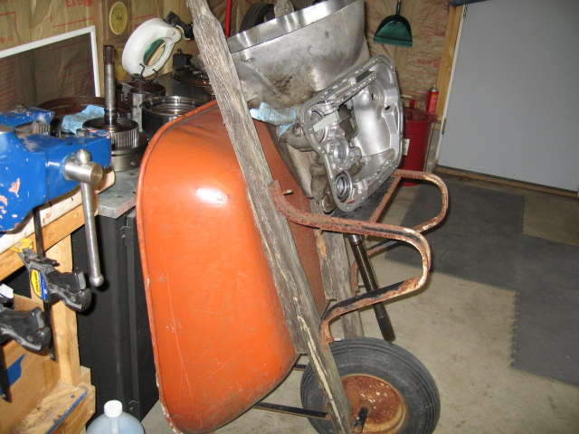

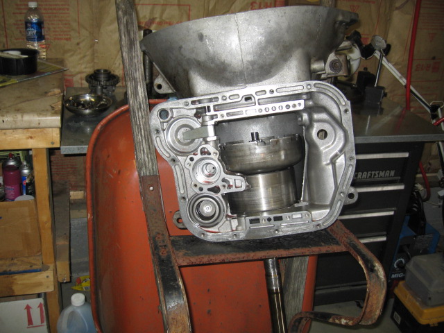

    Make a stand to hold a transmission vertical for ***embly by turning a wheelbarrow on its nose, then set the trans case in between the handles.
