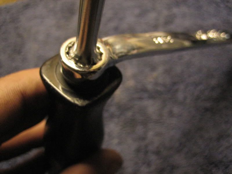

    Old(?) Craftsman screwdrivers have handles that have a pattern kind of like a big co**** spline.
    http://nwwone.org/world-war/worldwa...lips-slotted-screwdriver-set_280648760083.jpg
    Usually a 12 pt box wrench will slide on, so the wrench can be used to apply maximum torquage.

    Even the newer ones can be turned by the handle with a crescent wrench, I just did it this weekend. I'd guess if you torque on it too hard it'd spin or break the handle though ... but I also think the blade would slip on the screw first. Worth a try if you're in a bind anyway.
