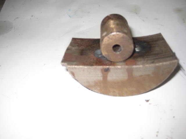

    Put C notches in full boxed frames. Weld a round piece of shaft to center your hole saw. then drill thru one side, then drill from other side. Finish up the cross cuts with hacksaw etc.

  29. Dan Timberlake
    Joined: Apr 28, 2010
    Posts: 1,578
    Dan Timberlake
    Hi Art - Could you explain that process?
    thanks
    Dan T
