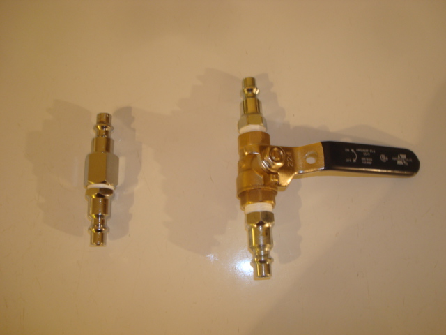

    you guys probably all have one of these. they are used to fill a pig (portable air tank) from your big compressor without having to hold an air chuck on the schrader valve on the pig. you just plug the female ends of the compressor hose and the pig together and allow the pig to fill.
    a friend showed me his many years ago and i made the one on the left right away. then i showed it to another friend later on to which he responded "yeah, when i made mine i put a valve in it so you don't lose air when you disconnect." so i made the one on the right.
    i don't use the pig around the shop 'cause i've got the compressor right there. BUT, i've done a lot of remodeling for sweetie over the years and am constantly bringing in a pig to run air nailers in the house. i have two pigs and i just set the compressor regulator on 125 psi (the max pressure in both pigs) and when i take an empty to the shop i just switch it out with the now full one and leave the empty one to fill automatically while i go back into the house to keep working. my compressosr comes on at 125 and turns off at 175 so there's always 125 psi in the compressor tank.
    and of course there's a million reasons to take a pig with you when you leave home (boneyard trips, help a friend, etc.).

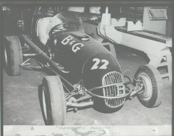

    My mentor was one of the most savvy midget race car owners of his time.
    He quite possibly owned the fastest midget in the country in the late 50's.
