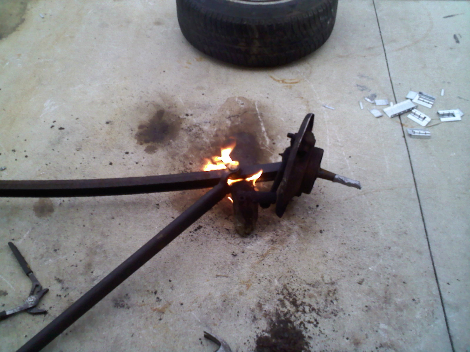

    Adjusting sagging car doors to fit better, wihtout doing damage, using a 2X4.
    Thanks Henry Bond.

    And how to use pop rivets very effectively with stop signs. Thanks Big Willy McNabb.RIP
  24. atch
    Joined: Sep 3, 2002
    Posts: 6,403
    atch
    i've seen a Ford repair manual from way back (30's or 40's) that illustrates how to do this. seems quirky, but it works.

    Lil' fire and candle wax!!!!
    Mark
