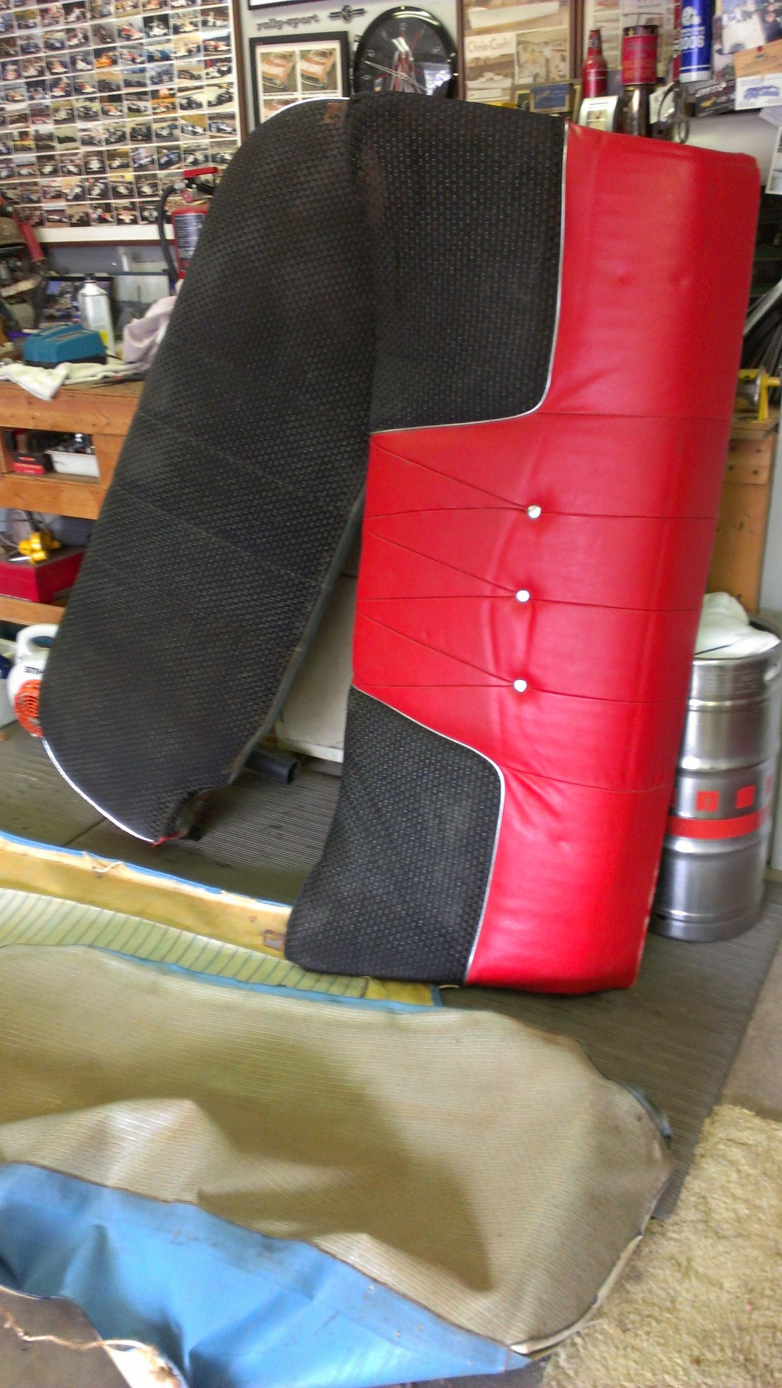

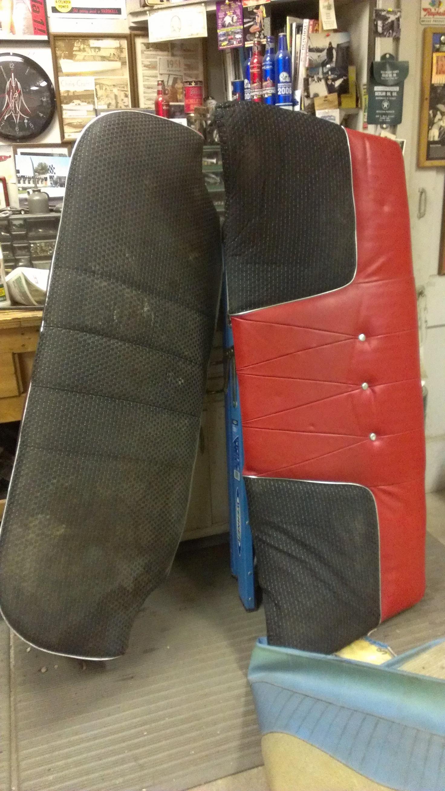

    I just pulled out the back seat from my 56 Oldsmobile & removed the old seat covers that had been on them for decades to find the most amazing original seats.
    The one picture where it looks pretty good is when I had just wiped them down with a damp terry cloth rag. As you can see when they dried they are still in need of a deep cleaning. I'm afraid to go to aggressive with scrubbing or cleansers in fear of damaging the material.
    If anyone has a suggestion on the best way to clean these please let me know. The vinyl is easy.
    I need help with the cloth part.

    One way would be to take them to a good detail shop that uses an extractor, which is a hot water vacuum, simillar to Stanley Steamer on carpet. I have one in my shop and it works great. Does'nt hurt the fabric, providing it's in good shape.

    I have had luck with LOW pressure dry compressed air. Them a good vacuum. With old material it can be very brittle from age so don't get too aggressive.

    The damp Terry cloth probably rubbed the dirt in deeper. You need something that will seep in, clean and lift the dirt, so you can vacuum it up.

    You're absolutely right on that. After it dried I realized that I didn't do myself any favors on that. That's why I'm asking before I do the front seats.

    Thanks for all the advice. The material seems to be in very good shape so I'm sure it can handle a small amount of scrubbing. I think I will start with the dry approach first and get what I can then I'll go rent a carpet cleaner with the upholstery attachment.
