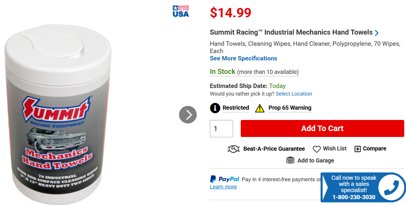

  29. Bandit Billy
    Joined: Sep 16, 2014
    Posts: 16,069
    Bandit Billy
    I buy these every time I check out at summit. One abrasive side, one smooth. It will take automotive paint and clear off your skin without killing you. I use them to clean my tools after a messy job, and I use them to clean my spark plug leads (they don't remove the lettering like thinner will. I recently used them to clean my car remote fobs which they did without removing the icons. I have one in my truck, one in my trailer and a couple in the shop. Smell like oranges.
    deathrowdave, brigrat and alanp561 like this.
