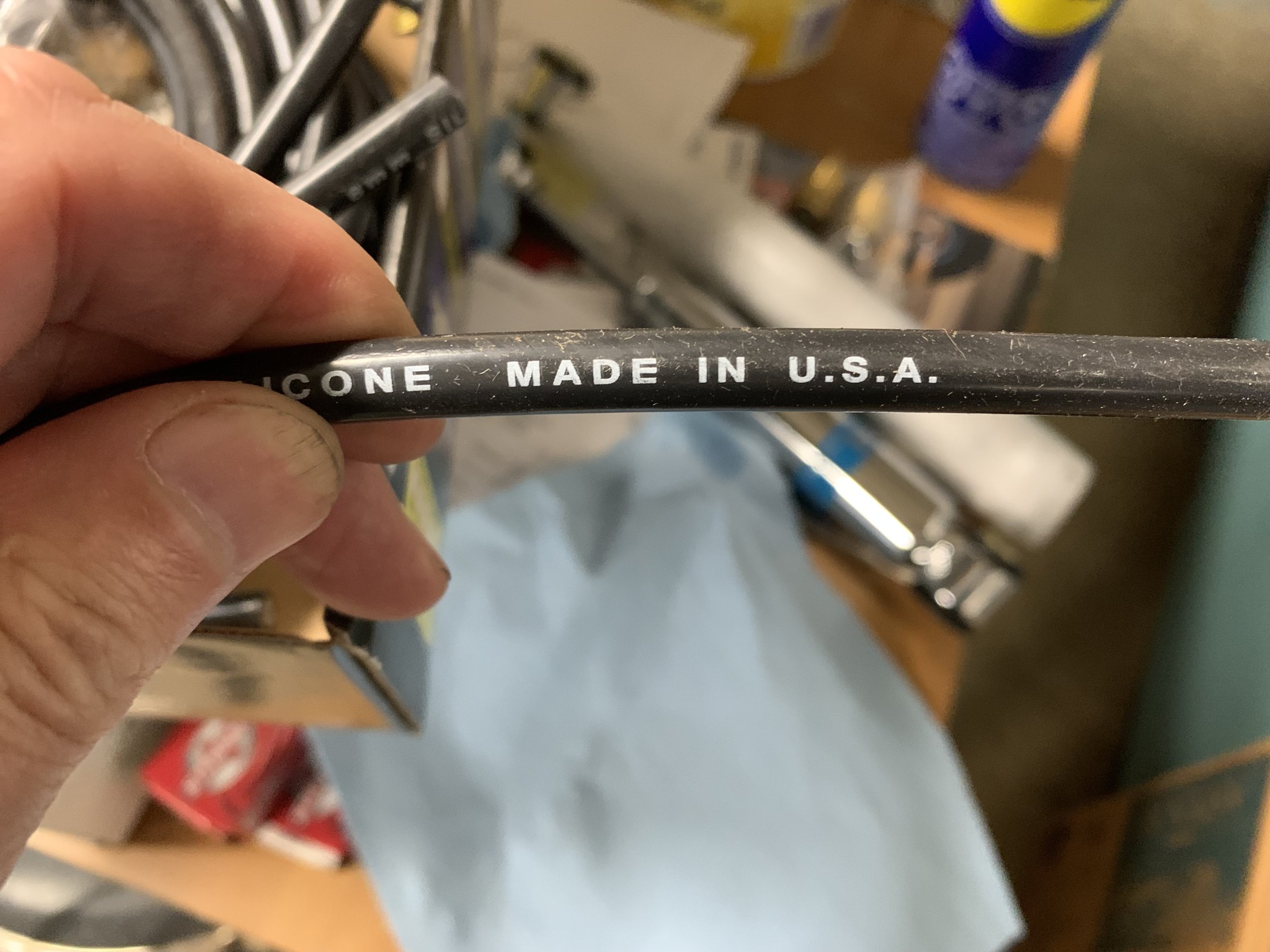

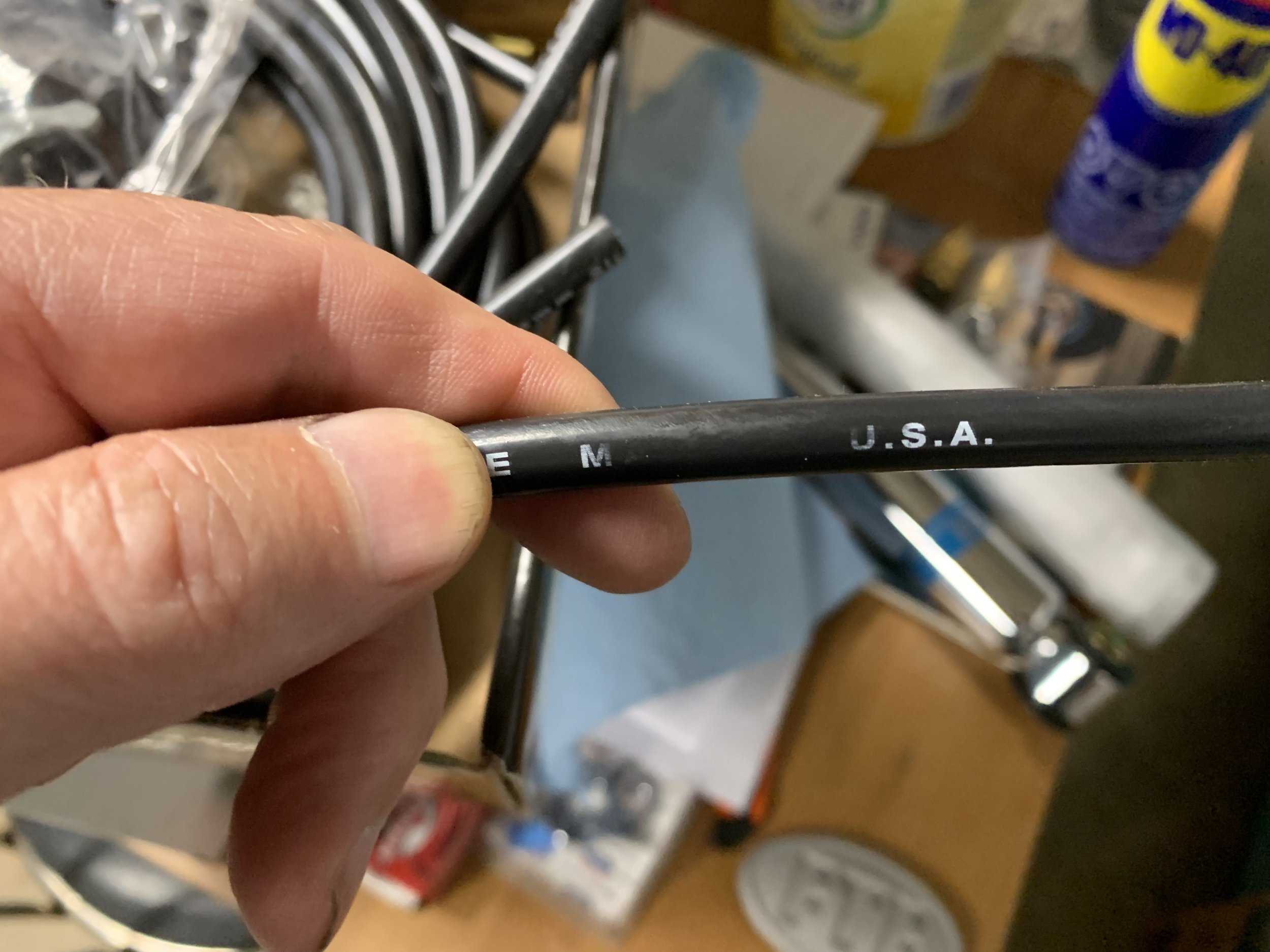

    Had to go check to see if my memory is slipping.
    Used Taylor wires cause, well you know.
    Still works.
    Note: new Taylor 8mm kit so only rubbed a little off.
