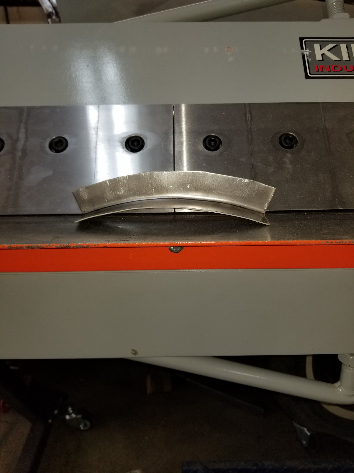

    Take a piece of steel 2-3" wide, (or wider if needed) bend a 90 along it's length then use a stretcher along the top edge to get the curve you need.

  3. K13
    Joined: May 29, 2006
    Posts: 9,722
    K13
    fauj likes this.

    Thought about that, wonder if the radius will be too tight, it would work, but it’s such a soft transition between the two.
    Not that I need it to look super factory, but would be nice if you couldn’t tell it was patched.

    If I was to brake it over a piece of tubing to get the same inner radius, could I still do the same thing? Just stretch the top?
