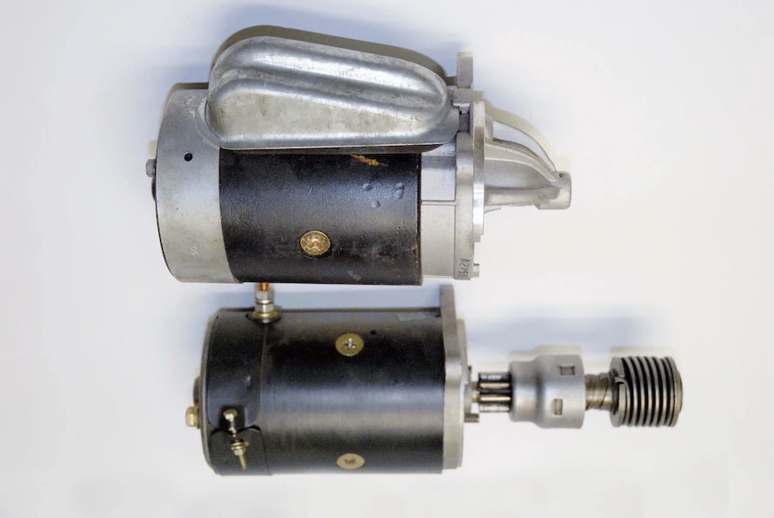

    So after arguing with the starter in the 352 to get it out (big Bendix type) I looked in the Motors Manual for any direction. Turns out they spec dropping the steering arms, I did that, it came out. After the fed govt science project it took to get a new starter I gleefully installed the big ol Bendix and dove under to install. I'm into my next dozen WHAT IN ALL THE ****S of trying to get it in that magic spot, which seems all but impossible. Crossmember is in the way, manifold (not the pipe) is in the way, frame is in the way. I'm missing something and hope the FE faithful have a tip to share. Keep cussing it out or is there a preferred position to start from. As always thanks in advance.

  7. Compare the two. Is the shaft the same length? Also is the bendix in the same position or is it wound up? If memory serves the bendix has to be all the way extended to sneak past the flywheel. It's been a few years since I've had the starter off any of my '63s so I hope I'm leading you in the right direction.

    Check the drive housing over , compare the old to the new . I’ve gotten a couple for 390 FE that the opening for the drive gear isn’t deep enough and the flywheel drags on it .

    I'm going to try this. *** all the way up. With the steering out of the way, I might be able to get a more favorable entry angle. Starters are the same BTW. Drive is like new.

    Yes, I have the bottom one. I'm not buying anything extra or special, the car is for sale, I'd like it to stay as is.

    Www.summitracing.com and a mini starter was here two days later.
    Issue solved;)
    I realize the OP doesn’t want to go that route, but I can’t fight much anymore, especially iron.

    Ok, Rock auto has the starter needed, for $107+ tax and shipping. It's almost 20lbs, so shipping would be substantial and dependent upon who has it. I'd seen the Motor Trend get the drive and kiss your troubles bye-bye story, and tried to simply get the right starter vs a drive, a different FE starter, et al. My local Orielly folks are awesome we sorted thru the usual abbreviated product info over the phone and settled on what appeared to be a late 64 starter. BZZZZT! thanks for playing. What came in was what I had already. It only took 2hrs to get vs 2 days, so there's that. And 60 bucks:). Screw it Jocko you're selling the car, put it back in. But wait, there's more. If you act now you'll find there are 2 shaft lengths. 1 a ½" shorter than needed, so now the drive won't fit the new one. You getting all this? The proper one was available, $2 less, but next morning. Got it, happy, drive went on easy enuff, and now "No way Jocko, you know that no good deed goes unpunished." and the resultant struggle of WTFs with a 20lb starter over my fkn tired old head. So what would you do, spend $58 and have it immediately (damn near) or nearly twice that in hopes of a mod to save future efforts? Would it be the #1 selling point that I upgraded the starter in a car that may end up with a 390 or 428 in it anyways some day down the road? I restore for a living so...(?).
    So anyways, my beloved HAMB brethren, that's how I ended up here asking a collective of shop pals if there's a secret handshake to stick this long bastid back in. Thanks, enjoy the show.

    is there a trick about moving the bendix in or out before you install the starter?

    It's kinda fixed in place. I'm not even totally sure how it works looking at it, and it has this overrun ratchet deal incorporated into it. There's springs inside the cup deal that holds the gear, and the moment you just look at it fast enuff it goes back to rest. As noted above there's 1 sweet spot in the opening for the drive to sneak past the flywheel. Later I'll post the "discovery" of how I got it out.

    Oh, it's a complicated mechanism. There's a catch of some type, and that nasty spring, and I forget how it works. ****s getting old. I played with one on a T a few years ago, and some time in the past year I worked on one in an FE mid 60s Tbird.

    might use jumper cables and apply power to the starter for a second, see if it pops it out?
