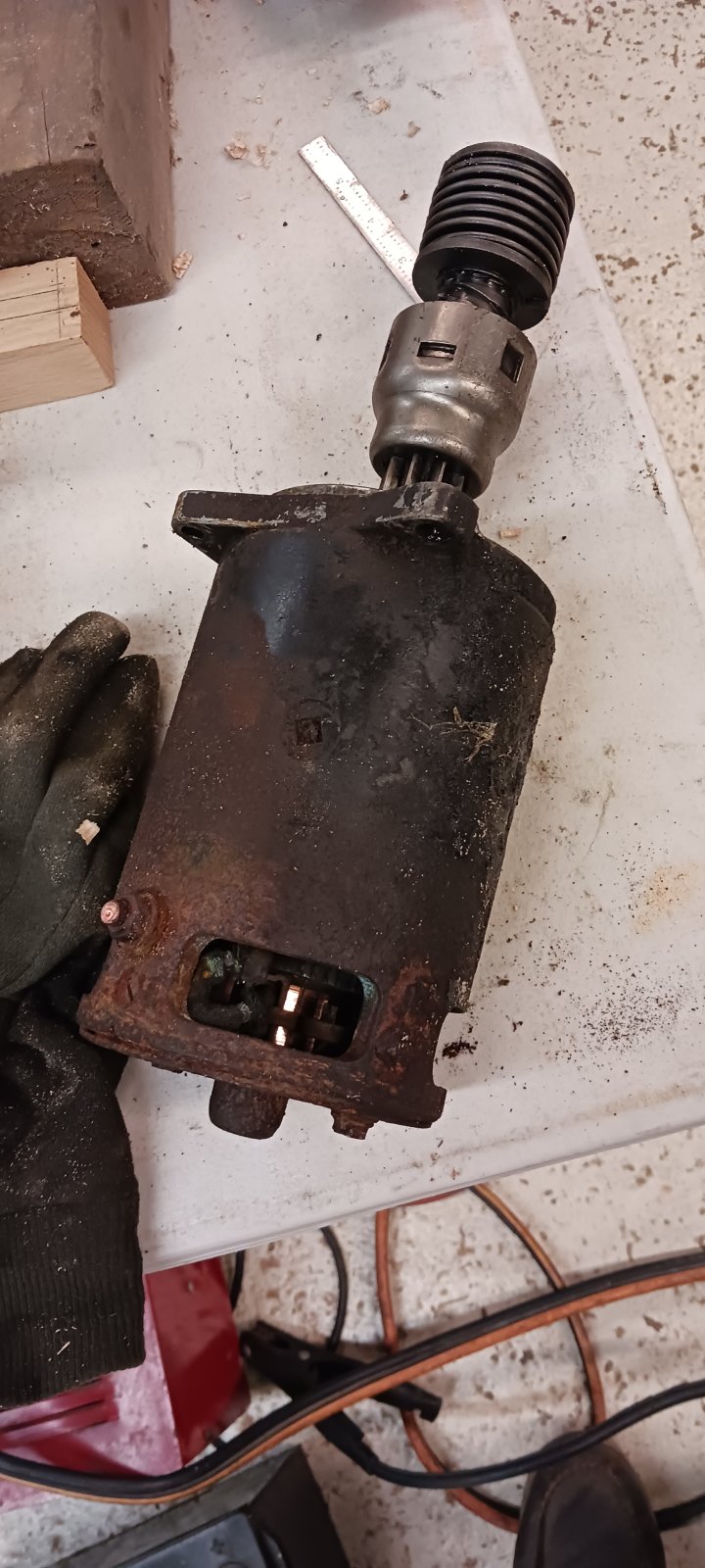

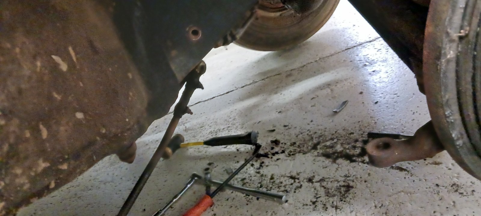

    So a little about how I was able to remove it, in the 1962 Motors Manual as indicated earlier it says to drop the steering for 58-60 Edsel, but the 60 Ford and Edsel are the same car essentially. Once dropped I had what I needed to get it out but going back was a worry that day.
    How it came out...
    And what I thought was ready to install..

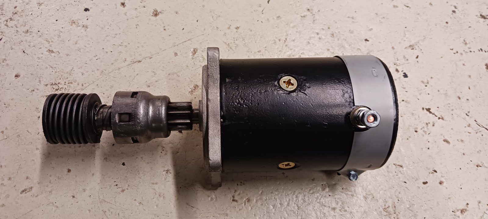

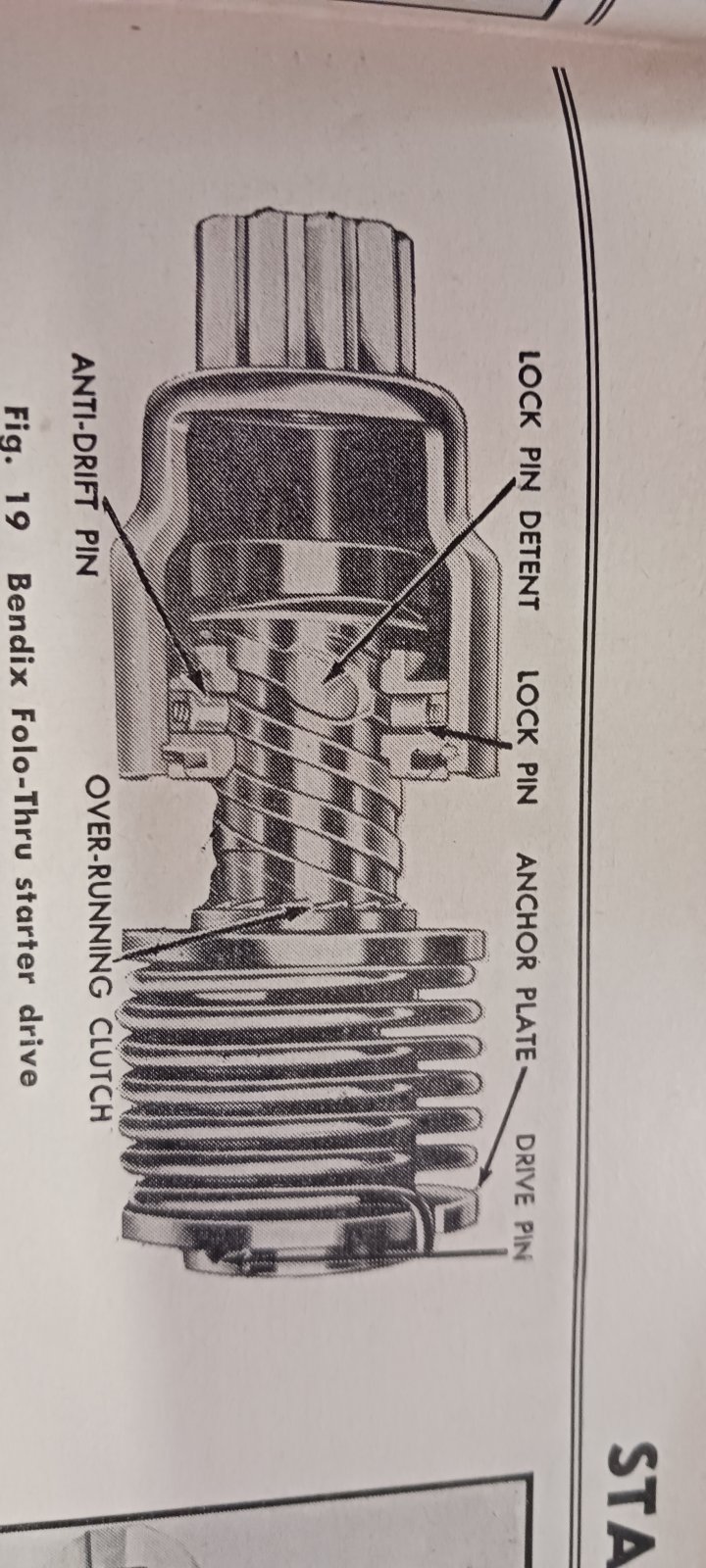

    Well, the drive (Bendix) for the win. After more angst and suffering than should ever be I dropped everything and searched all there was to know about the Bendix Folo-Thru drive,both in the manual and online.
    In pictures on the net it showed some extended and some drawn back, and I began to expect the extended pics were about how it traveled. Mine moved maybe ¼" and that's it. Being the hoarder/collector I am I rummaged thru some old starters, had a gummy drive just like mine,but why was it so much shorter? Took it off the old starter, cleaned it up really nice and got to engage and retract freely. Extended it sat just like mine, retracted, well back for easy engagement to the flywheel.

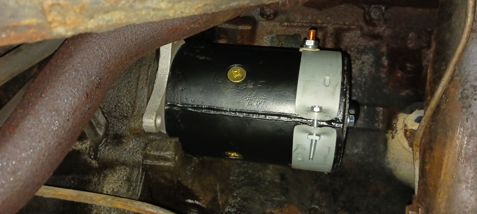

    There's the difference. I don't know how what was there would ever work, and may have been the reason the old starter drew so much current and turned so slow. The exciting climax to this effort, it damn near installed itself and I'm super confident in the whole gig. The mentions above about the drive steered me in the right direction, thanks for that, and as promised here it is in the hole. Now I know about early FE starters too. This job basically sux but all's well that ends well. Thanks again my bruthas...
