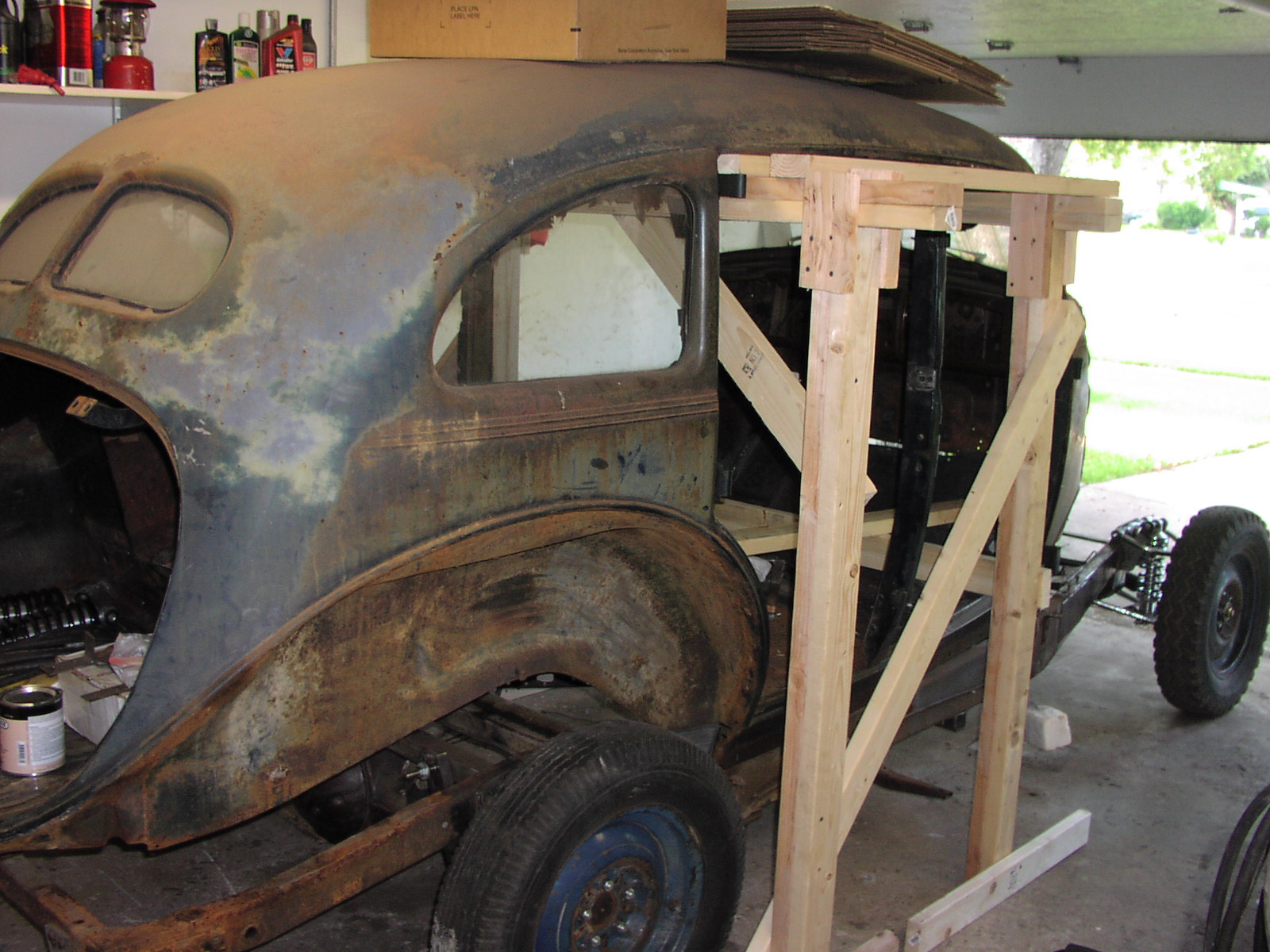

    When I took the body off of my '37 Terraplane I jacked it up as high as my floor jack would go then built a scaffold out of 2X4's to support it. I then took out the bolts and lowered the frame and rolled it out. After I finished the chassis I reversed the process and took the scaffolding apart. I'm new at adding picture so I hope the attachment worked.
