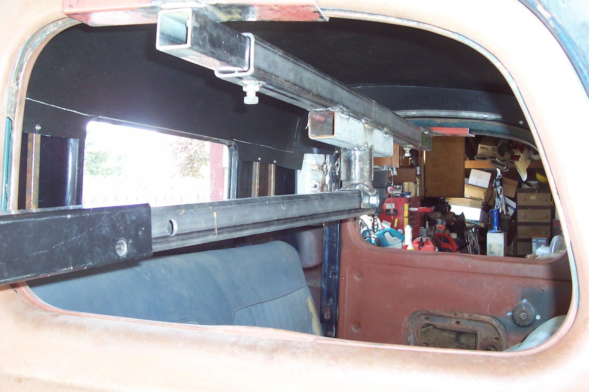

    An inexpensive 1 ton chain hoist from a pawn shop and a couple of 2X4's bolted together. Made it a one man job.
      328.5 KB
      144
