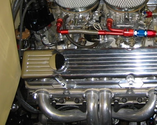

Technical What's the neatest/coolest/cleverest/pretty way to route plug wires on a SBC?
Discussion in 'The Hokey Ass Message Board' started by atch, Apr 13, 2025.
  1. atch
    Joined: Sep 3, 2002
    Posts: 6,412
    atch
    When Clarence had rams horn exhaust this was easy. I just ran the wires under the exhaust just like the factory did. Heat shields and all.
    For the last year it's had SS block hugger headers. So far the wires are just a hodgepodge of "put one here" and "put one there". It's really a conglomerate hot mess. I don't worry about it too much 'cause the hood is seldom open. However, when it is open it's because I'm looking/checking/repairing/etc. and I don't like the way the wires look.
    I've given thought to just about every commercially available loom and so far none of them trip my trigger.
    So please show me your wire routing with headers; preferably block huggers. Or even just describe what you think might be good.
    b-t-w; there is an alternator and A/C compressor; both mounted "high" over the valve covers. I'm not opposed to fabricating a solution; I'm pretty well resigned to the fact that this will be the final solution.
    Many thanks in advance.

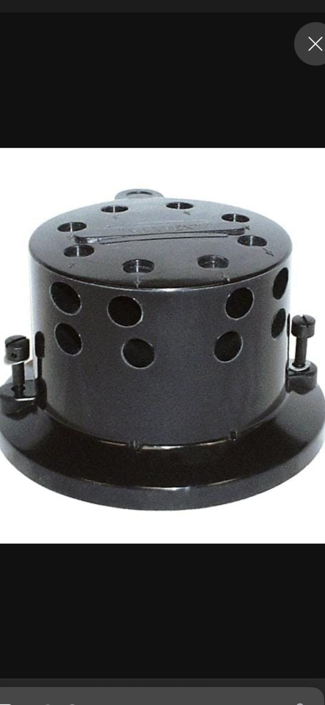

    Cut to fit wires ,
    Magneto stye cap or points style
    Then **** cap , & under
    headers / exhaust manifold.
    Angle plug headers work best for
    Both head style.

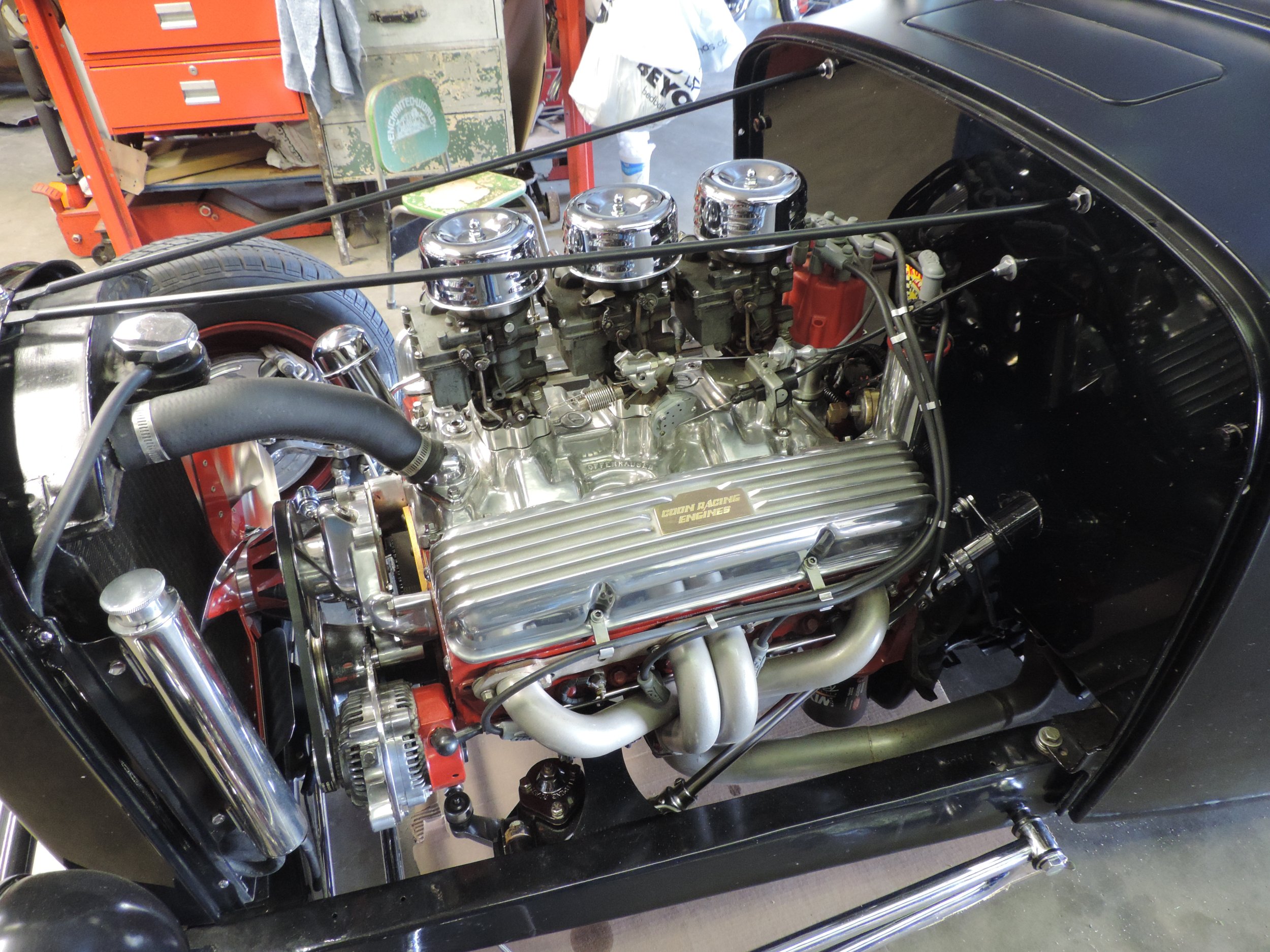

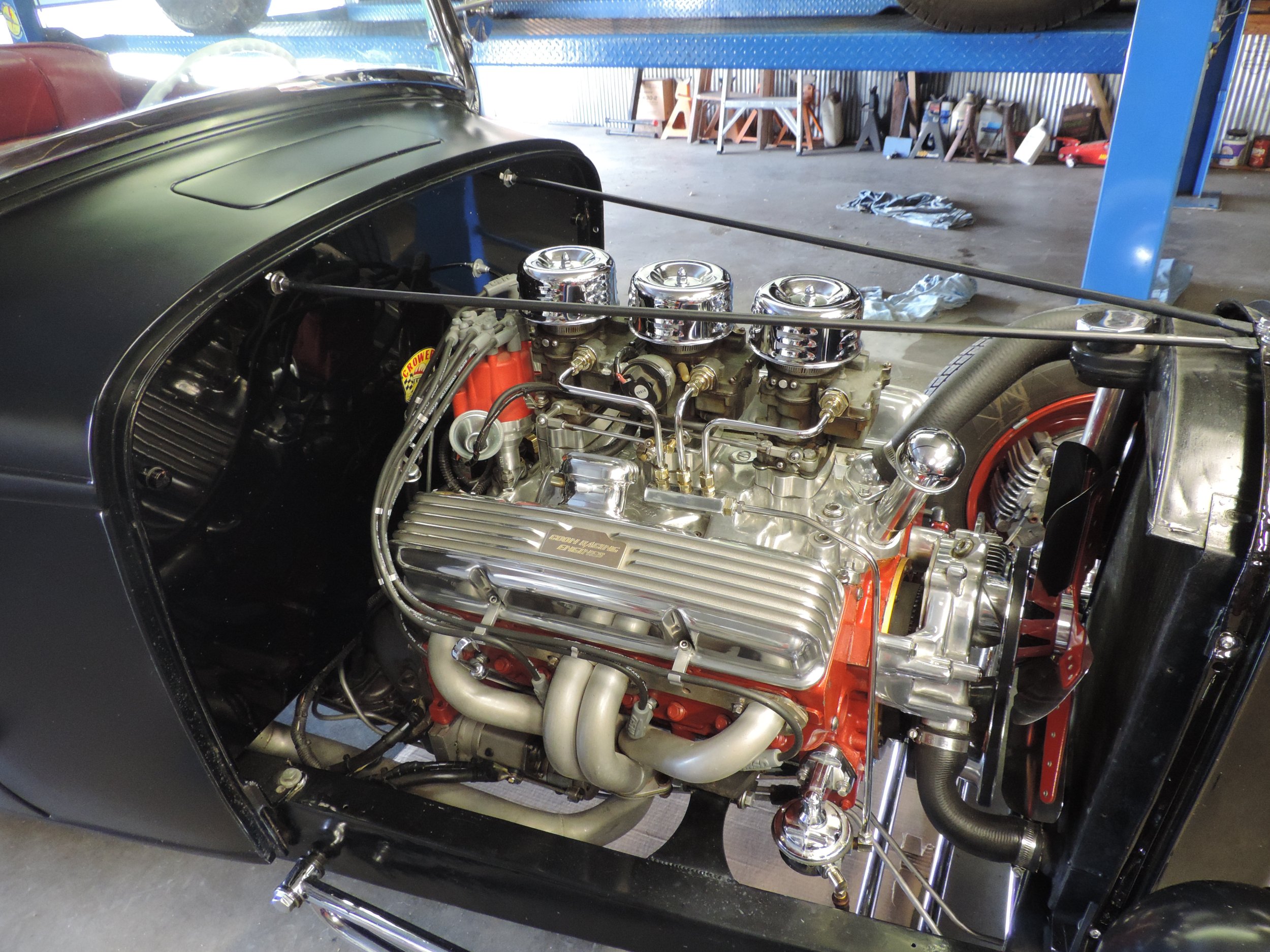

    Jeff Peterson down in Texas at The Preserve hot rod shop had a real neat set up a few years ago. He had 4 chrome tubes running in the dip where the intake and the valve covers kinda meet. All 4 plugs went all the way to the front then the tubes turned down and a couple inches down the plug wire existed and went under the headers from the front. Pretty wild looking. Kinda like the flathead ones that have an individual tube for each wire.
    oh! Along those lines Jordan Bennet did some neat plug wire tubes for a sbc in a roadster recently let me find his video

    Went underneath like stock; just had to run the front two on each side below the pan rail and tight to the pan as they went by the collector.

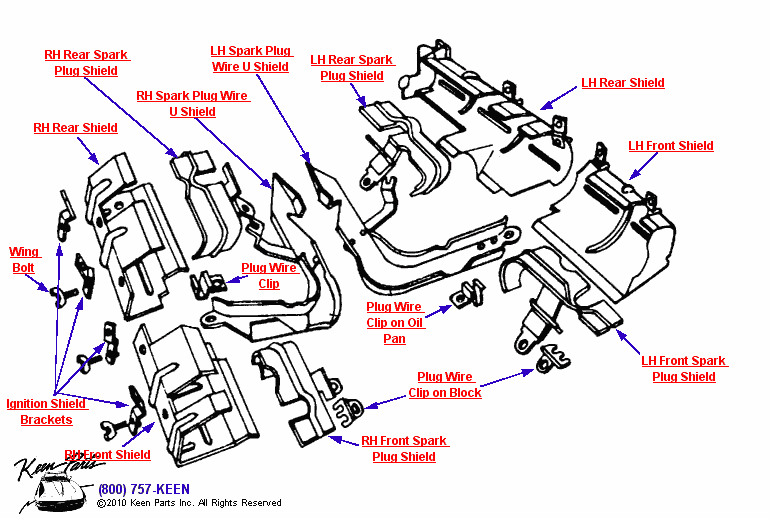

    Not the radio shielding so much, but the way it is supported all the way down the back of the engine and through the "V" shaped brackets under the ram's horns.The heat shielding is a nice feature too, and is separate from the radio shielding, which has caused for scratches and cuts on my hands than just about anything else. I was able to get ALL of the shielding back on my Corvette. It was one of the most finicky jobs of the whole project.:rolleyes:
    Edit : I just noticed that this diagram does not show the routing brackets below the distributor at the rear of the block.

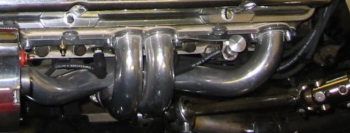

    Like this, under header , hidden, if you can pull it off with your headers and not burn boots or wires. WIN_20210424_16_31_41_Pro.jpg

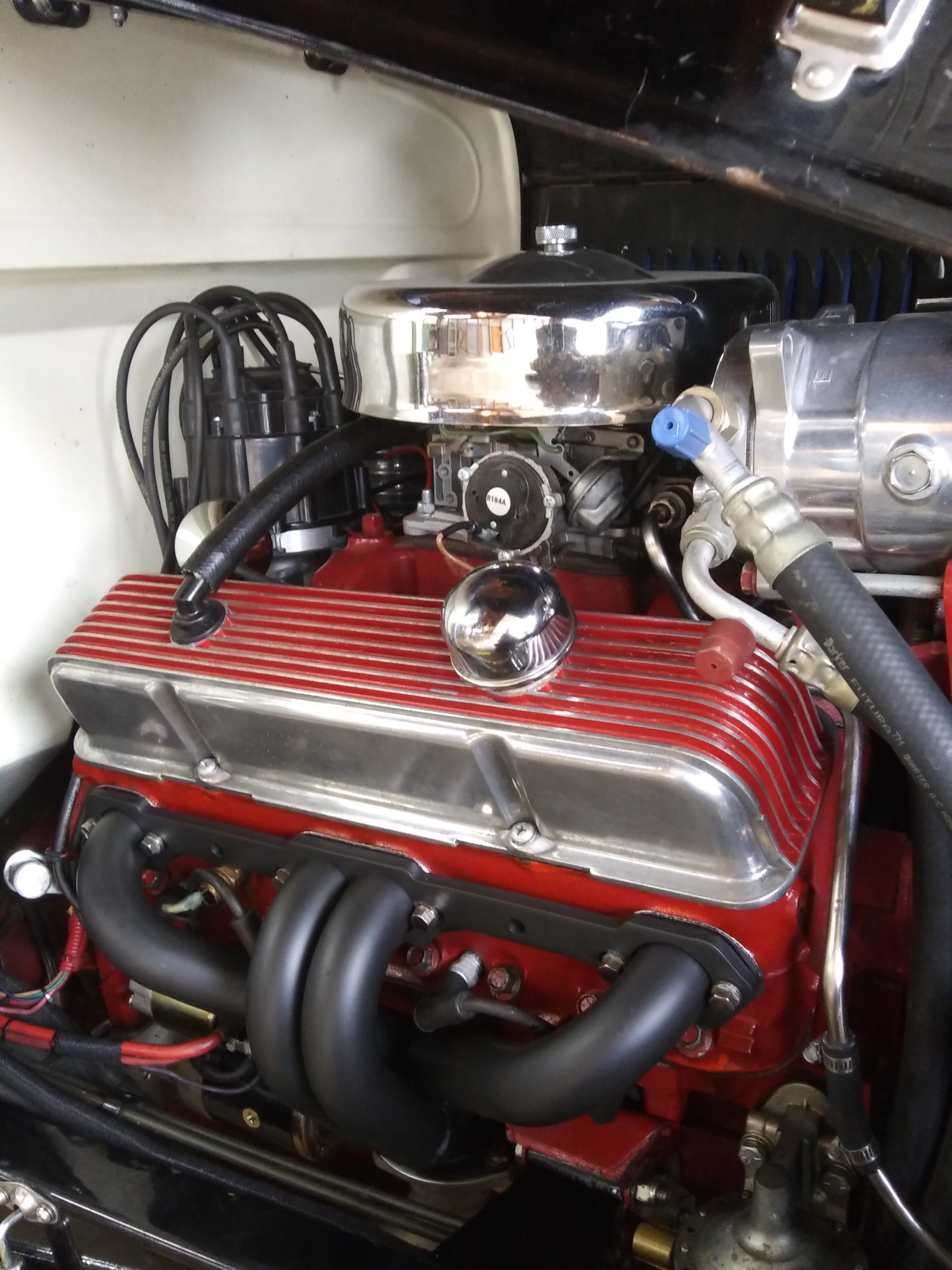

    I hate seeing wires over the valve covers on a sbc unless you have no other option, mine are somewhat hidden. WIN_20210424_16_30_22_Pro.jpg

    Are those wires far enough from the exhaust tubes to prevent melting the insulation? I (so far) haven't considered going under because I think the wires will burn due to the close proximity to the hot tubes.
    Mikey,
    I wish I had the room you have to go underneath. No such luxury with block huggers.

    I used tri five looms at the rear of block and intake. The front pair run along the oil pan rail. I've used both home made and early Corvette wire brackets on the pan rail.
    Universal, cut to length wires with right angle on the spark plug end.

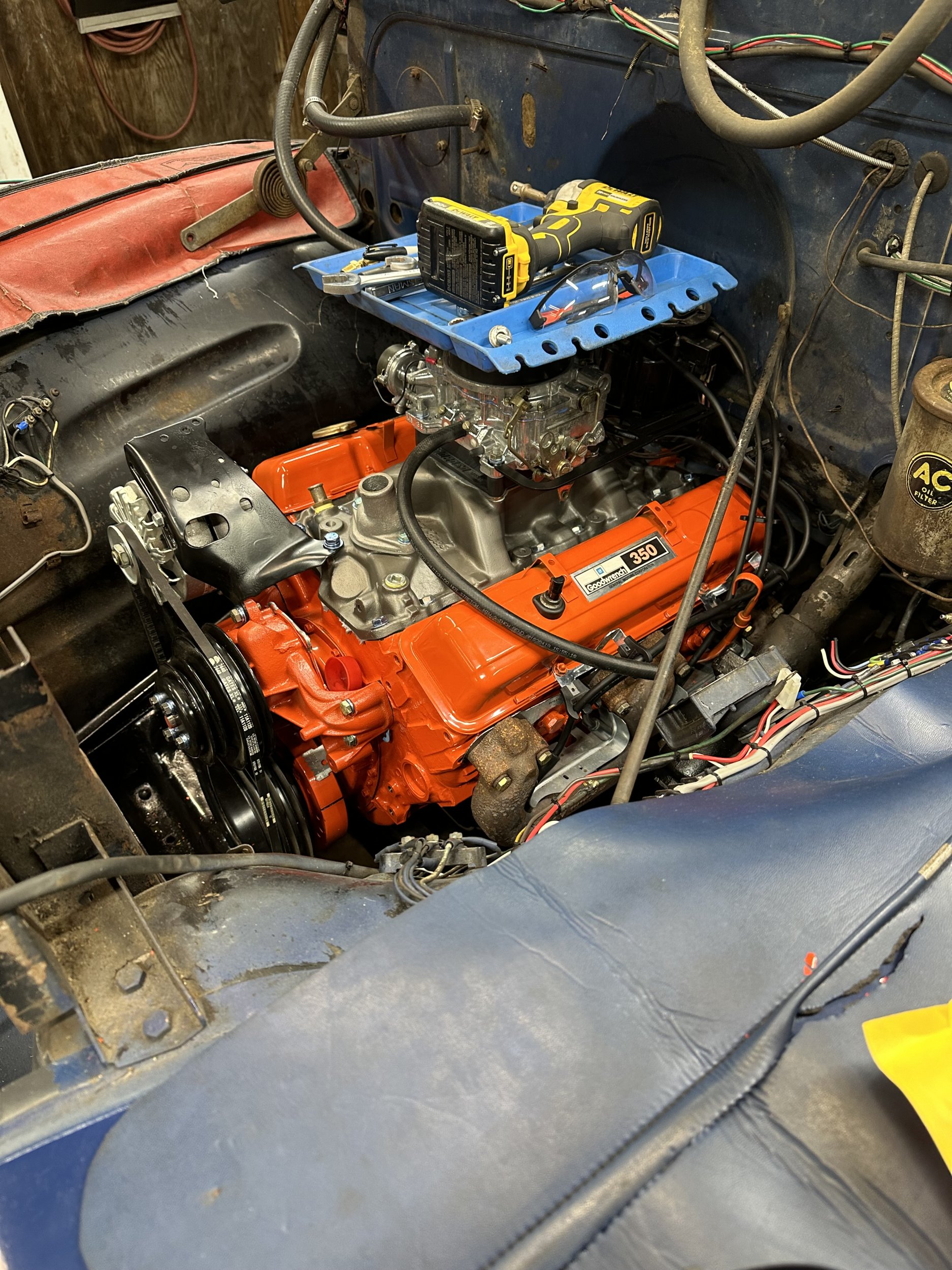

  22. IMG_8546.jpeg Mike, this the left side of Papaw, I used Moroso plug wire looms with plug wires for a 1977 C-10 with a 350. Don’t ask about the other side, it has a Ram’s Horn on it and the wires run under the manifold like stock. Those are 1978 Corvette.

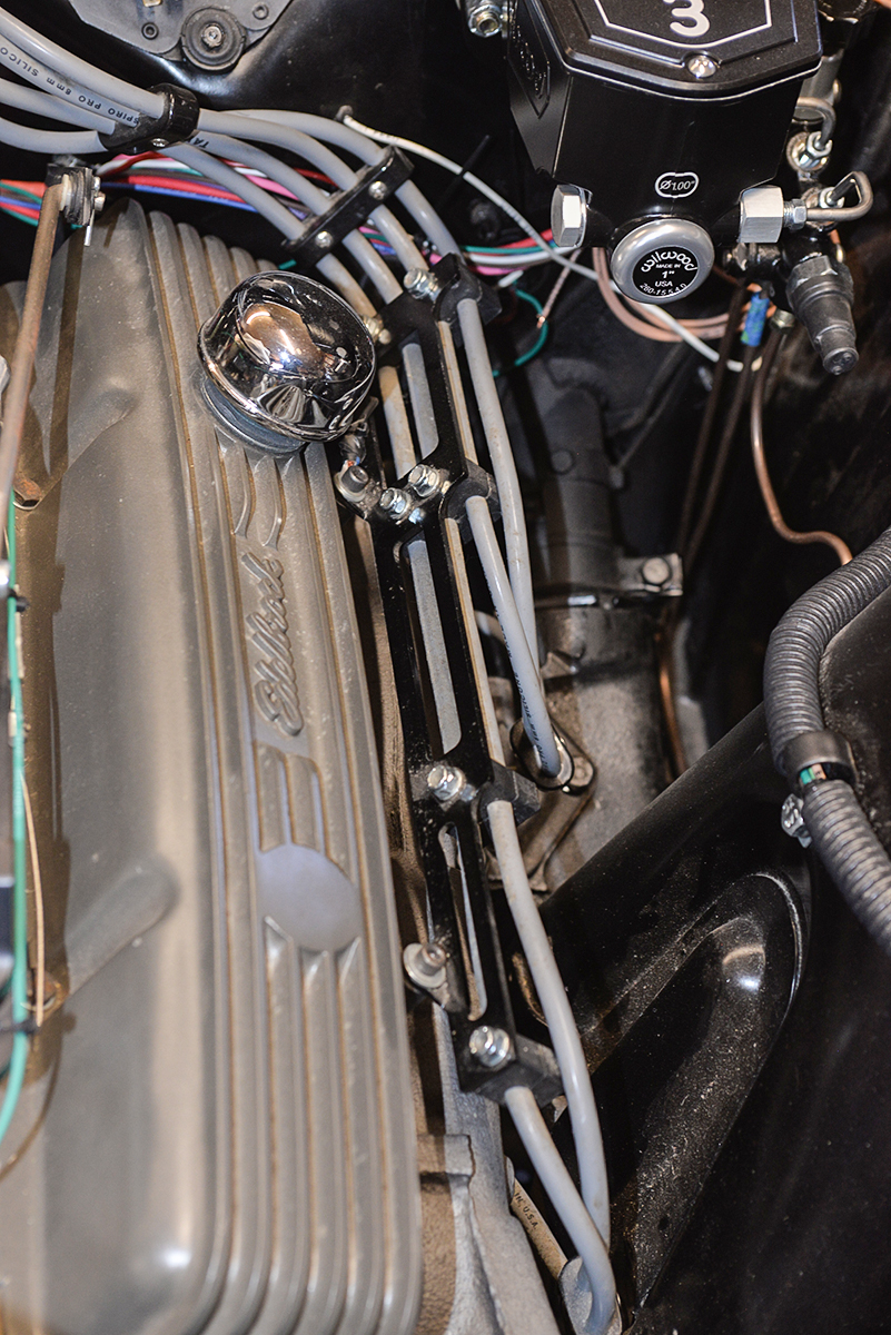

    I've done two engines with Squeegi's wire holders, he's in Arizona. DSCN3481.jpeg DSCN3480.jpeg

  25. Bunch of ways, depends what you like. Do you mind if they're over the valve cover, do they need to come from the top or underside, is there enough room behind the valve cover and firewall for wires, angle plug or straight plug, straight, 45 deg or 90 deg boot.
    You could make a modified version of the stock Flathead tube
    https://www.badinnovations.com/product-page/small-block-chevy-standard-plug-wire-retainer-set
    https://www.squeegskustoms.com/product-page/small-block-chevy-chrysler-spark-plug-wire-separator-kit

    I really dislike those route all 4 along the top billet stuff. It was the second thing I yanked off the T. The first was the fake injector scoop. :eek:
    If they have to go over the top, I'd go with the tall stands on the back of the intake and the wire holders at the lower valve cover bolts, like the factory did on some. Not as neat as under, but if the headers don't allow that, this would be second best for my eyes.

    @chevyfordman,
    This is petty close to what I was considering making. I didn't know they were available "over-the-counter". I Googled Squeegi and every iteration of it that I could think of. Do you have a link or contact information?
    manyolcars likes this.
