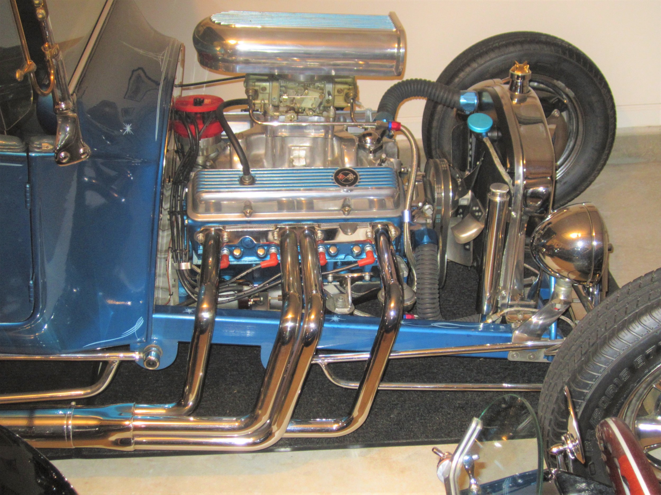

    note that the example you show uses the type of manifolds that allow all the wires to come from the top. That's not what atch has, unfortunately.

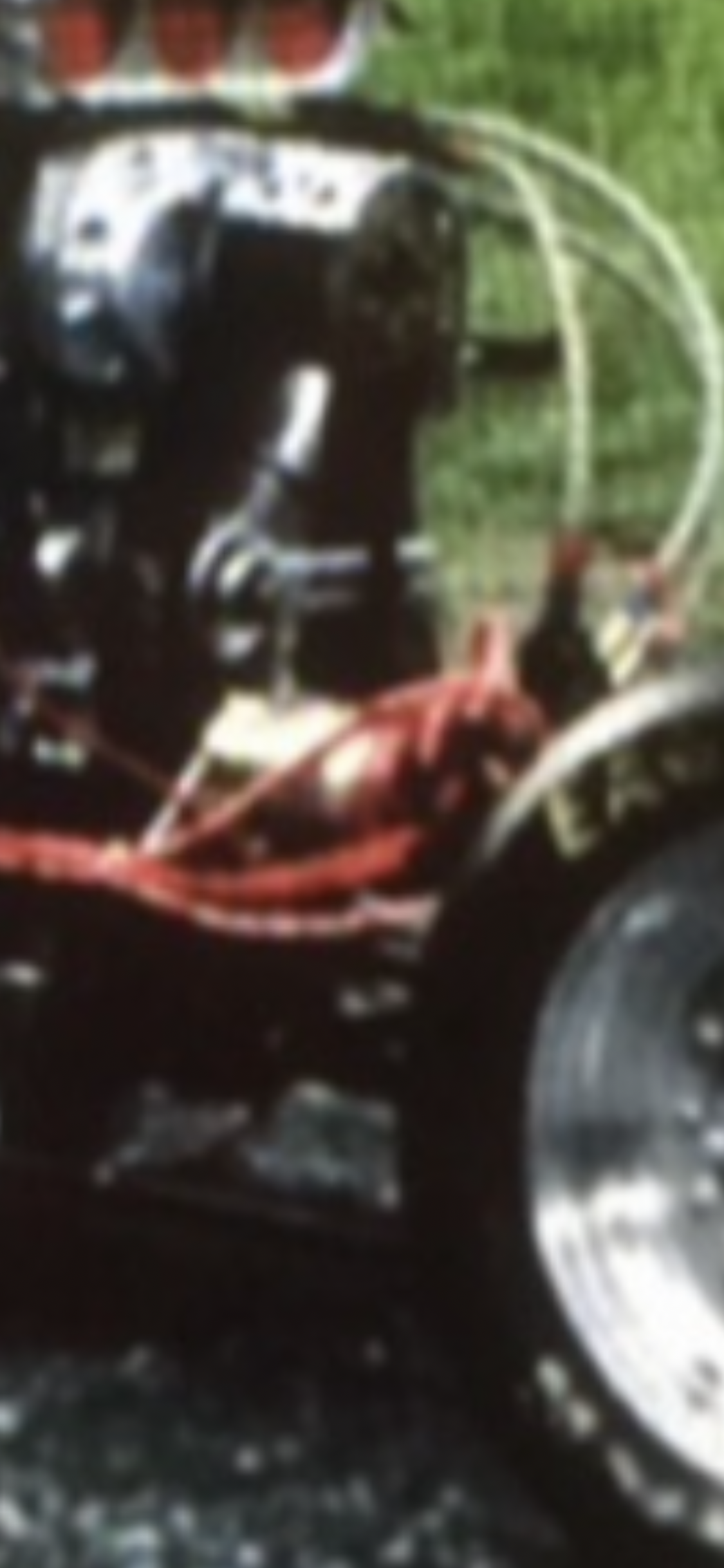

    I'm in the minority here. must be because when I was young int he early 70's all wires were yellow and over the covers.
    I use a cal custom loom attached to the inner fender per my avatar.

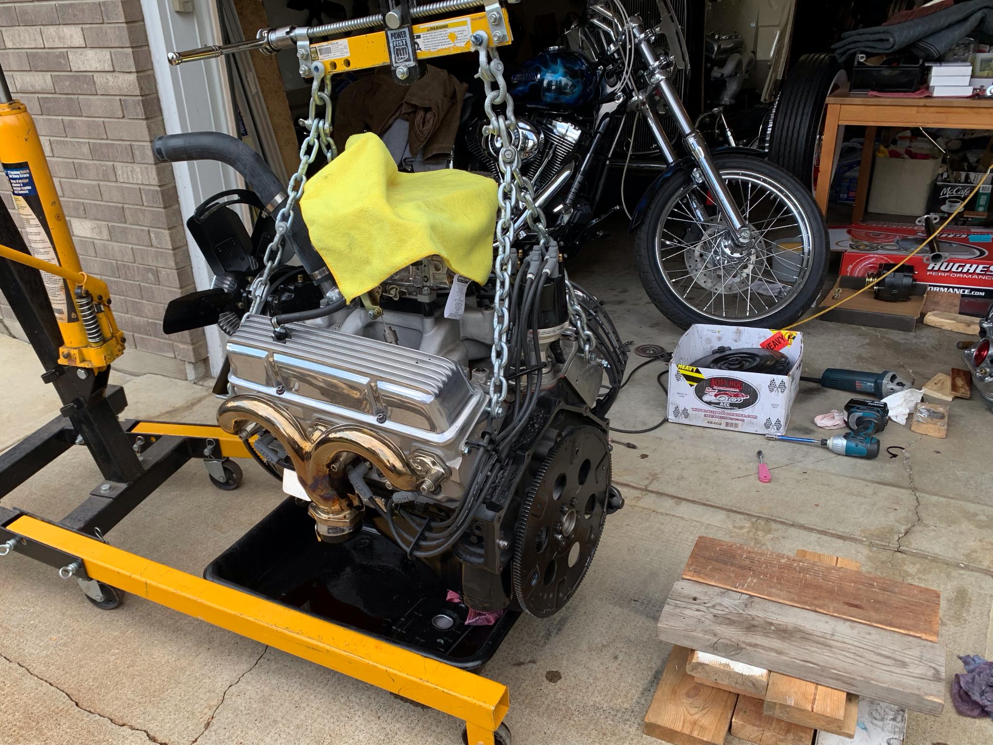

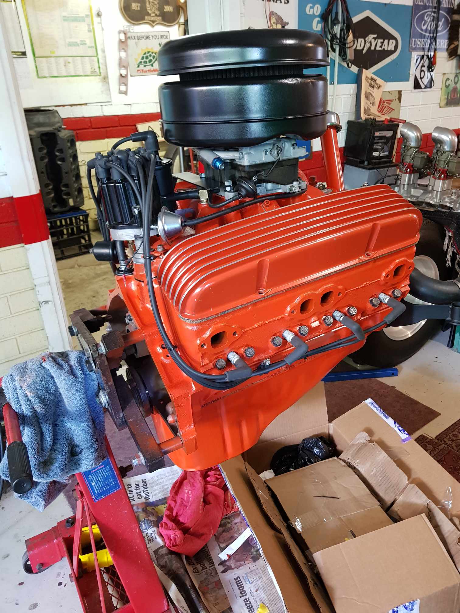

    I’m sure others do it this way, but here’s my way to route the plug wires.
    Around the back and under the rams horns. Use looms wherever possible to hold in place. Use a heat shield sleeve where they p*** under the exhaust outlet. And depending on your engine mounts, bring the front cylinder wires up through the mount.
    Pic from a torque converter swap.

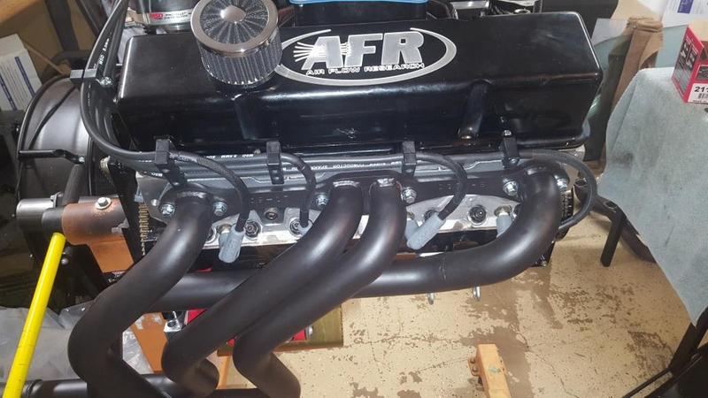

    I like to get them going in the right direction out of the cap and then out of sight behind the heads and under the exhaust.

    Please read and see my photo in post #20.
    The wires for 4 & 6 are along the oil pan rail, behind the header.
    Same with 3 & 5 on the driver side.
    bschwoeble likes this.

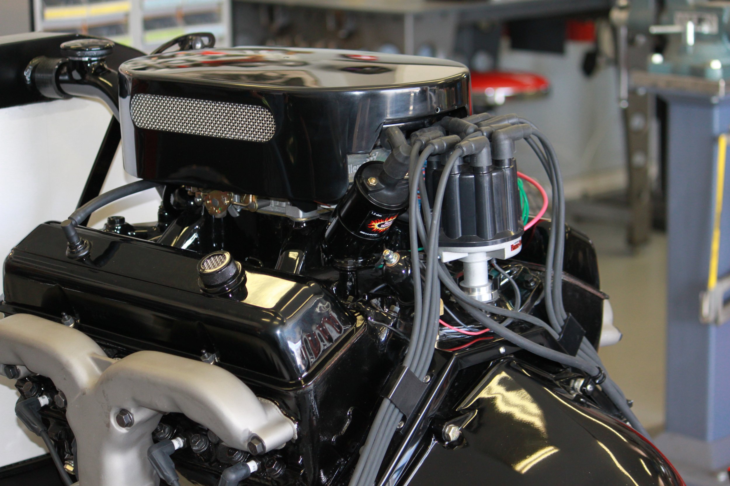

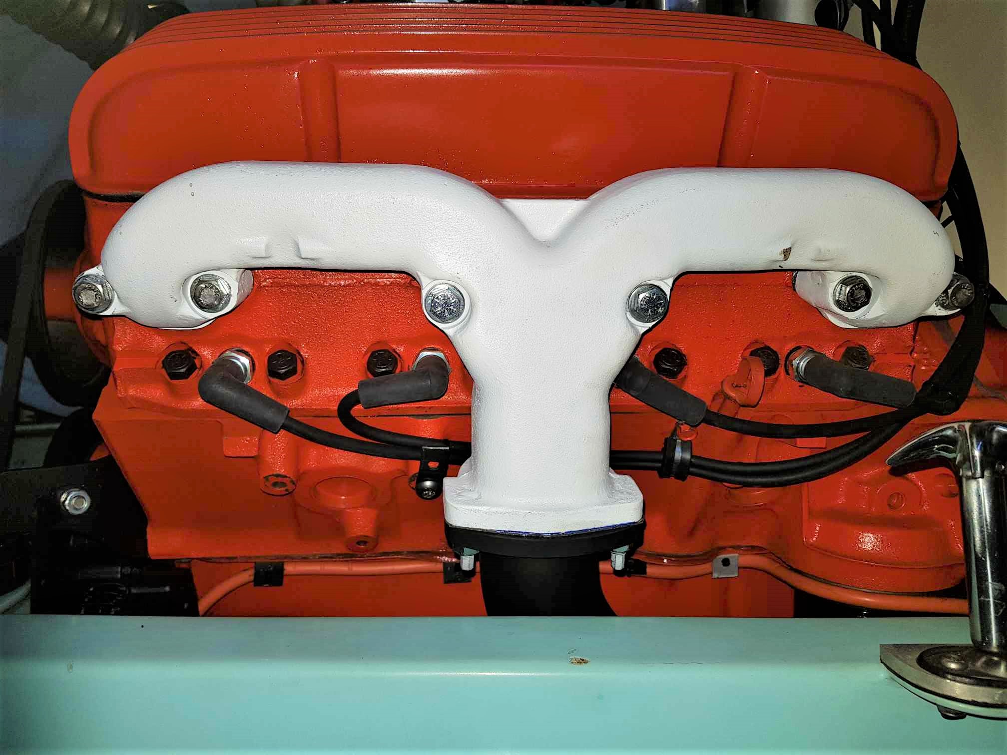

    How about something like this
  25. atch
    Joined: Sep 3, 2002
    Posts: 6,415
    atch
    That's pretty close to what I have in mind.

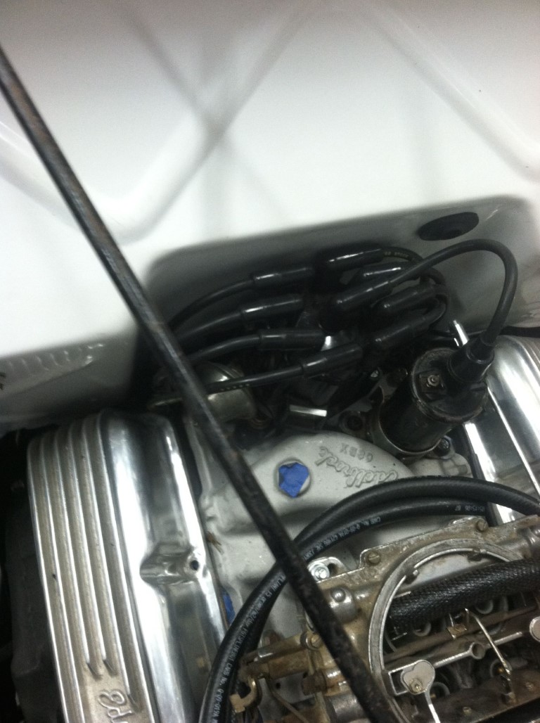

    I ran the plug wires through Delron blocks before attaching the dist. cap ends. I made a sheet metal plate mounted to the block behind the head. Attaching the blocks to the plate, always use black plug wires! Tried to keep things neat and orderly. IMG_1943.JPG IMG_1945.JPG IMG_2294.JPG
