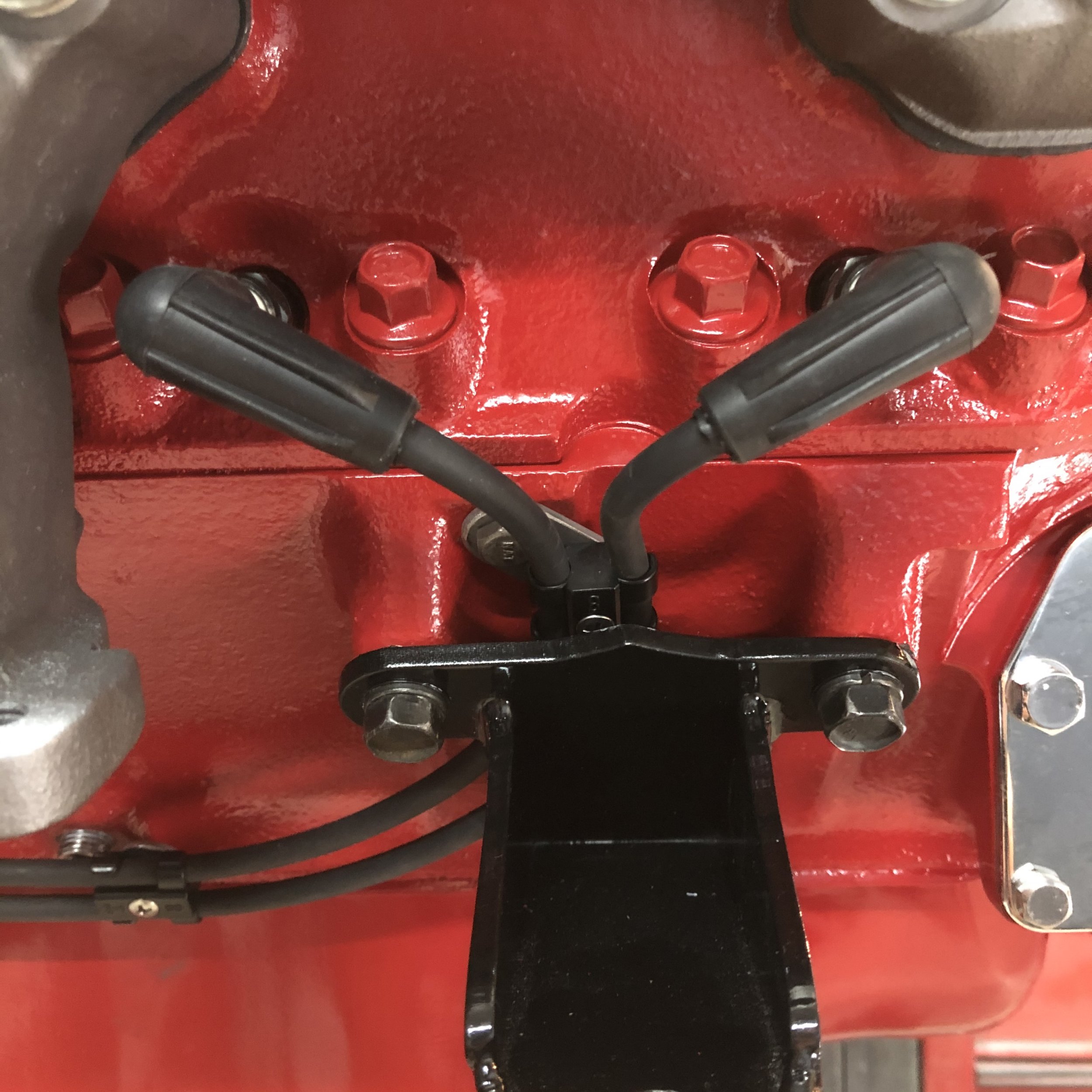

    When mine is done it is going to be very much like pprather's. Looms on the back of the block and the 2 wire clips at the top of the block between the plugs. The front two wires will run down to a retainer on an oil pan bolt and up under the motor mount.
    I'm wondering, is there enough clearance down lower between the oil pan and the exhaust pipe to make a bracket for a loom and run the wires forward there?

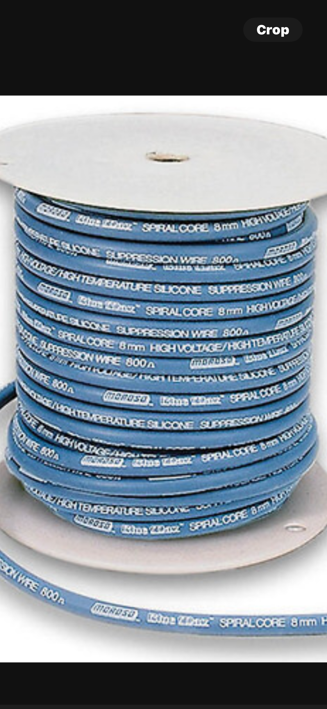

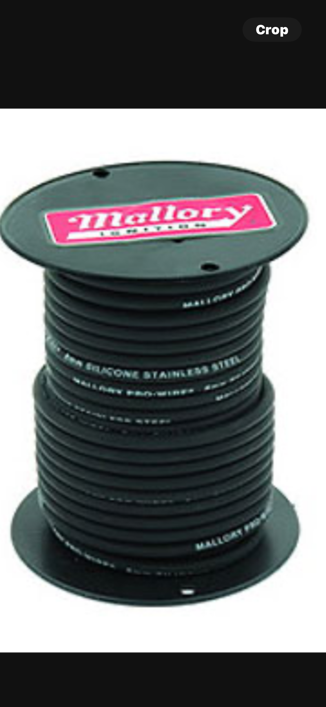

    Best Way , & your Not Short !:)
    $150- 200 ish

    I'm ***uming Sarcasm ? !
    If not 100 ft roll , more then enough to do a few 440s

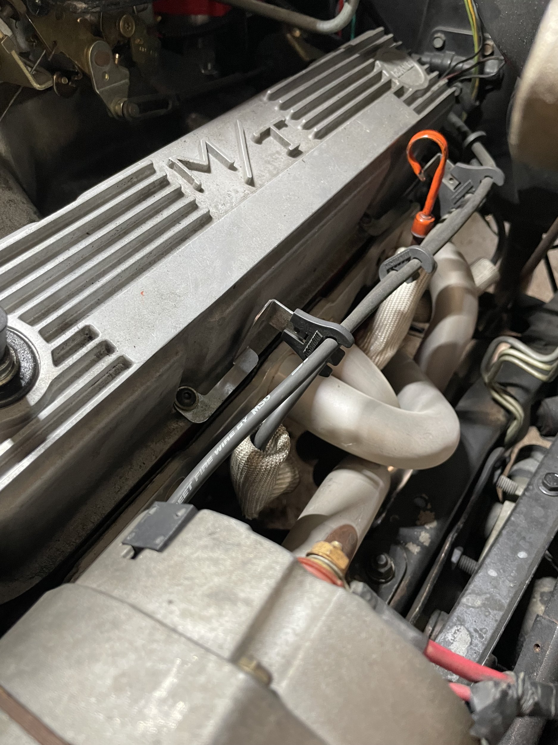

    These are chrome which I like better than the billet ones. Can't remember the brand, Summit sells them.

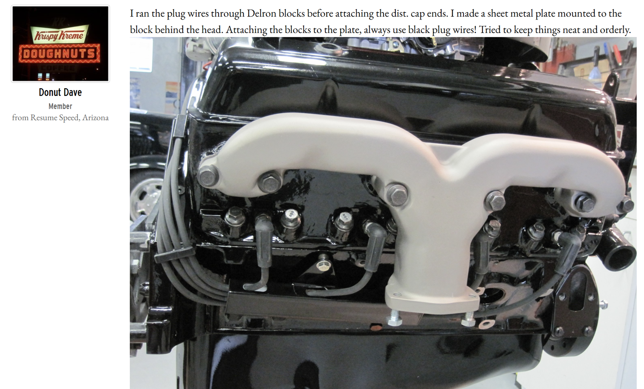

    The photo below from @Donut Dave is the type that works for headers and Y exhaust headers. Very neat arrangement. The underneath route is the safest and cleanest in any compartment.

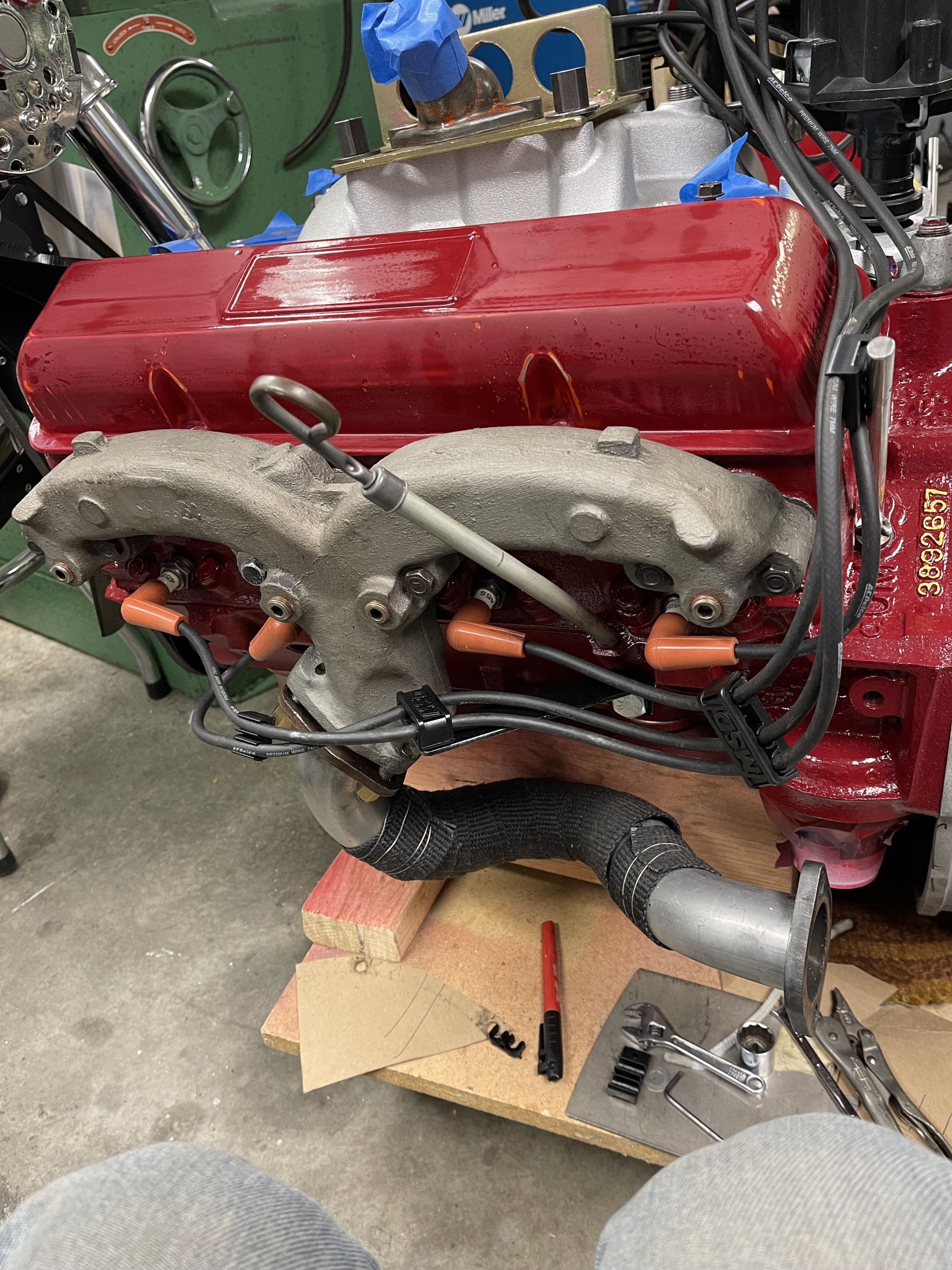

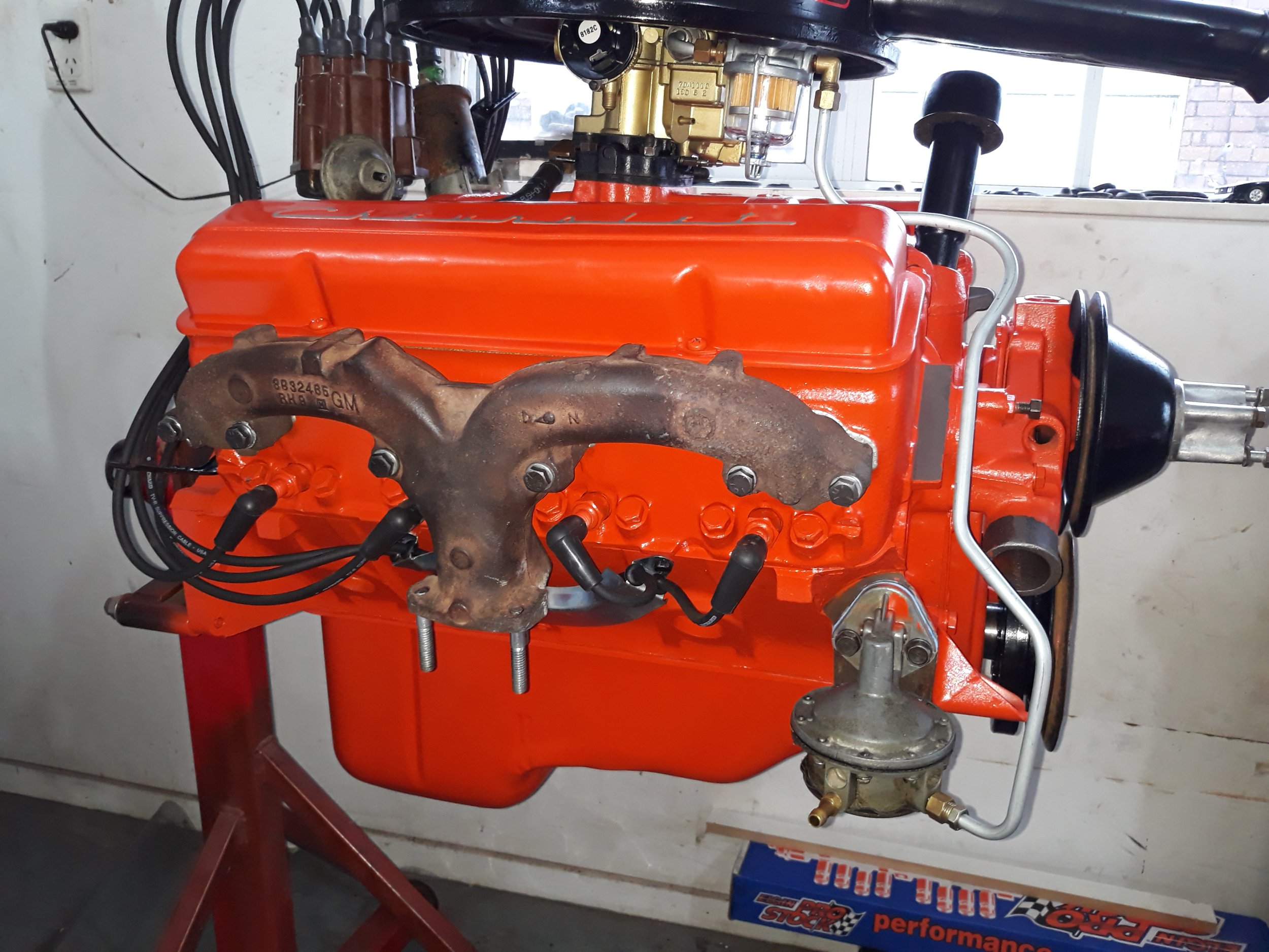

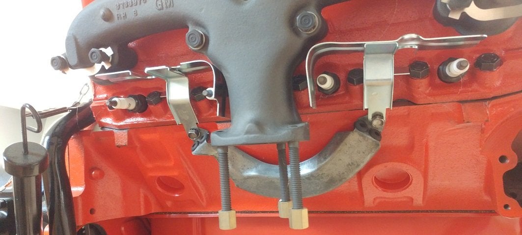

    Here is the way I'm going on a 327 with cast ram horn headers. I didn't want to go behind the manifolds as it is too close and makes the wires longer and hard to remove if you have too. IMG_2810.jpeg IMG_2809.jpeg

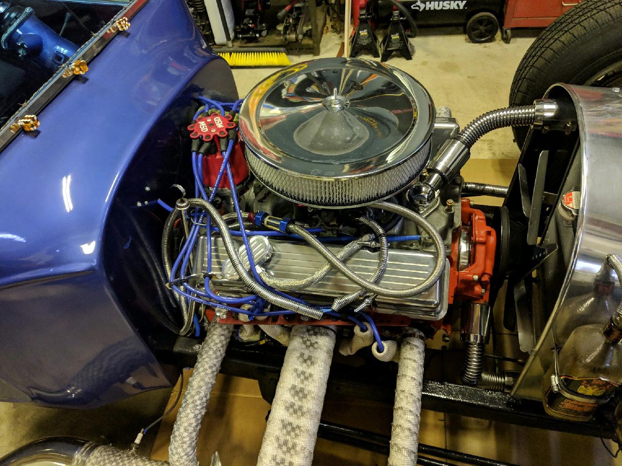

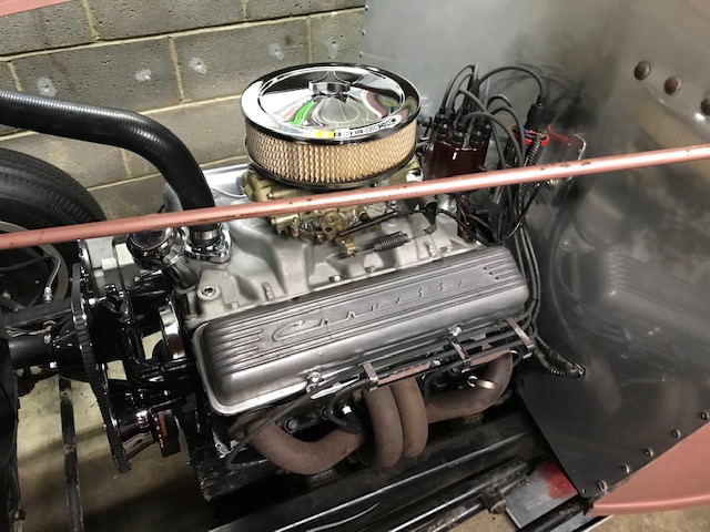

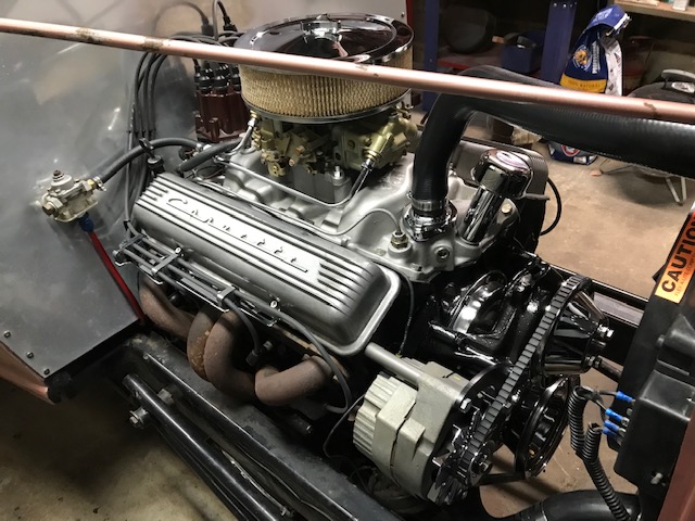

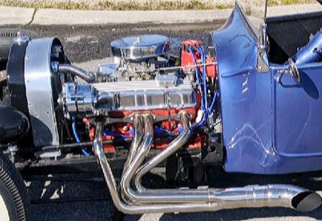

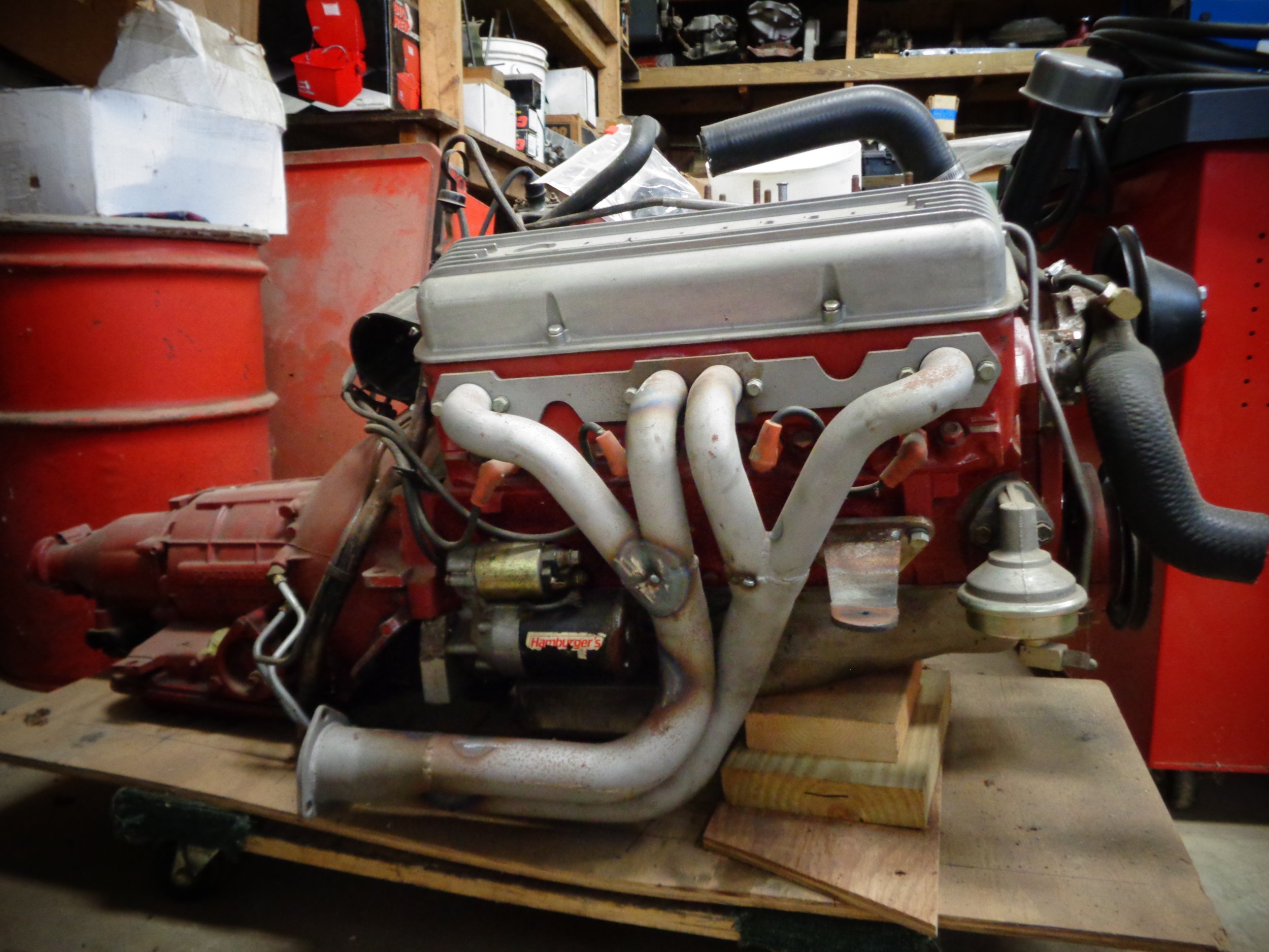

    F8FA69BA-951D-4E8A-960E-AD4D65BF9D81.jpeg AE7FECBE-FA85-4F3E-8D92-FE48F4051845.jpeg Here’s a before pic of my “T” when I acquired it, followed by an after shot when I cleaned it up a bit…

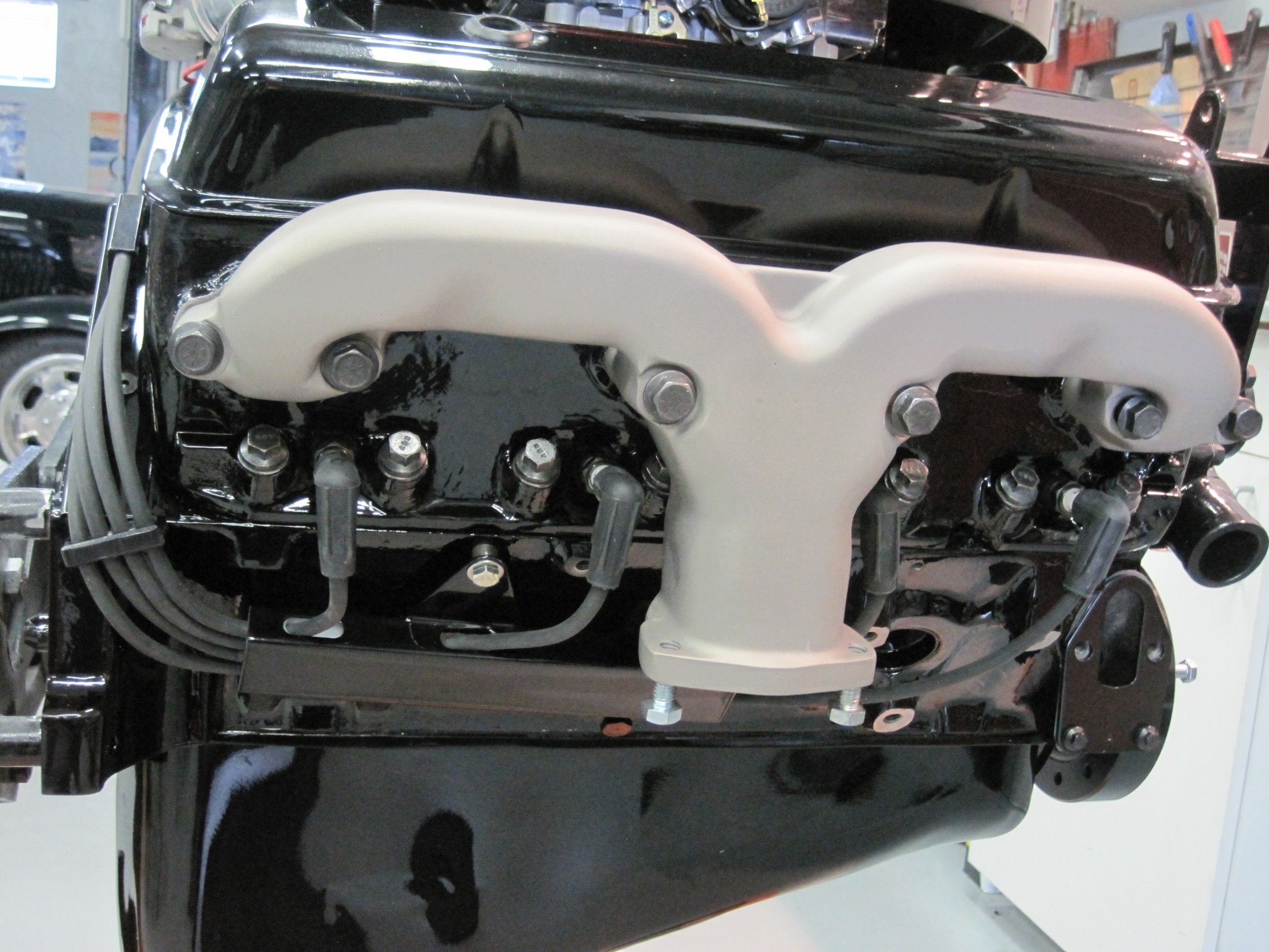

    That’s perfect!
    What’s the story on the manifolds? Lots of sanding? Alumicoat?
    Thx.
  21. atch
    Joined: Sep 3, 2002
    Posts: 6,415
    atch

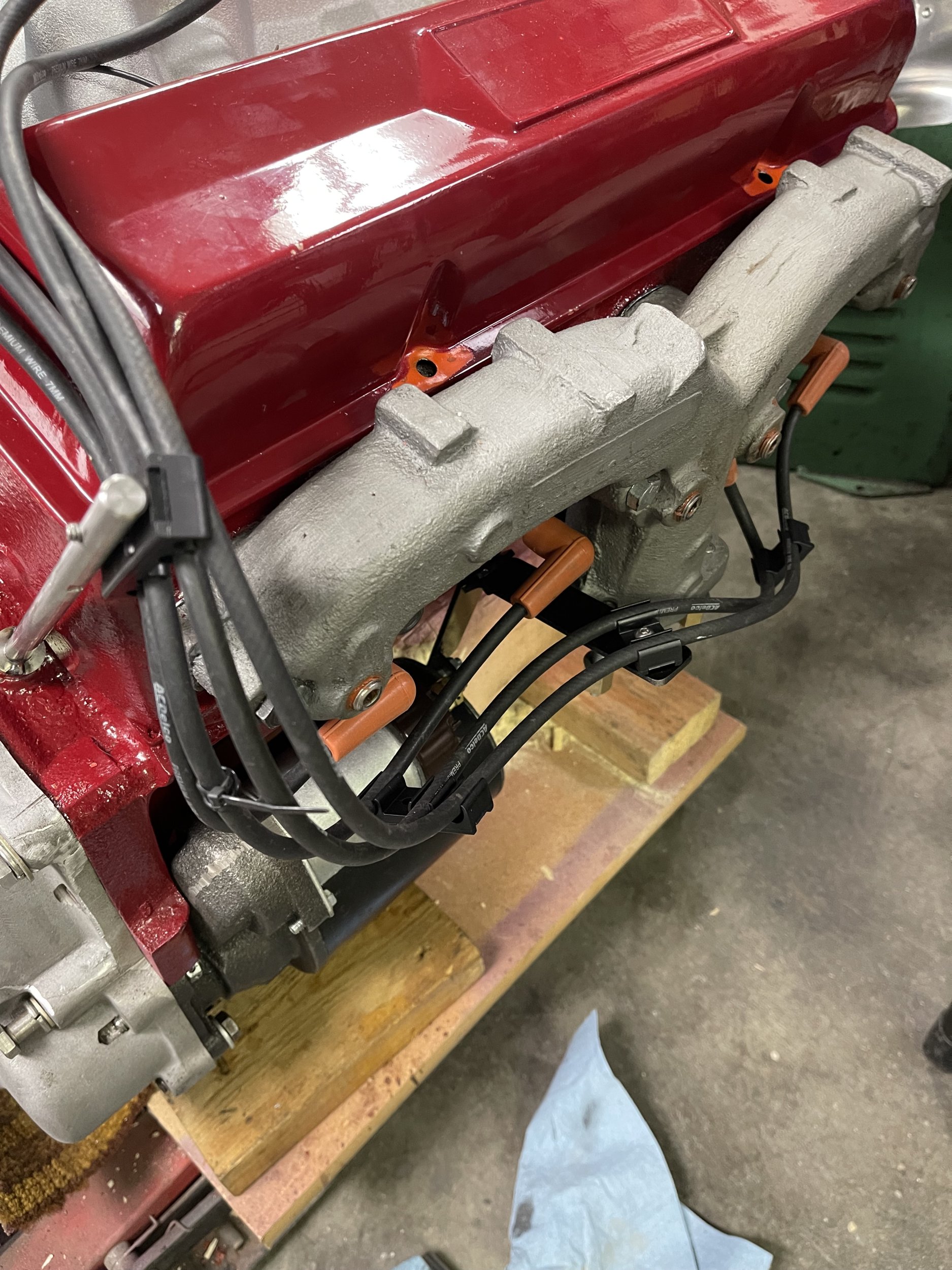

    @Donut Dave,
    I'm liking this too and wondering how many hours it tool to get them looking like this.
    OR, are these aftermarket that came looking this good?
  22. Donut Dave
    Joined: Jul 9, 2007
    Posts: 500
    Donut Dave
    Purchased 2-1/2” after market ram horn manifolds which are somewhat smoother than stock. Then I ground/sanded off all the casting lumps, bumps and numbers. After that I lightly bead blasted and applied Cerakote glacier gray. Time consuming but worth the effort! Donut Dave
  23. hotrodA
    Joined: Sep 12, 2002
    Posts: 7,372
    hotrodA
    ^^^^^ Thanks for the response Dave. They’re great! I really like the flat shape. Looks like they’re pretty inexpensive on E-Bay.

    Yes it is okiedoie
  26. okiedokie
    Joined: Jul 5, 2005
    Posts: 4,950
    okiedokie
    from Ok
    Nice work on the head pipe.

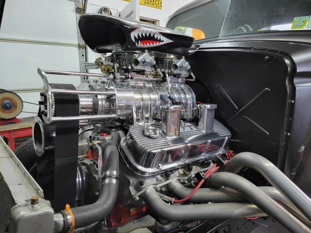

    My exper4ience has been that you need to make the wires for a truly neat appearance.
    Granted, it's a BBC in my 55 Chevy but you get the point. I ordered the parts from Ton's on eBay.

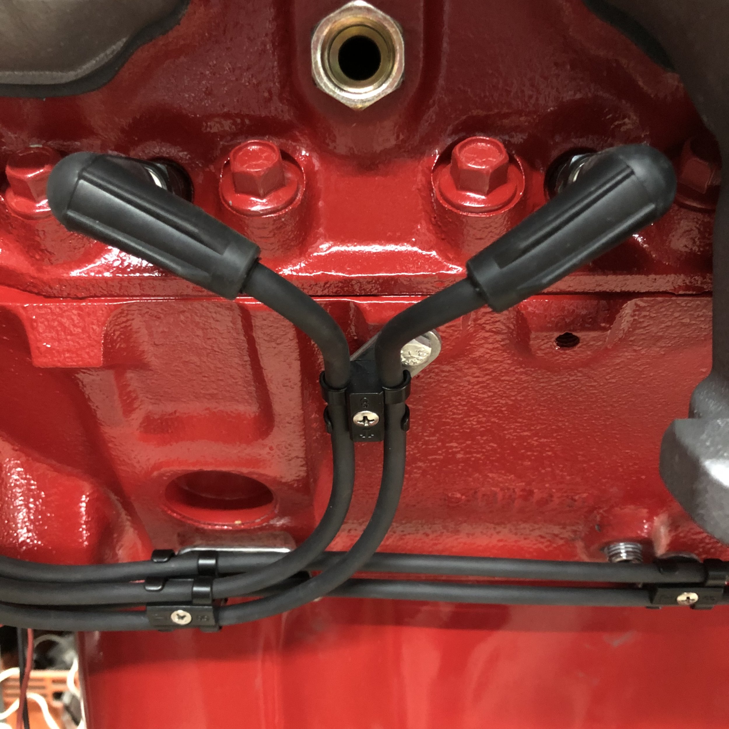

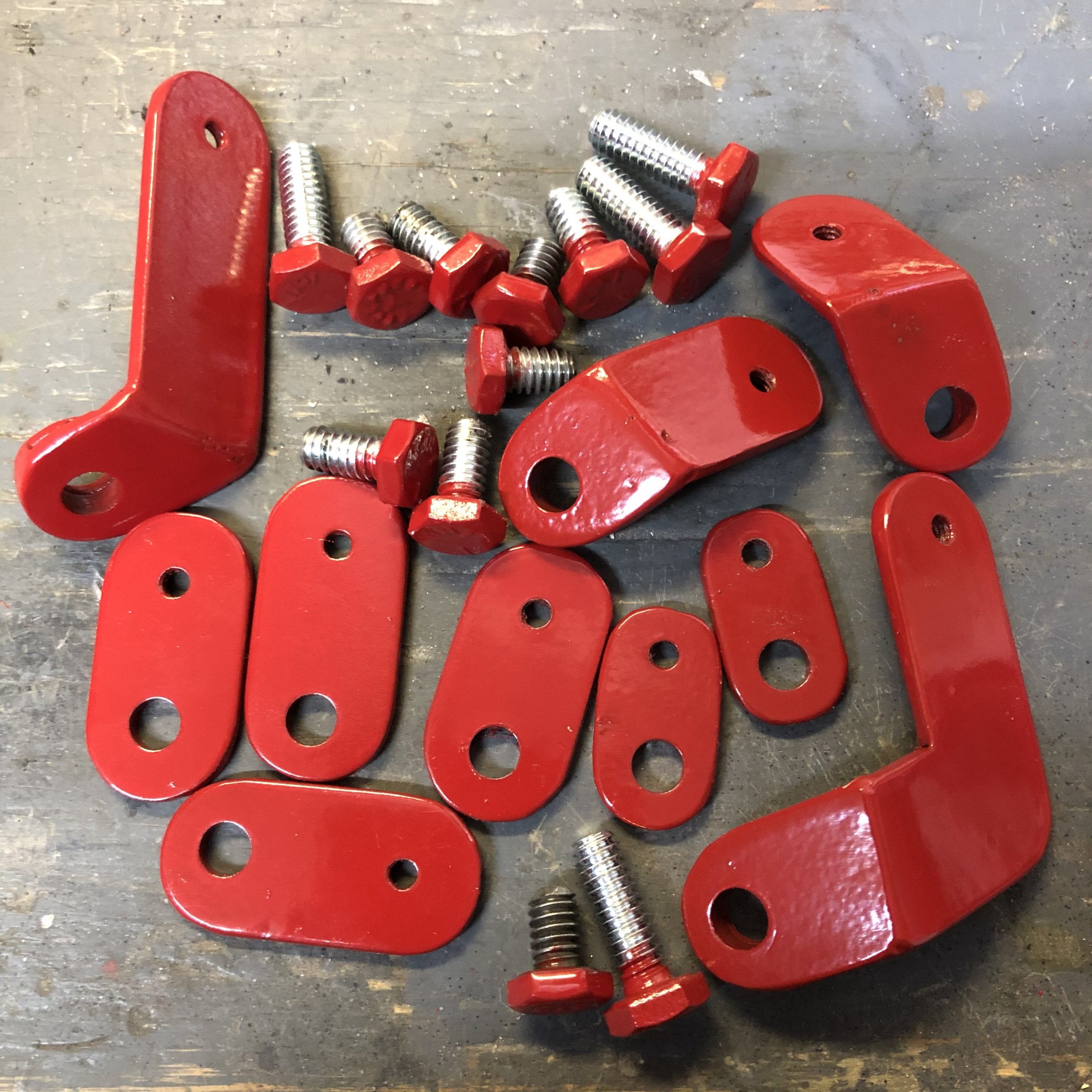

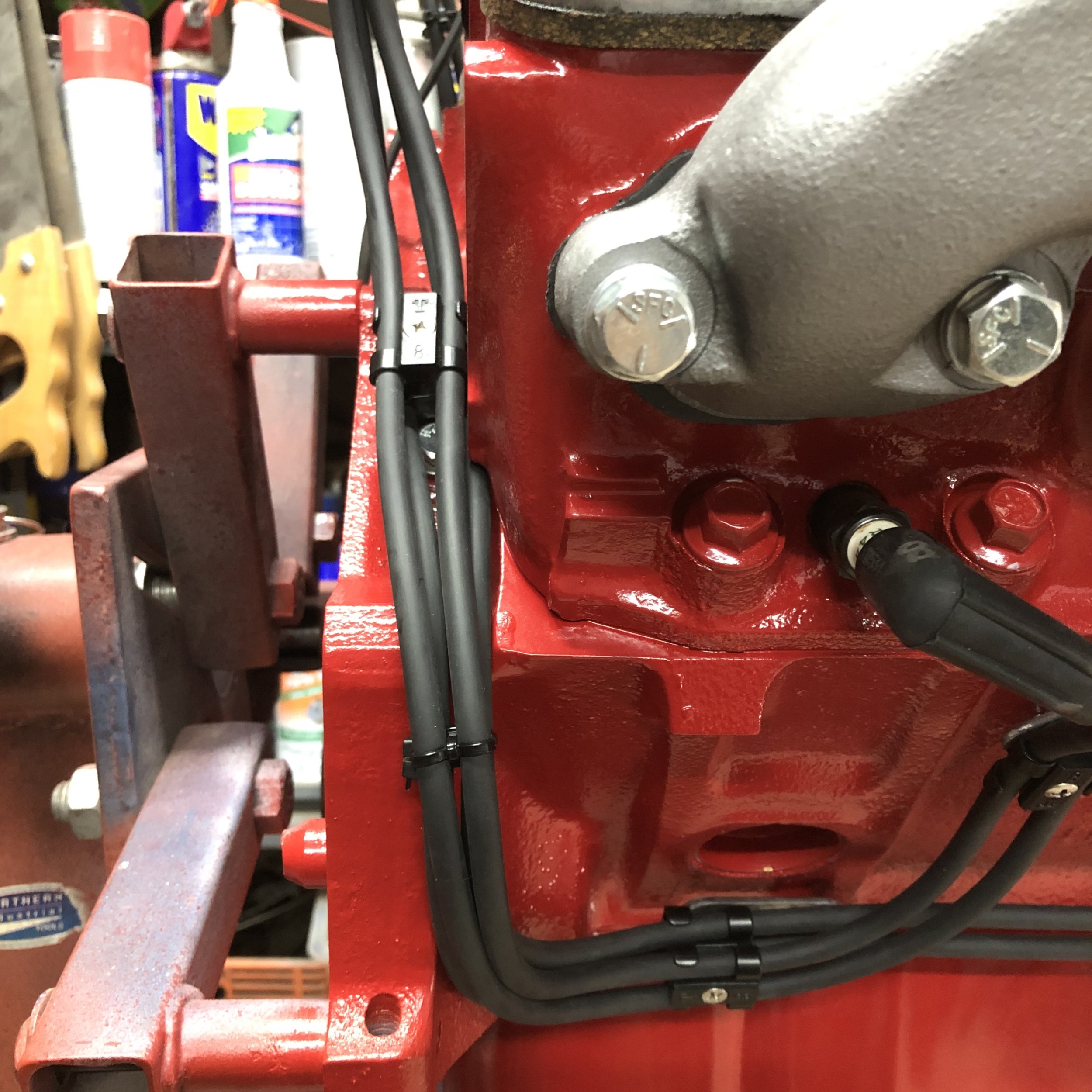

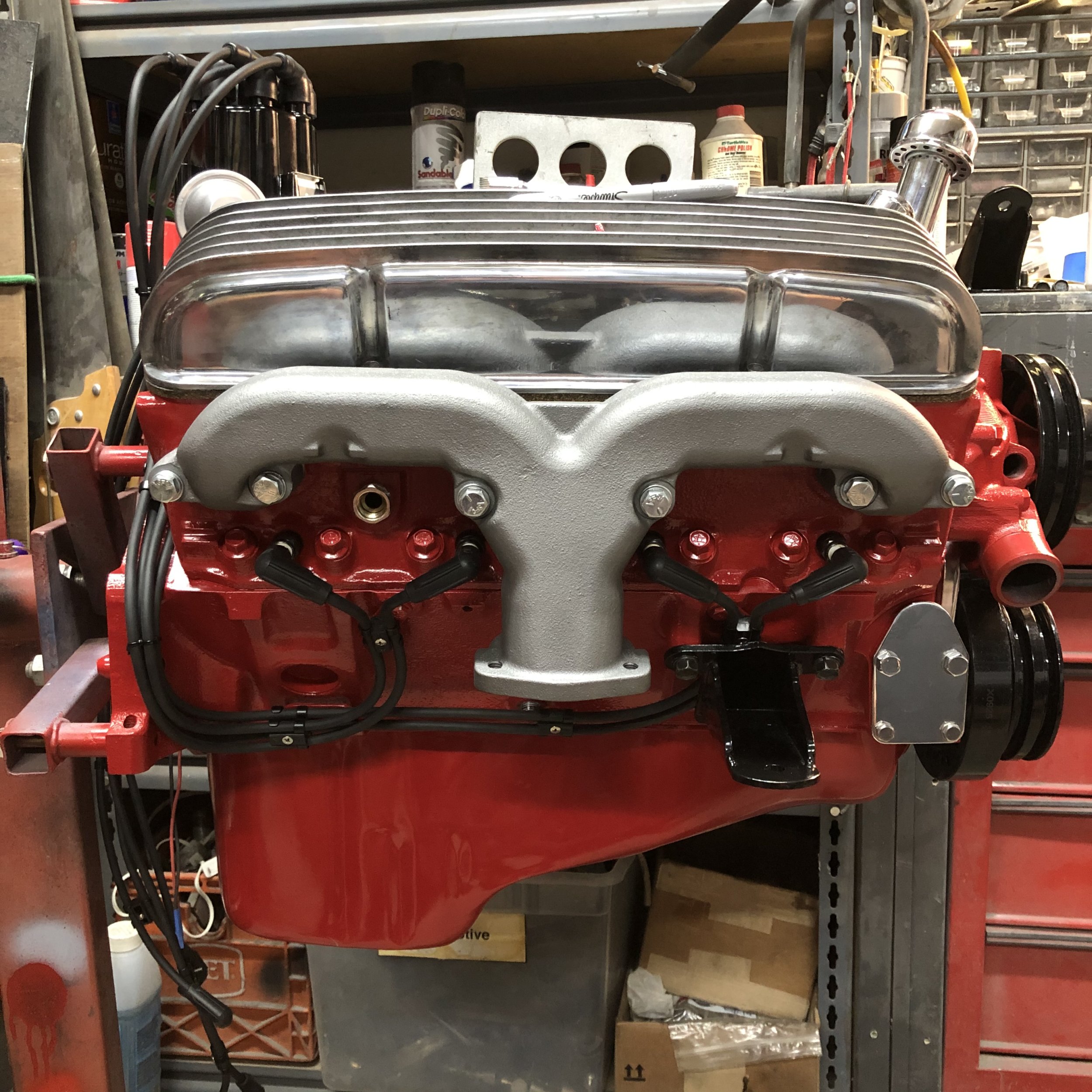

    I used 90° terminals at the cap and spark plugs and cut my wires to exact length to keep them tidy. I made some little 1/8" tabs to position the wires where I wanted them along the block and oil pan and bolted them on using existing holes in the block. I used black plastic looms from MSD to hold the wires and screw them to the tabs I made and black zip ties keep the wires separated but neat along the back of the block.

    Nice work, took some thought.

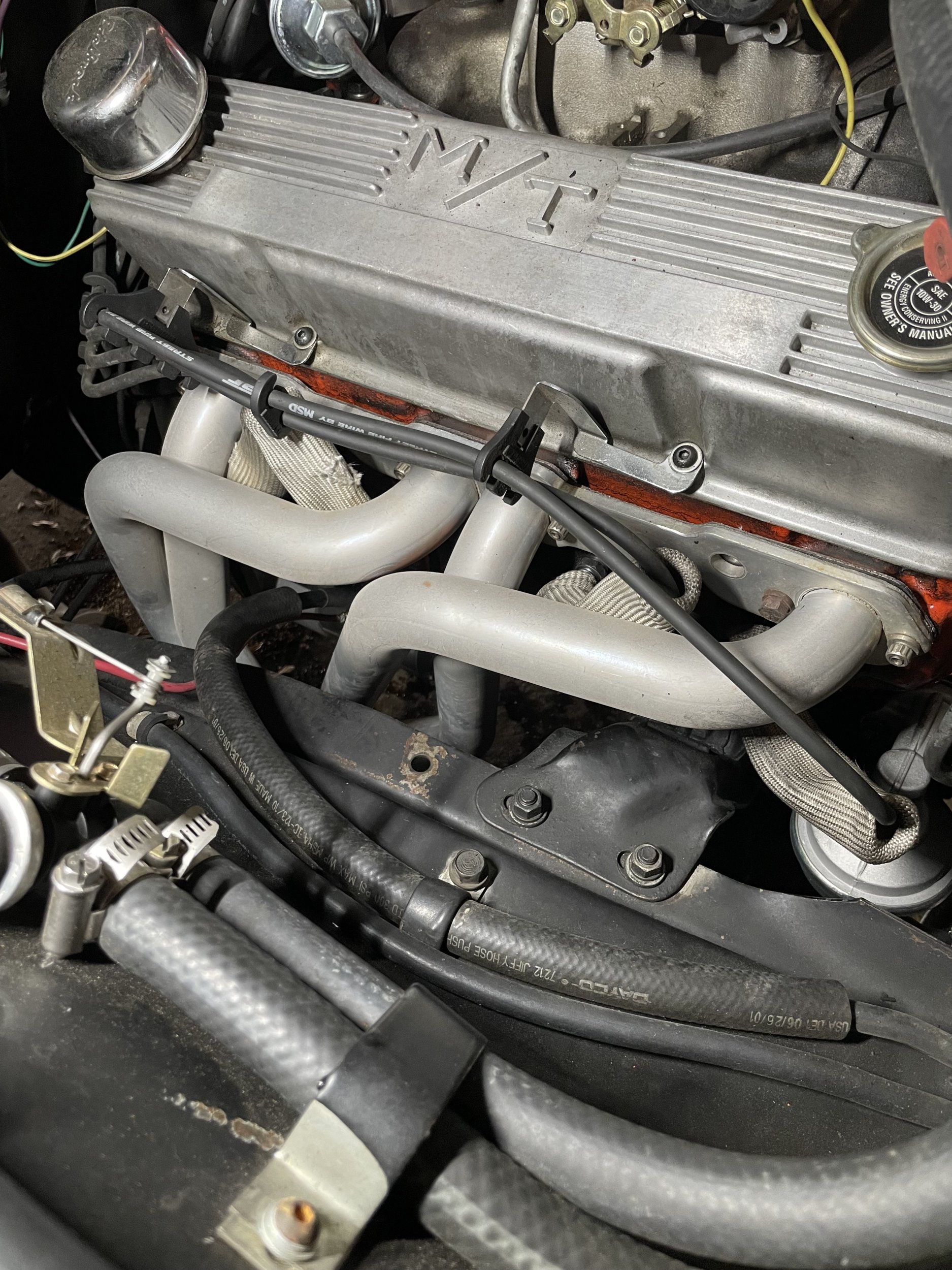

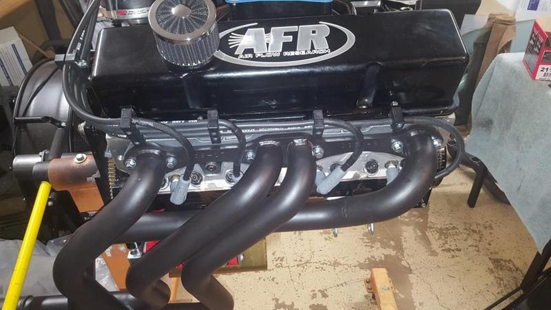

    I’ll play
    On my OT C-10 W/****** Super Comp headers. I believe they are Moroso BBC seperators. It is hard see, but I have a loose 4 wire seperator where they come off the distributor.
