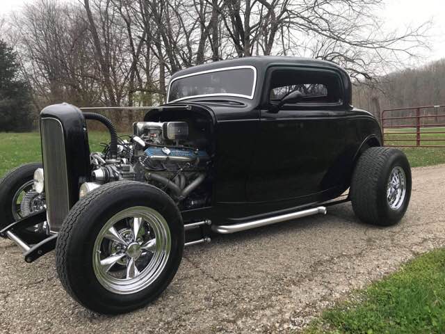

    Geez, must get a bit tired of cleaning the nose-prints off the inside of the windshield........:rolleyes::D
    Not judging, but that is a whole lotta rake.

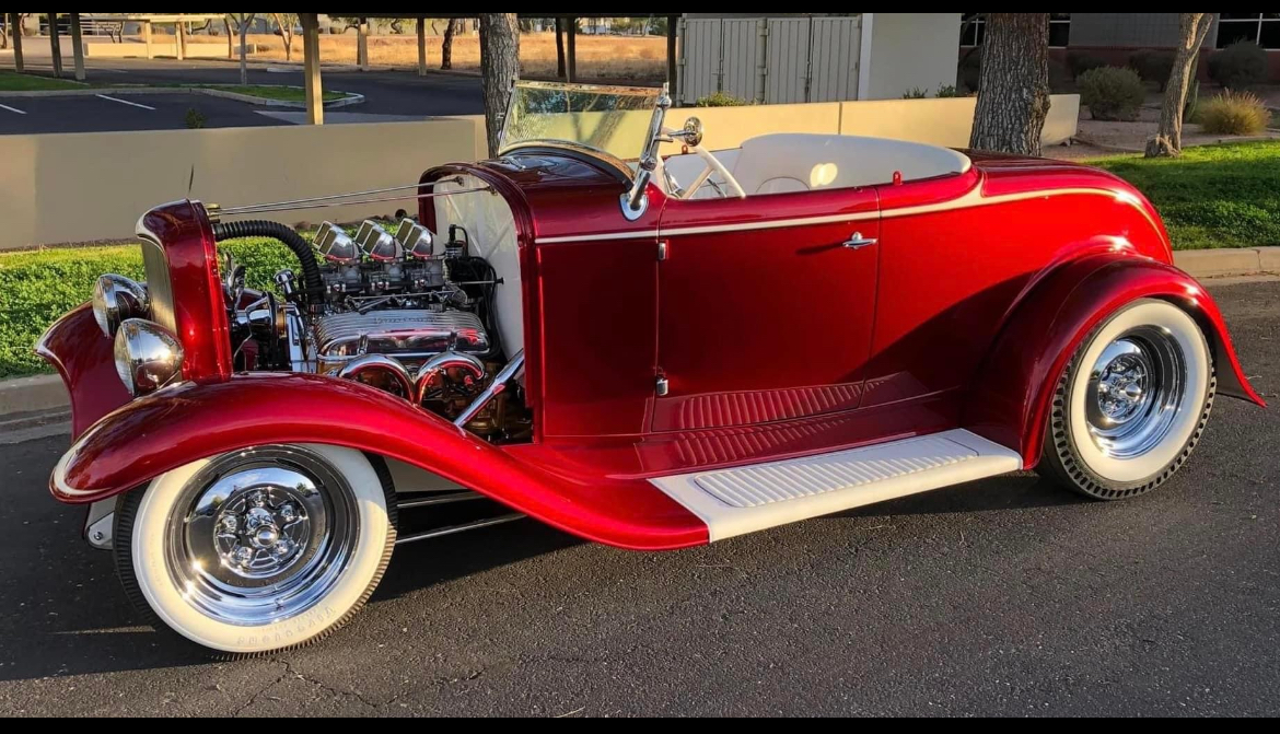

    This is a nice one, if it will fit in the trunk....

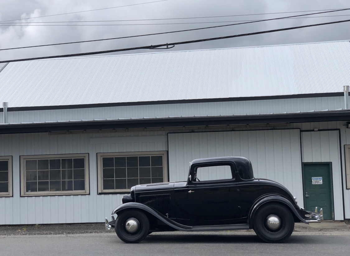

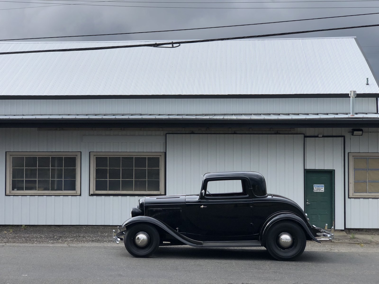

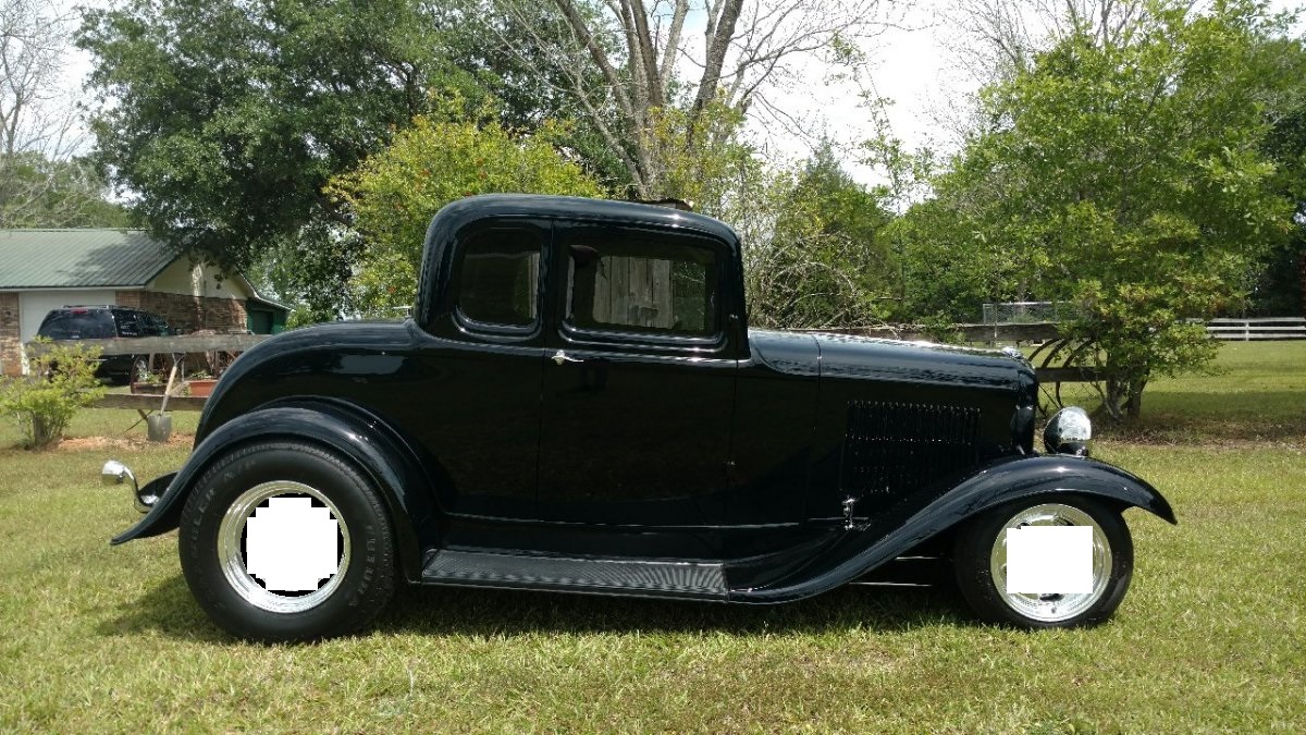

    Depends on the car. I usually like a pretty dramatic stance, lots of rake, etc. but on this one I just let the car kind of decide what it wanted and this was it:
    It has a 3” dropped axle, reverse eye spring front and rear and 5.50-16’s and 7.50-16’s. To me it looks perfect and it drives really well. I don’t have to worry about scrubbing very much, something I can’t say with any of my other cars.

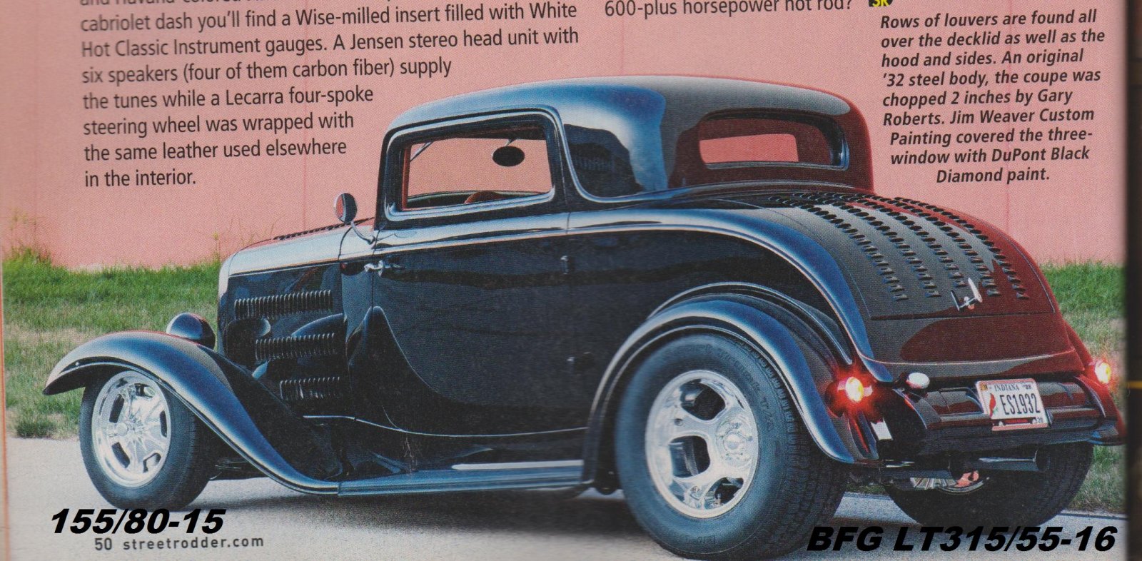

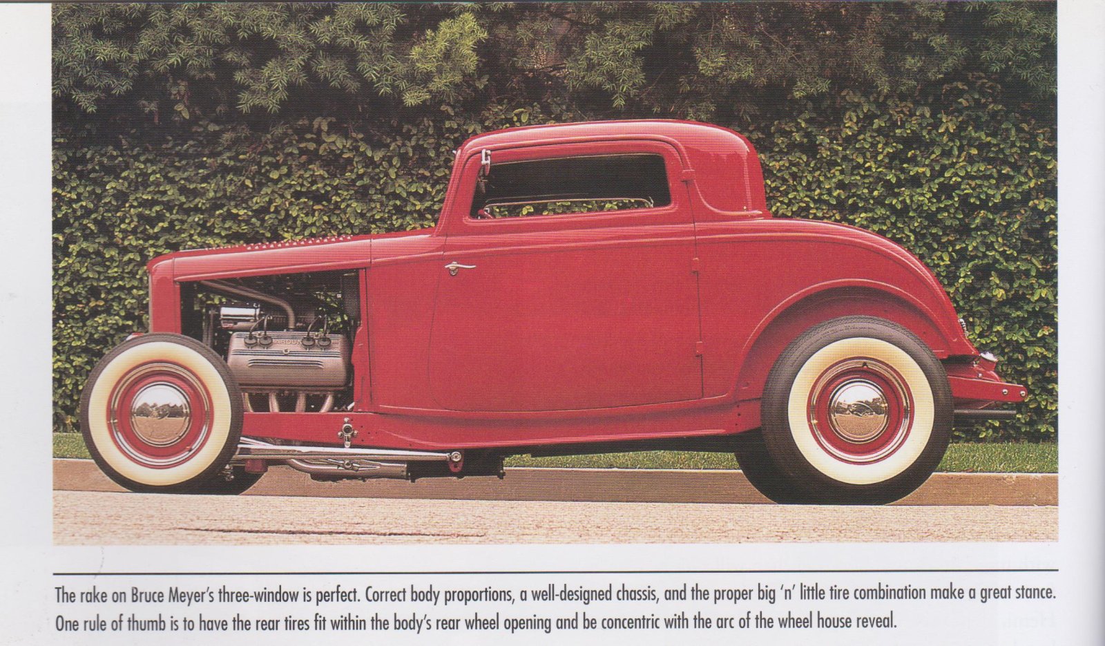

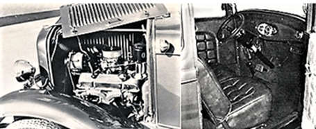

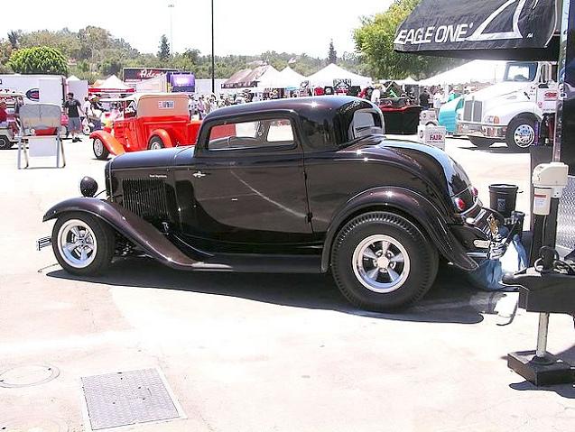

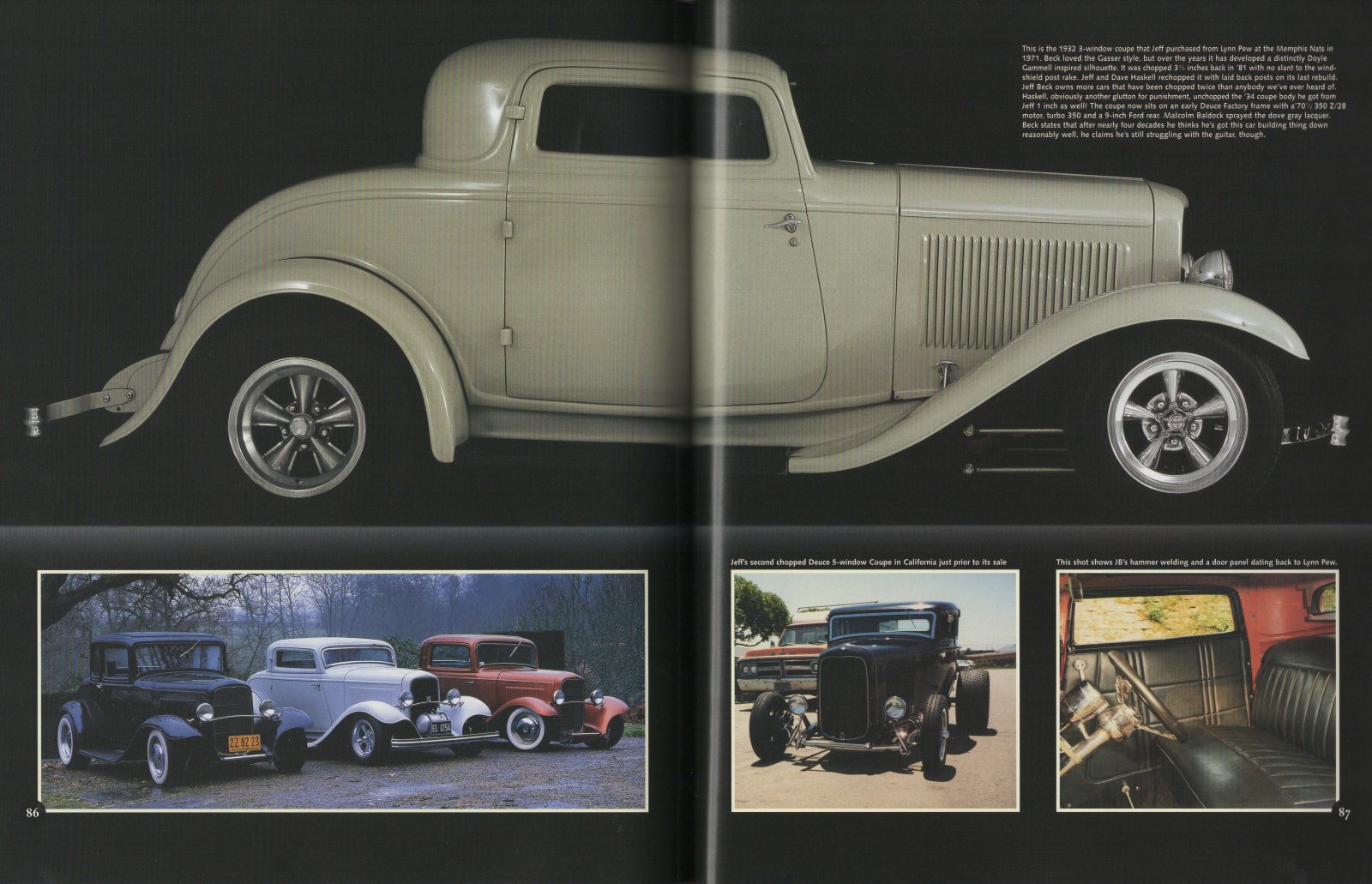

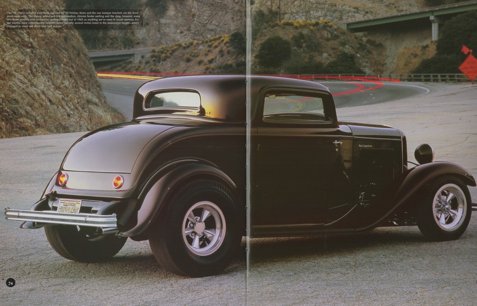

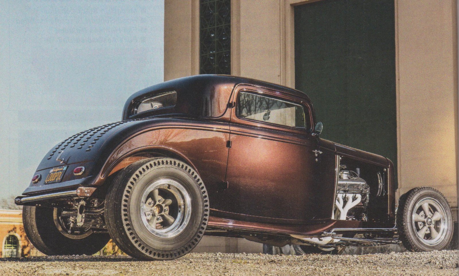

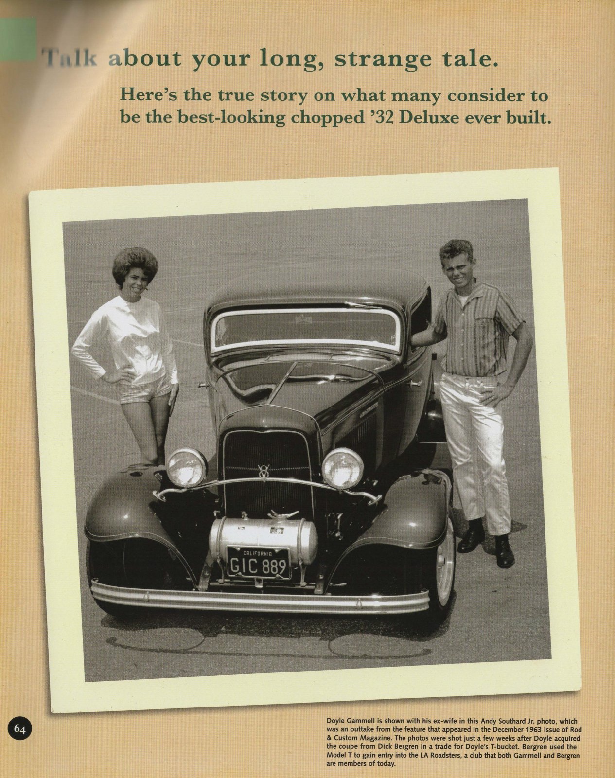

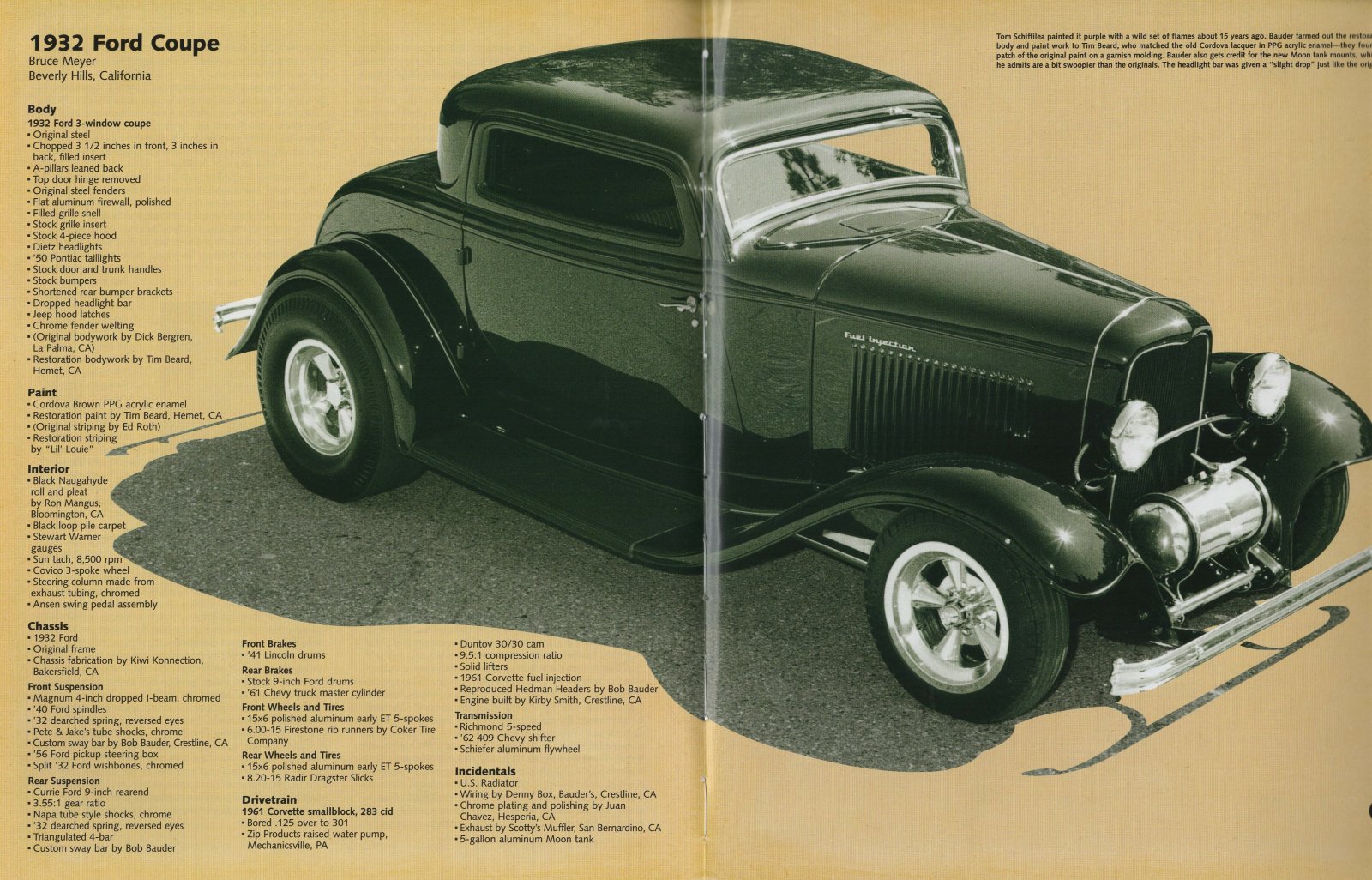

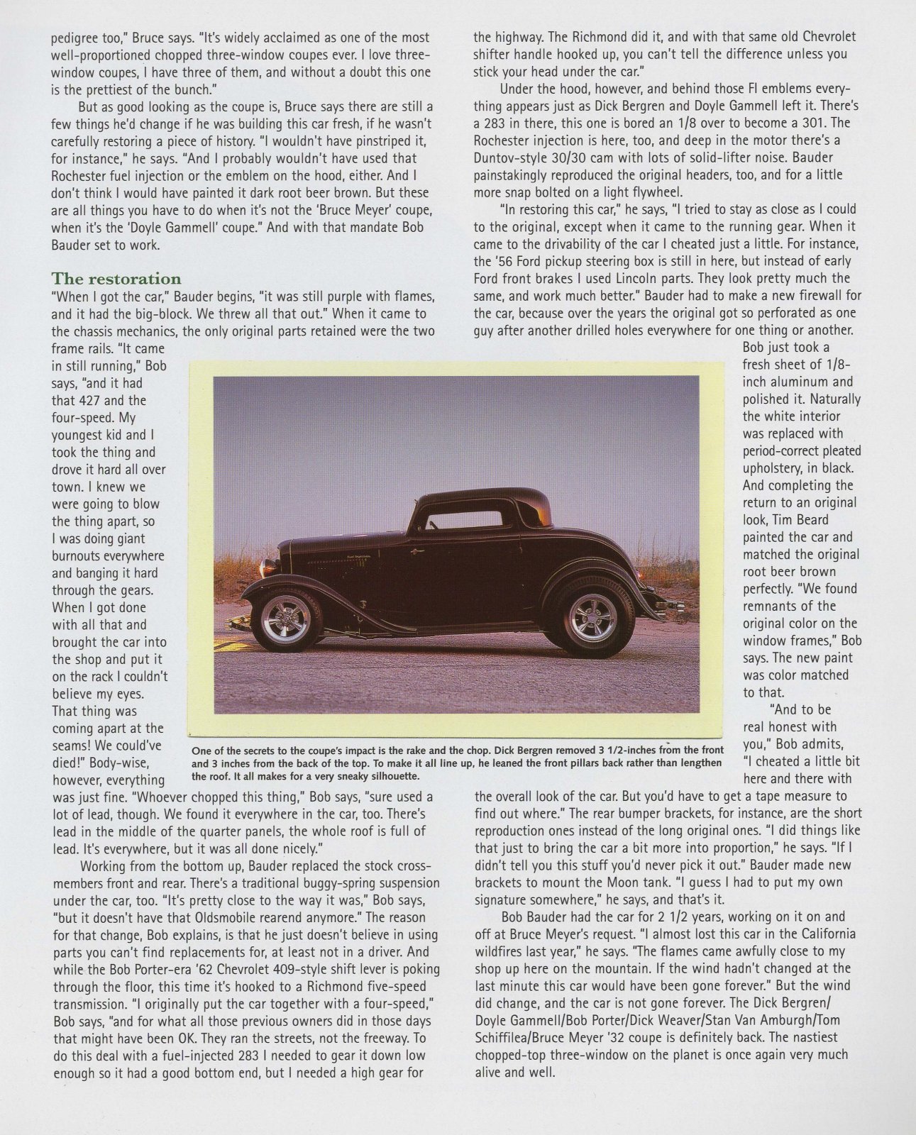

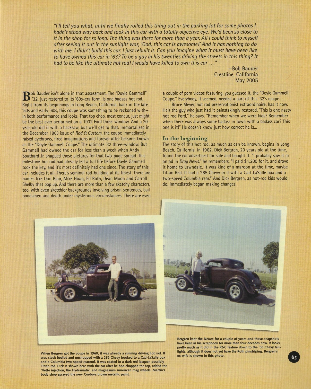

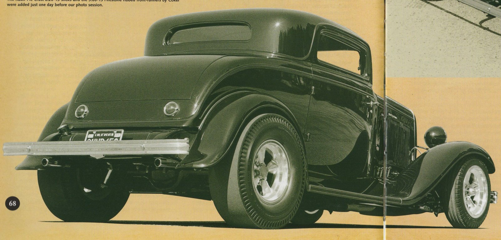

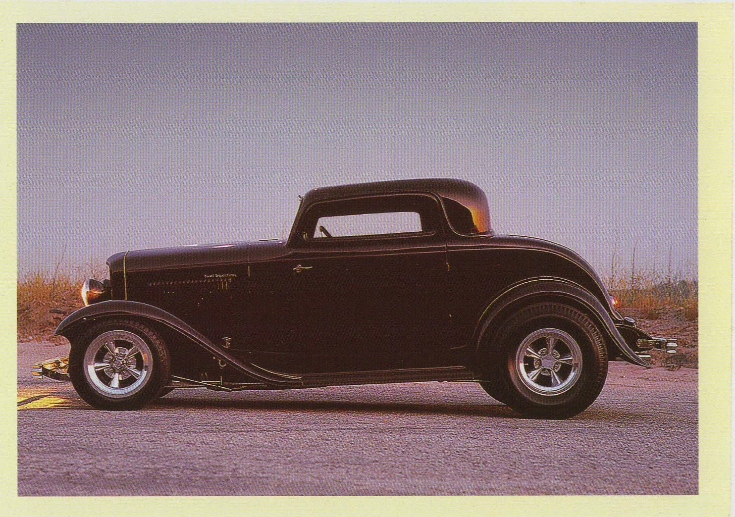

    When you start looking at what meets your idea of a proper rake, also notice how the tire sizes affect the look of the car. A front tire thats too small or a rear thats too tall can distract from the rake you choose. Also know that some people move the front axle slightly forward to center it in the fender. The wheels (IMHO) tires look best when they fill the fenders well and the rear is pretty close to the outside lip. All those factors should be considered when trying to achieve a look that you want. Here are some examples. The first one is the Doyle Gammel coupe which is a well known Icon and the top chop was done by laying the front A pillars back instead of extending the roof to keep the original A pillar angle. This coupe is considered by many to have the perfect chop..........which will also have an affect on the look of a cars rake. So lots to consider besides just the angle.
    Gammel 32 Cpe Article 2 001.jpg Gammel 32 Cpe Article 3 001.jpg Gammel 32 Cpe Article 4 001.jpg Gammel 32 Cpe Article 5 001.jpg Gammel 32 Cpe Article 6 001.jpg Gammel 32 Cpe Article 7 001.jpg
    Gammel 32 Cpe Article 8 001.jpg Gammel 32 Cpe Article 9 001.jpg Gammel 32 Cpe Article 11 001.jpg Gammel 32 Cpe Article 12 001.jpg
