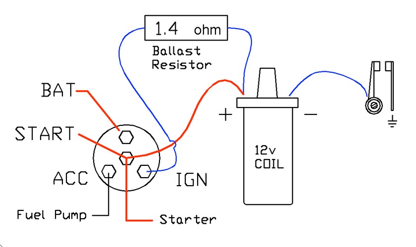

    Trying to get the 331 running.
    new;
    12v Coil (uses external resistor)
    1.4 ohm ballast resistor
    4- pos ignition sw
    points/condenser
    reman distributor
    Dwell is set to 27/29 deg
    when the switch is turned to START, the engine cranks, fires and runs, but as soon as the key is released, the engine quits suddenly.
    Is the 1.4 ohm resistor correct for the 12v coil? (it's what NAPA got for the coil)
    The Edelbrock carb doesn't seem to be the problem as the engine quits suddenly...no run-over.

    Remove the red wire from the start position to the coil. If you need the hot start like a lot of vehicles use then it needs to come off the starter solenoid terminal usually marked with an I. What is happening is that with the ignition on it is going to try to run the starter through the ballast resistor and it takes all the voltage away from the ignition or has burned out your new resistor already.
  18. The red wire tied into the coil positive to the start pole on the switch is your problem. When in the ignition position, voltage will be fed not only to the ballast then to your coil but also the starter solenoid which will be trying it's hardest to energize with reduced ballast resistor voltage, thus robbing the coil of the needed voltage during point dwell. If you need a full shot of battery voltage to the coil during cranking you need to get a 4 post stand alone starter solenoid that has a pole for a wire to the coil + marked with an "I". This will isolate that wire during normal running when the key is released from the start position.
    31Vicky with a hemi likes this.

  22. gatz
    Joined: Jun 2, 2011
    Posts: 2,326
    gatz
    and all others that pointed this out....
    That's got to be it.
    I noticed that after a few attempts at trying to start, the ballast was very hot. I know it's supposed to heat up, but it seemed too much for the short time the starter was run.
    I have looked elsewhere on the 'net and found the same reference to the solenoid having an I on it to supply the straight 12v to the coil.
    So, either I find the "I" on the solenoid or just run it without a full 12v feed at start.
    Then route a wire from the RUN terminal through the BR, then to the coil.
    BTW, I measured the ballast and it shows 1.4 ohms.
    After reading all this, I'm surprised the darn thing didn't get burned out.
    Thanks so much to all for the information and solving the problem.

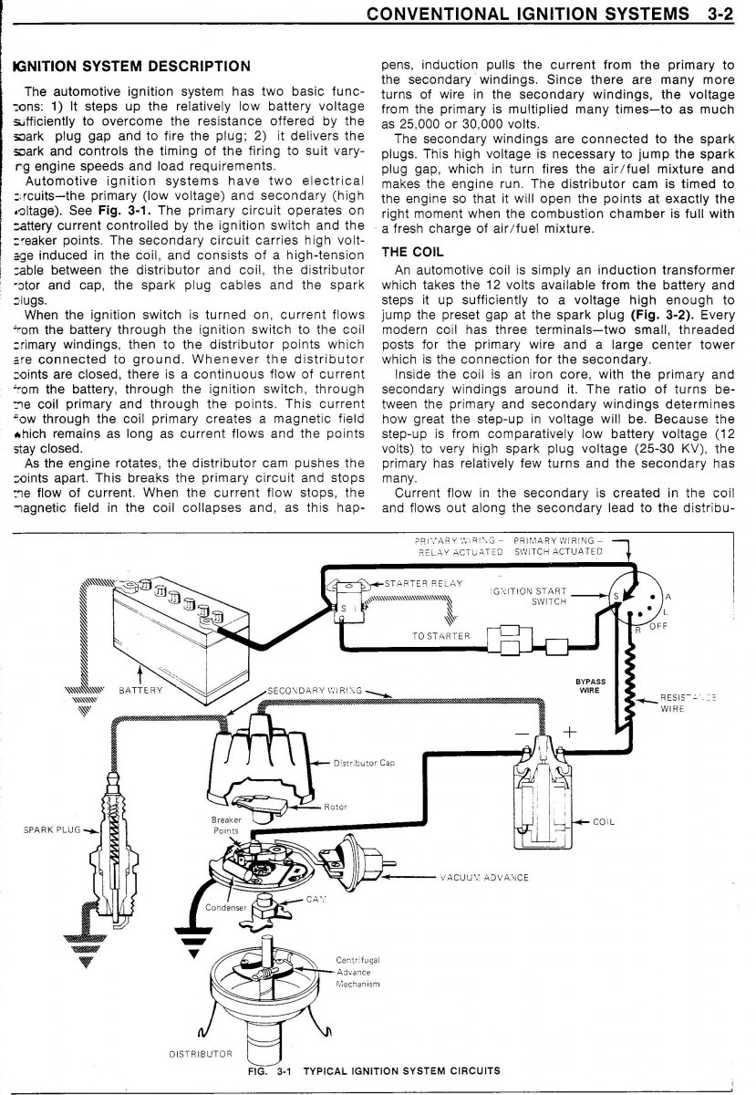

    That was the problem. Thanks to all who responded.
    Here's the diagram from Peterson's Repair Manual that was used to set this up.
    I failed to realize that there was a relay in the start circuit which would have isolated the 12v feed to the coil and prevented feedback that was trying to actuate the solenoid.
    55willys, thanks for making that clear,
    BTW there wasn't an "I" terminal on the Mopar starter solenoid.
    A standard or solid-state relay could be added if the full 12v is needed; however, the engine started and ran fine.

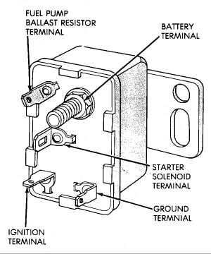

  29. Or the mopar relay
    Ground comes from NSS
