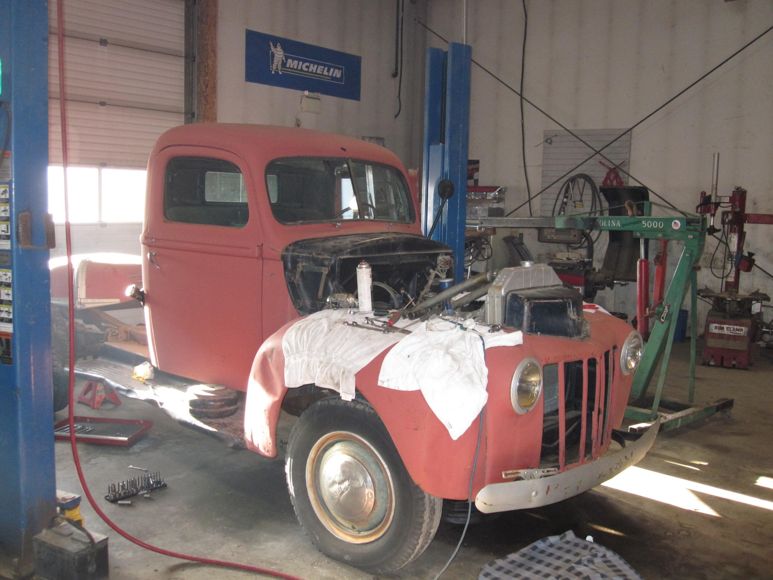

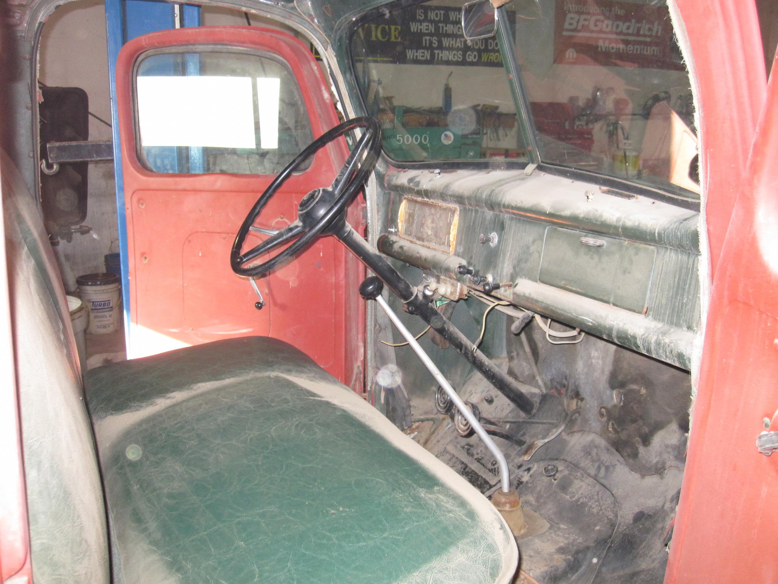

    this is the turck i got right now... so what exactly type truck is this.....and what can be done to it.. i want it lower.. how to achieve this .....i got a shop i can use ....

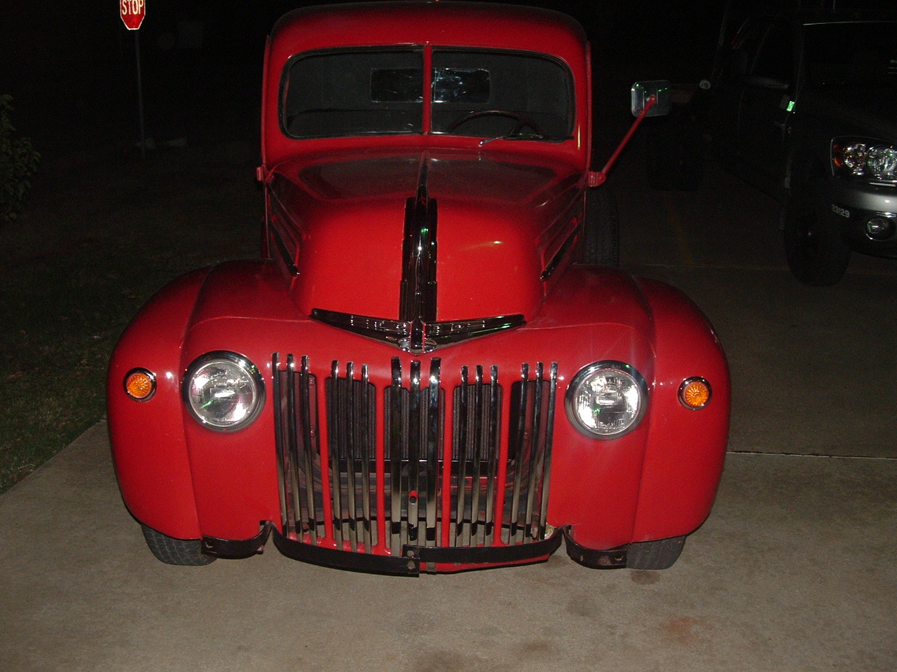

    this is my daughters 47 ford that Im building for her

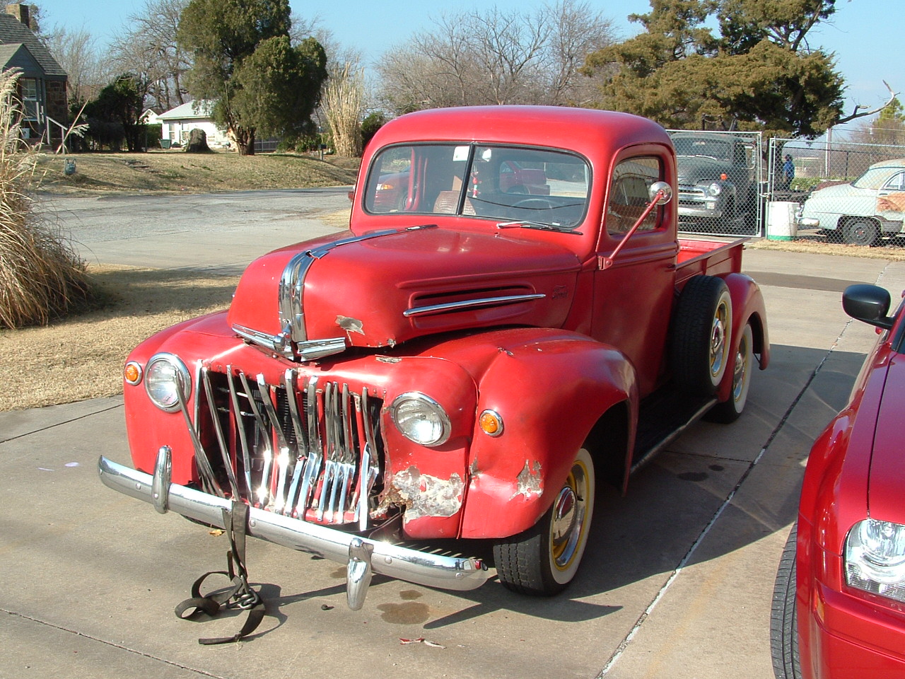

    Thanks guys. This thread is just what I needed. We had a little accident with the 46 and Sherry Pat decided that we needed to change things up a little. Your pics of the Mercury grills were just the ticket. If you know anyone with an extra for sale PM me please.

    Ouch! I looked down here in the souther half of the states for a Long time for one to no avail... Maybe some one up north can help!

    Well that's a shame, would be an even bigger shame to let Sherry Pat do that to a Merc!!

    Damn...I wish you were closer....I have a nose from a 47 that I don't know what to do with.

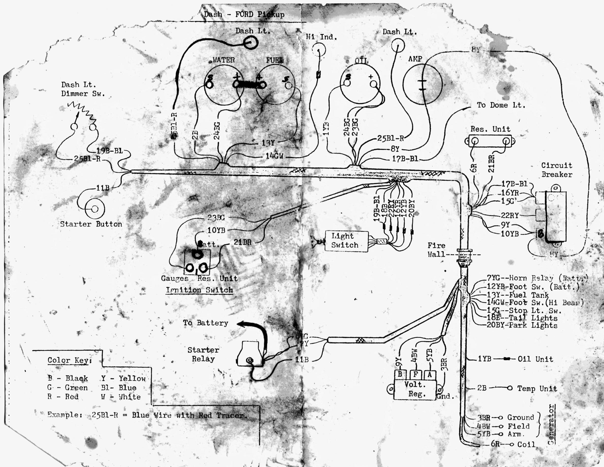

    hey guyz look what i found under the seat covered in mud....... i cleaned it up scanned it... and tried enhancing some areas.. hope this is helpfull for some people....
