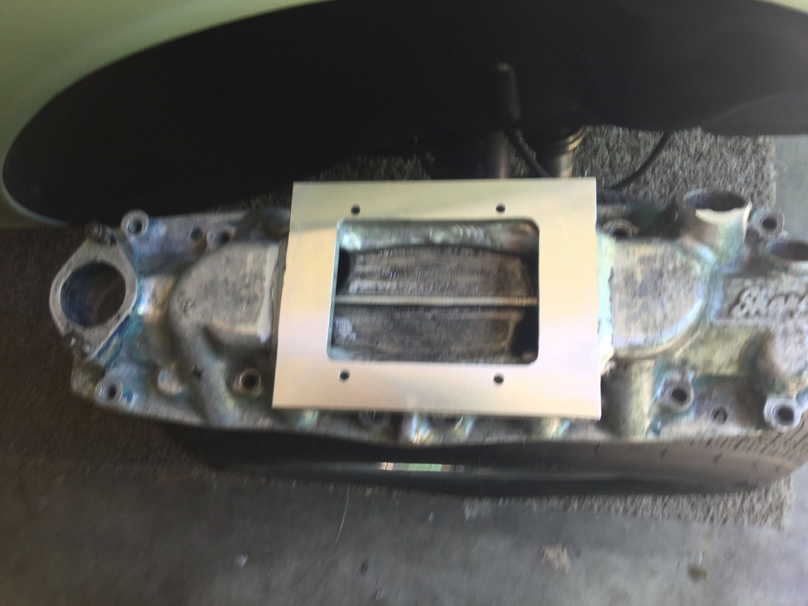

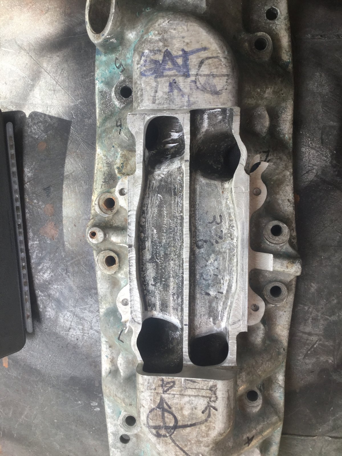

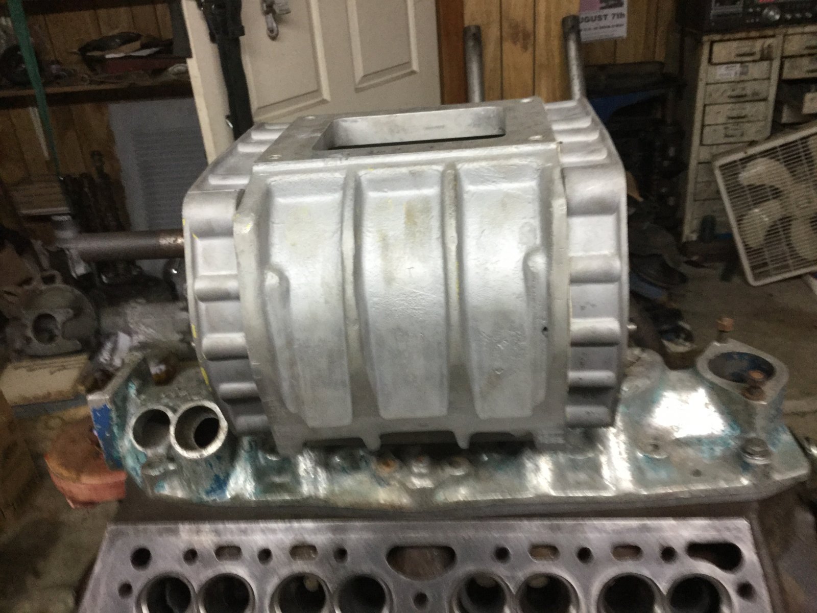

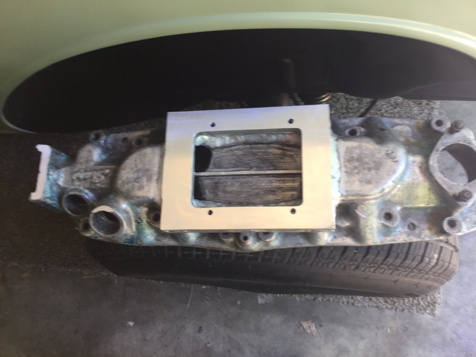

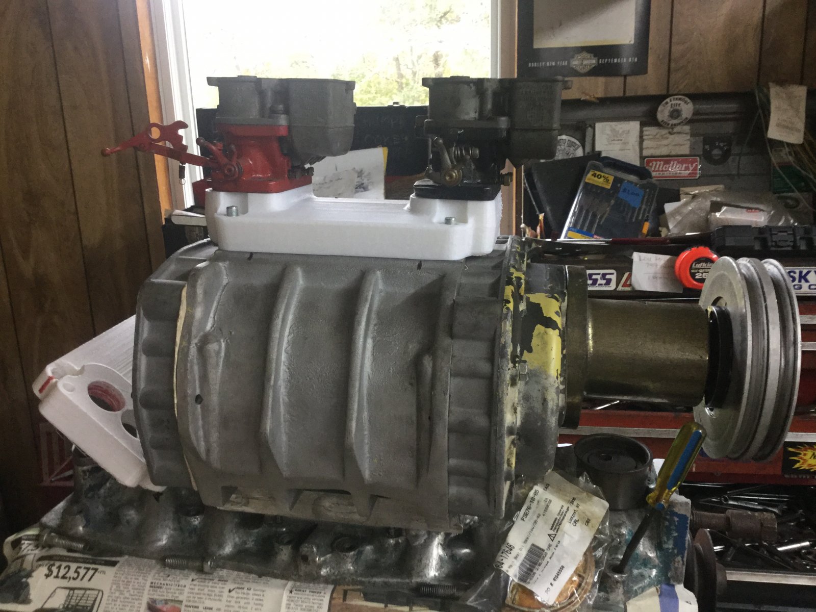

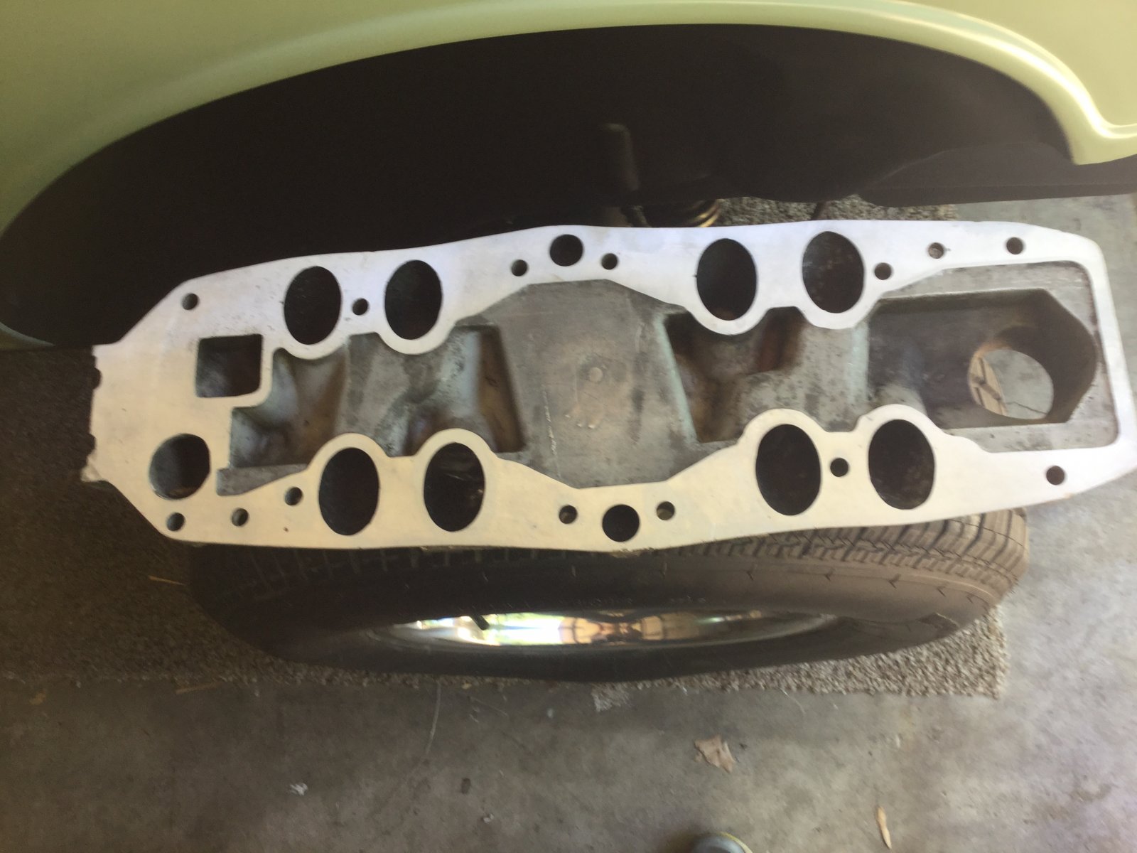

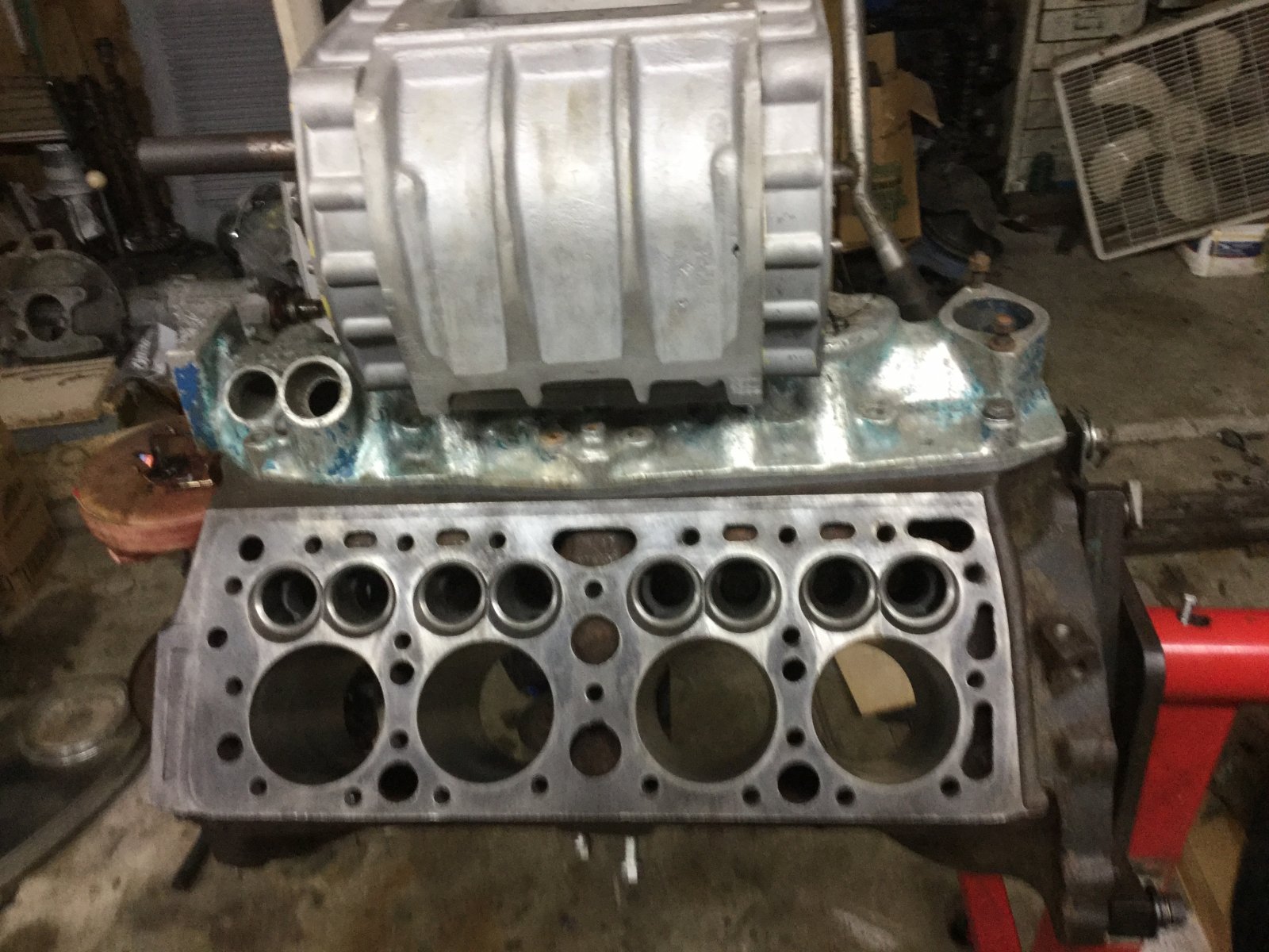

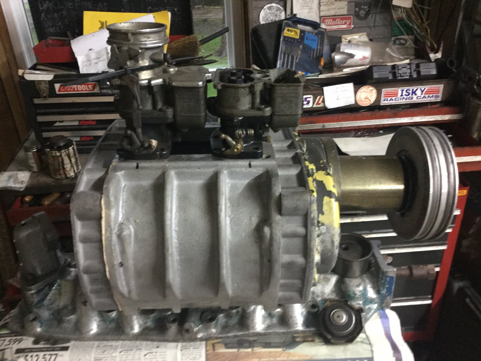

    I pruned my 3-71 because I built my own blower intake and I am a “cheap bastard” I used 4 studs with matching holes in the intake—-from what I have read the bolts only need 8-10-12 ft lbs. x. 4 studs 51BA70F5-566E-4115-A601-9F7BA9C56DC9.jpeg 789A1832-D314-4836-ABDF-1F95343BB6DB.jpeg 9E81F1D1-65A2-4ECE-B4A1-88D47731663D.jpeg 33F746EA-D0D9-4F9F-BF2D-1F1EB44BC168.jpeg 573C1B29-F860-4237-B08A-CA9A1D7E9F0F.jpeg BE50625B-8EB6-4412-BF2F-26F30E812C22.jpeg DF2ED3EE-7FA7-4413-B150-9B3BF5B2F639.jpeg 7612C6D1-50E5-4F2F-A1A6-492CA096FFFA.jpeg

    Correct and on a flathead like mine, the pruned blower aesthetically is a lot tidier, doesn't interfere with water necks (it gets close in there) and I can remove the intake without unbolting the blower. I am not positive if that would be possible otherwise.
