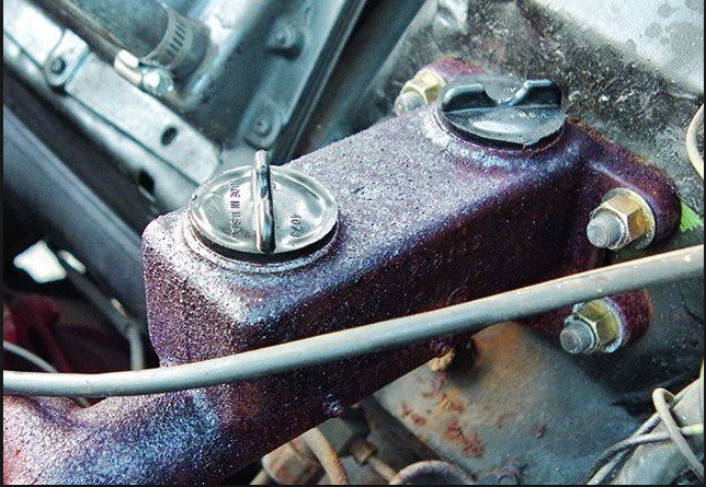

  17. It is 12 (1962) years too new but why not use the Rambler master cylinder.
    KustomKreeps, squirrel and scotty t like this.
  18. If you could replace the plastic caps that would be a great choice
