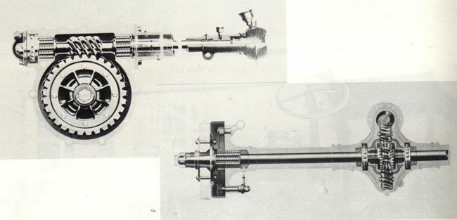

    Saw this axle that was made into a trailer. Does anyone know what it is?

    It's a model TT truck axle...

    Could be as late as Model "A-A" truck : the worm drive was used up until early '29. If you can see the driveshaft stub inside the torque tube, a square end would be "T-T", a splined end would be "A-A". The "T-T" would have 6 bolt hubs, the "A-A" would have 5 studs
