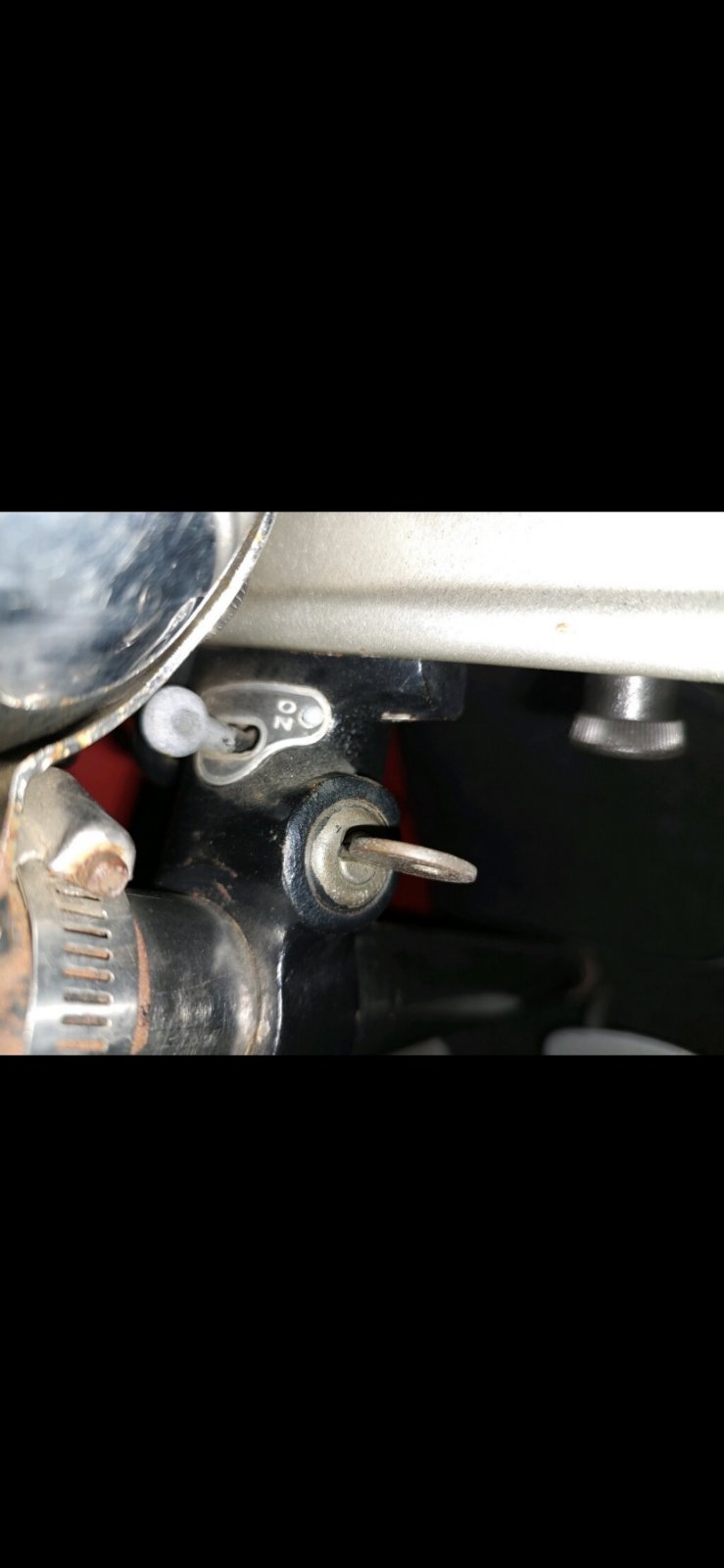

    Just picked up this coupe and and found this gizmo for a steering column stand...its keyed and the key rotates no problem, but not sure what the heck its for....any ideas? 6FBEA358-25FA-4A44-A4B3-F8F180FE8945.jpeg 8B945F4F-4149-4FAA-A059-BBEAC822997C.jpeg 1A1706FA-1A05-493D-A24C-605EC436B293.jpeg

  3. badshifter
    Joined: Apr 28, 2006
    Posts: 3,607
    badshifter
    The original ignition switch lock and in some cases a column lock.

  6. jaracer
    Joined: Oct 4, 2008
    Posts: 2,936
    jaracer
    It is part of the original ignition system. First you had to turn the key to unlock the column and allow you to turn the ignition switch to the ON position. Then you pressed the starter button to start the engine.

  12. deucemac
    Joined: Aug 31, 2008
    Posts: 1,637
    deucemac
    It's what Ford called a "coincidental" lock. Meaning you unlocked the steering, coincidentally unlocking the ignition switch.

    Joined: Oct 25, 2014
    Posts: 4,223
    rusty valley
    originally those Ford locking switches locked into a sleeve that is slid over the steering shaft , held on by a couple set screws, with a notch in it to stop the steering when its locked. You have not told the whole story for us, but if its all 32 column, or built from bits from various years, and it does not lock, they have eliminated the sleeve on the shaft, or maybe even the pin in the mechanism

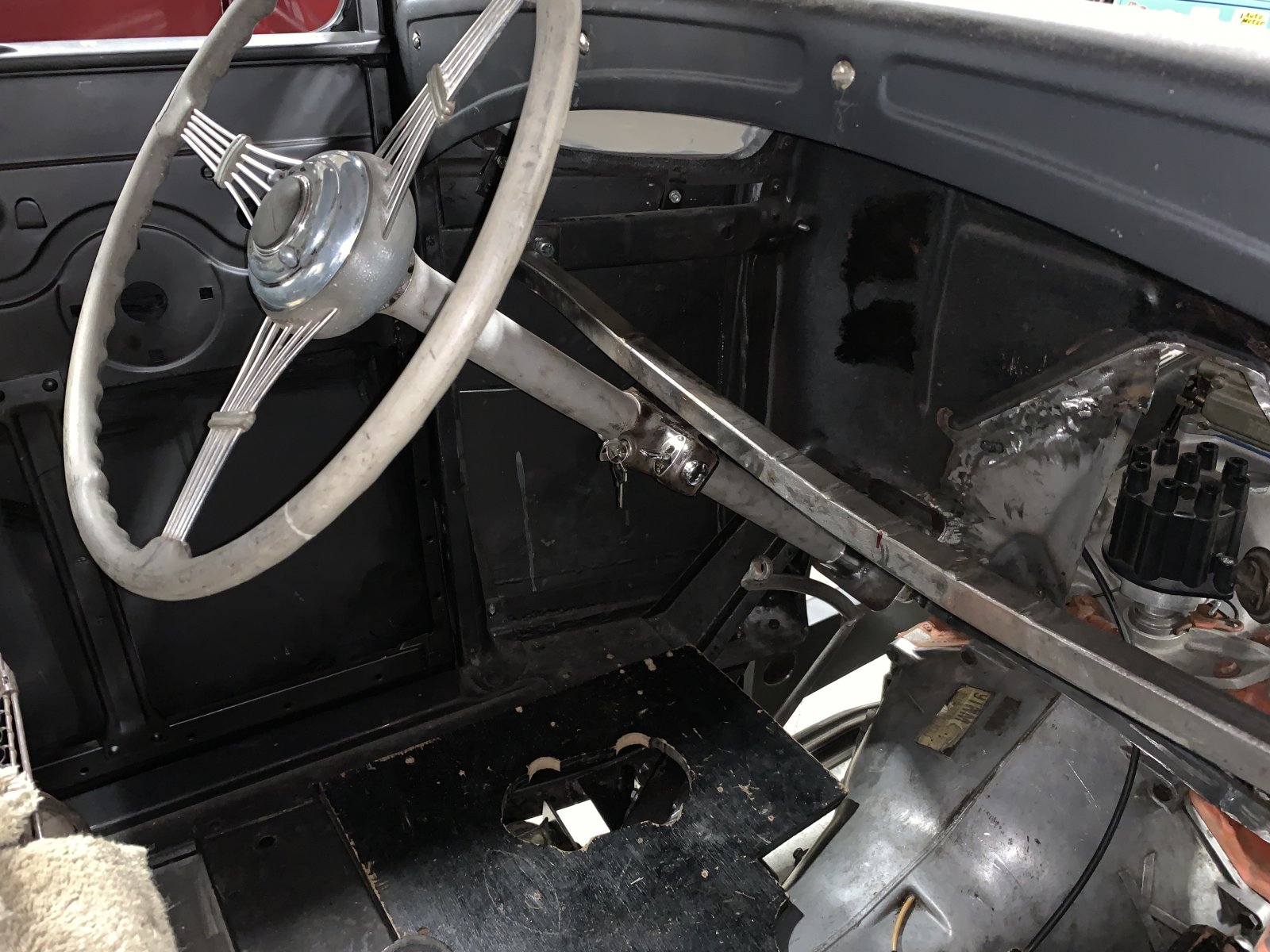

  19. 31Apickup
    Joined: Nov 8, 2005
    Posts: 3,586
    31Apickup
    F10A149E-423B-44F5-A2A3-BEE06E9E15E7.jpeg I’m using a 40 Ford switch in my 31 coupe build. Wanted to maintain an old style look.

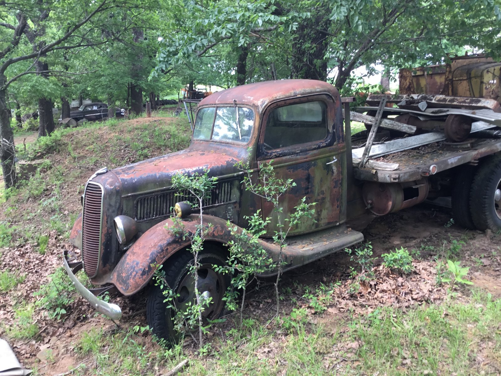

  20. Boneyard51
    Joined: Dec 10, 2017
    Posts: 6,754
    Boneyard51
    This truck has a similar set up!1937 model! 0D92F746-815C-4E52-8A1A-74F336D0A13A.jpeg
