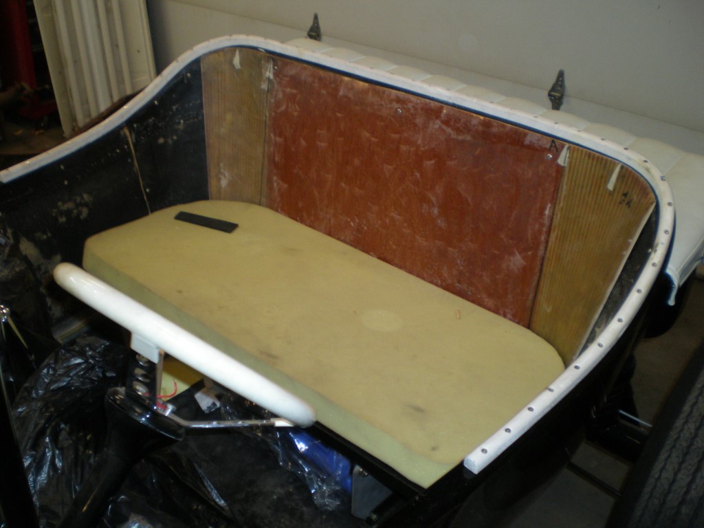

  10. If you can't find the plastic tack strip in the size you need; you can use "vinyl wood" trim boards from a home store and rip them to the desired size on a table saw. Since they are white; I give them a coat of flat black paint just in case an edge or something shows.
    Picture of a strip I cut for my coupe. A couple screws replaced missing bend-over tabs. The material is pretty flexible for curves and a heat gun can help it conform to tighter curves like the strip on my old roadster in the second picture.
