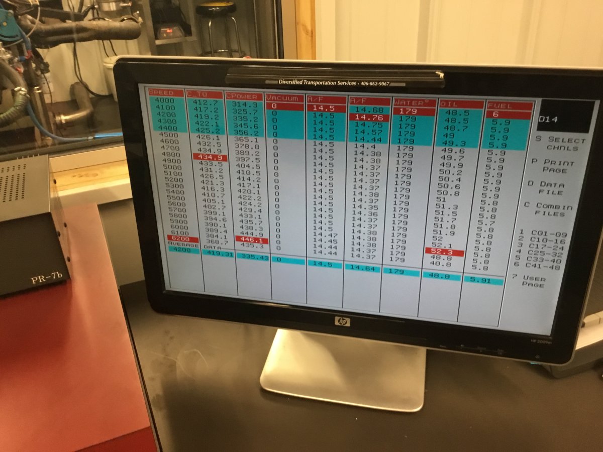

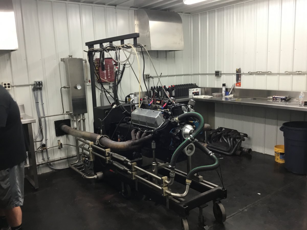

    B7BC323C-C568-48A3-AD52-78682314AC21.jpeg 90095CAB-567C-44DD-BF4E-E0BB6D160666.jpeg I got to play on a dyno a couple of weeks ago.....for the first time! It was awesome!
    pitman and Bandit Billy like this.
