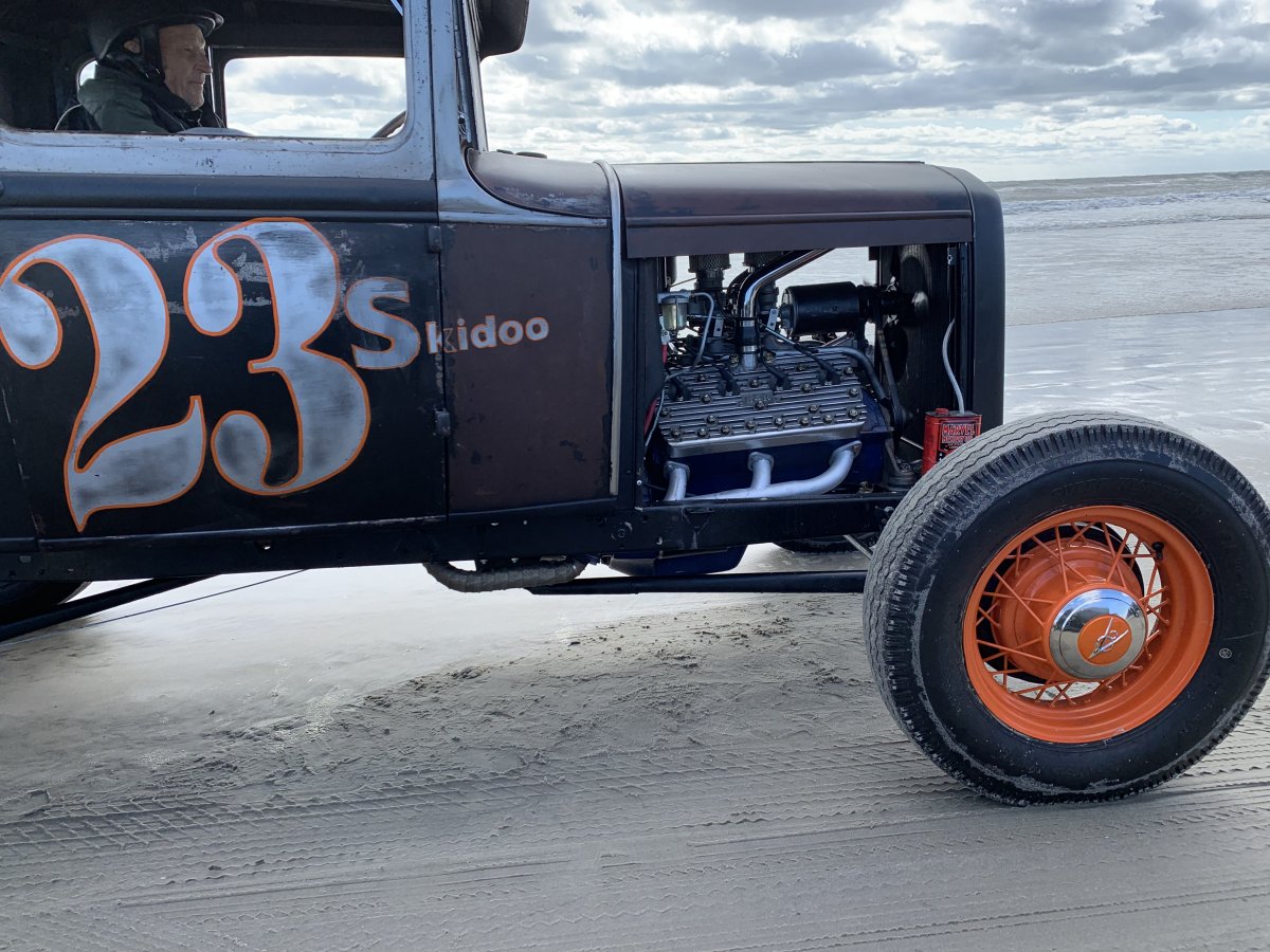

  15. Pothole
    Joined: Dec 14, 2017
    Posts: 81
    Pothole
    Thanks for the pics and yes it was a fantastic weekend.
