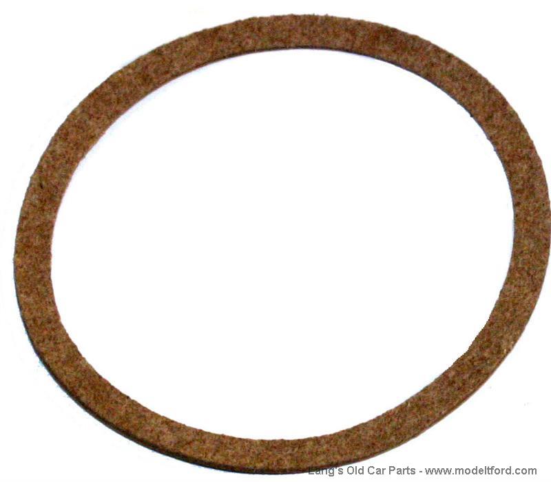

  21. Gas Cap Gasket
    Item Number: 2901G
    Per Car: 1
    Year: 1909-1927
    Condition: New
    Price: $0.40 each
    dan c and tb33anda3rd like this.
