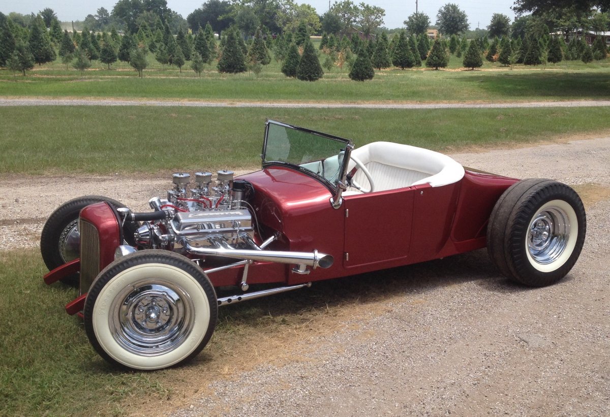

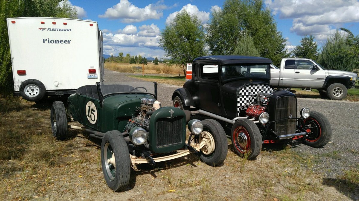

    My Roadster is channeled enough to cover the model A frame and windshield chopped 4". I am very comfortable in it! IMG_0582.JPG

    That t roadster is just cool. My 27 is also channeled over the a rails. I drive it everywhere.

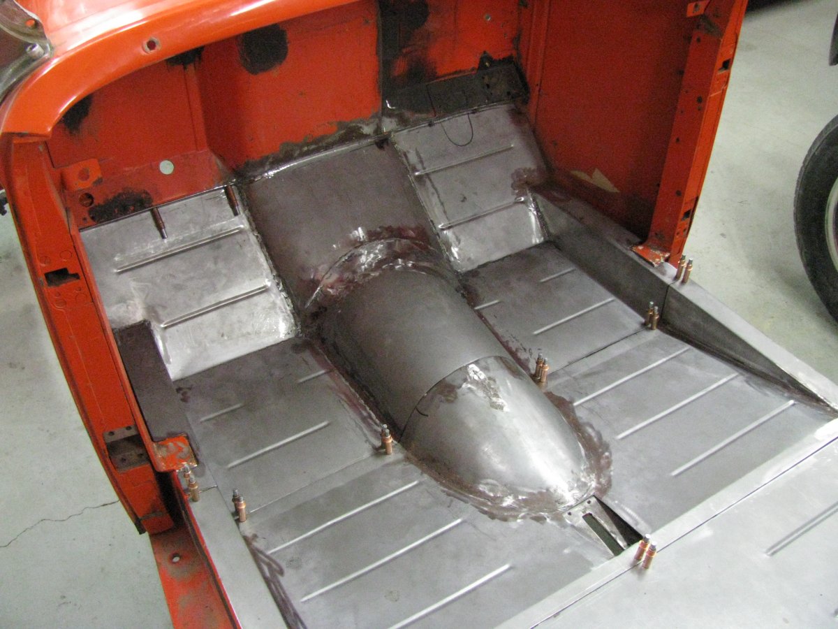

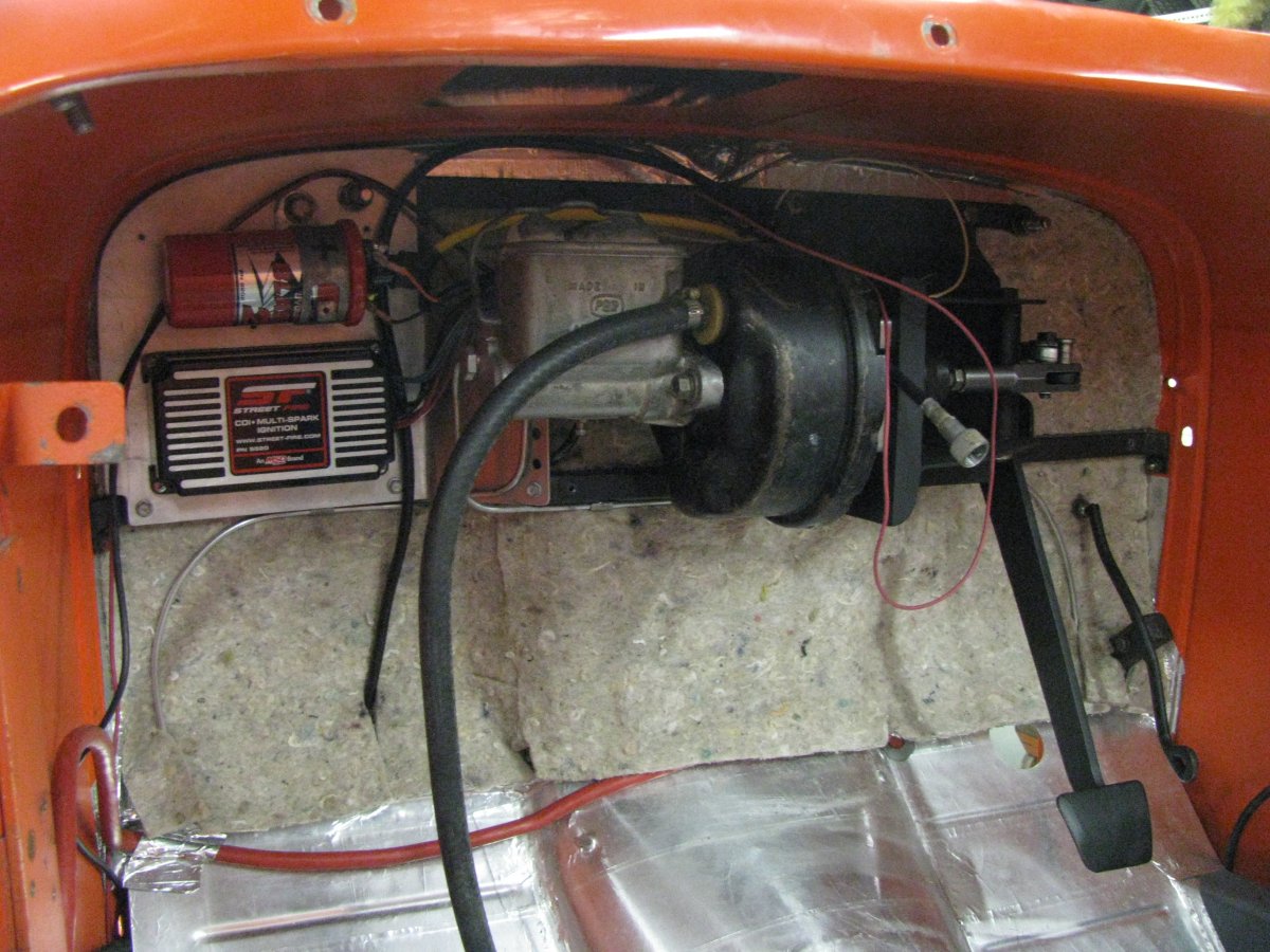

    I'm 6'3 and a bit, and it's surprising what a bit of creative floor work can achieve. IMG_2179.JPG

    Robracer, I really like your floor. Good job!

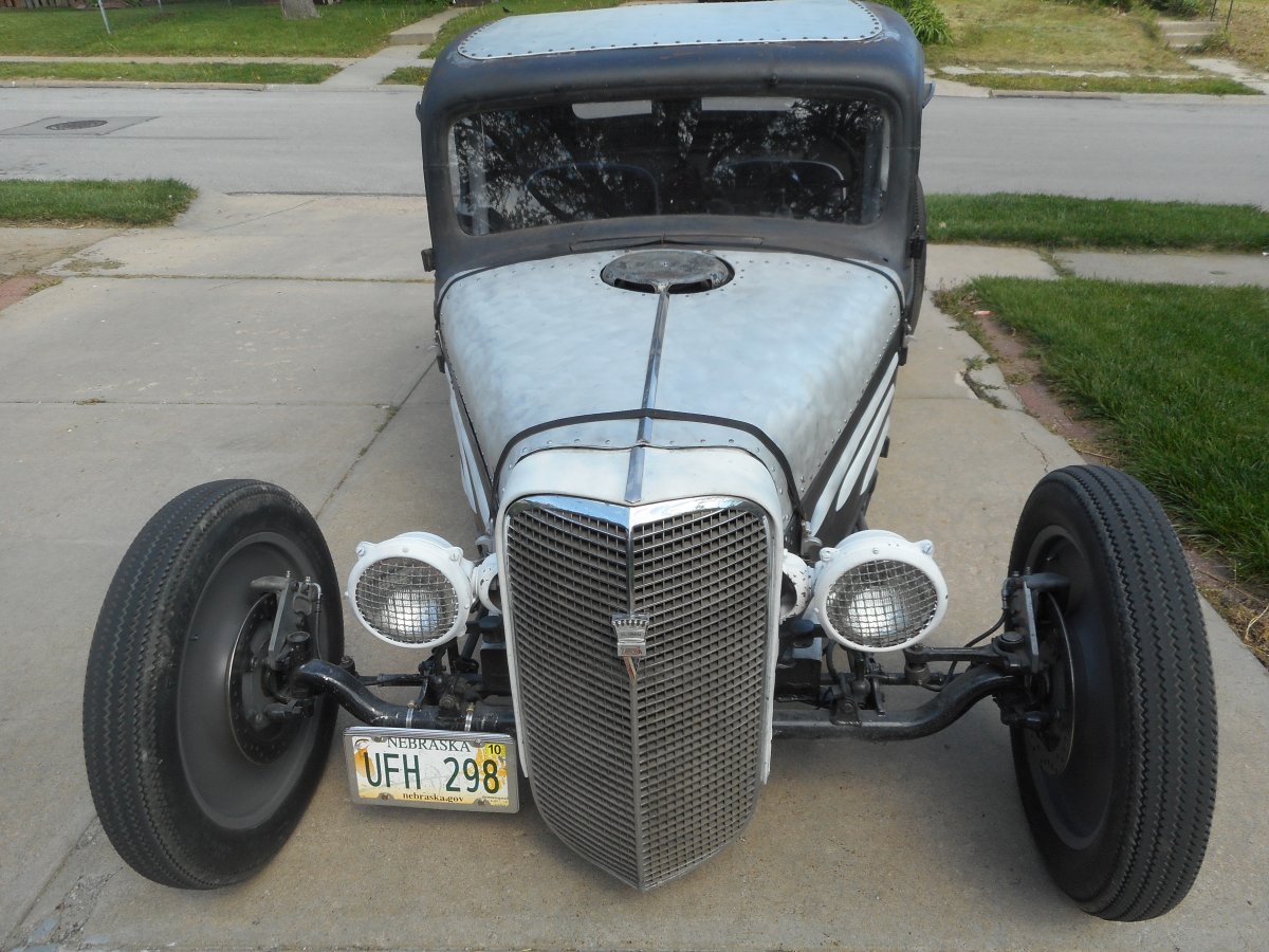

    As little as I like shoved-forward radiators, I love the shrink-wrapped thing this one has going on. Zagato couldn't have done it better.
    Jet96 likes this.
  11. LOL that radiator is not shoved forward the rest of the car is shoved back. :D :D :D

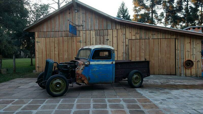

    I like channeled cars when they look right (by that i mean a moderate channel, not an "omg the frame rails are coming out from the middle of the firewall" channel)
    as for Comfort like was said before it all depends on what car you are channeling and your size, i'm 1.86 m (about 6' 1"), and i fell uncomfortable in a stock Model A, a channeled one would be horrible, but i feel just right in my truck (not finished if anyone is wondering)
    in my case i channeled the cab of the truck for a couple of reasons, one being that the cab (Ford FK) is way wider on the back in relation to the front, and it would simply look weird if the cab was on top of the frame.

    That Red t roadster is just about perfect!

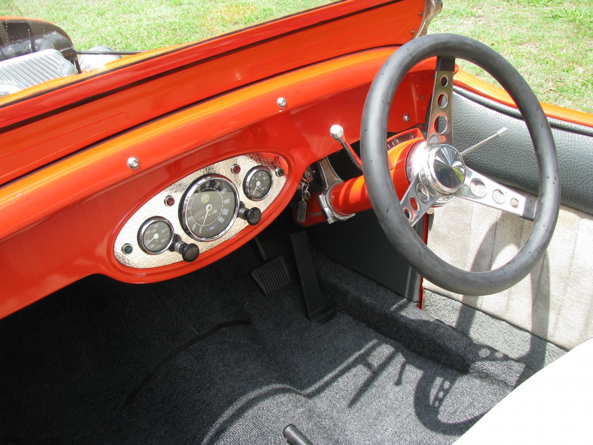

    Thanks guys, This pic was taken a couple of years ago during rebuild number ? Owned the car for nearly 20 years with the flat floor and as I get older I don't bend in the middle like I used to. Yes it was a lot of work - moving brakes, new pedals etc, but well worth the effort. I am way too big for the car, I still feel like I sit "on" it, not "in" it, but it's ours and we love it. IMG_2296.JPG IMG_2342.JPG 12646642_1261248483890800_8082169372567773853_o.jpg

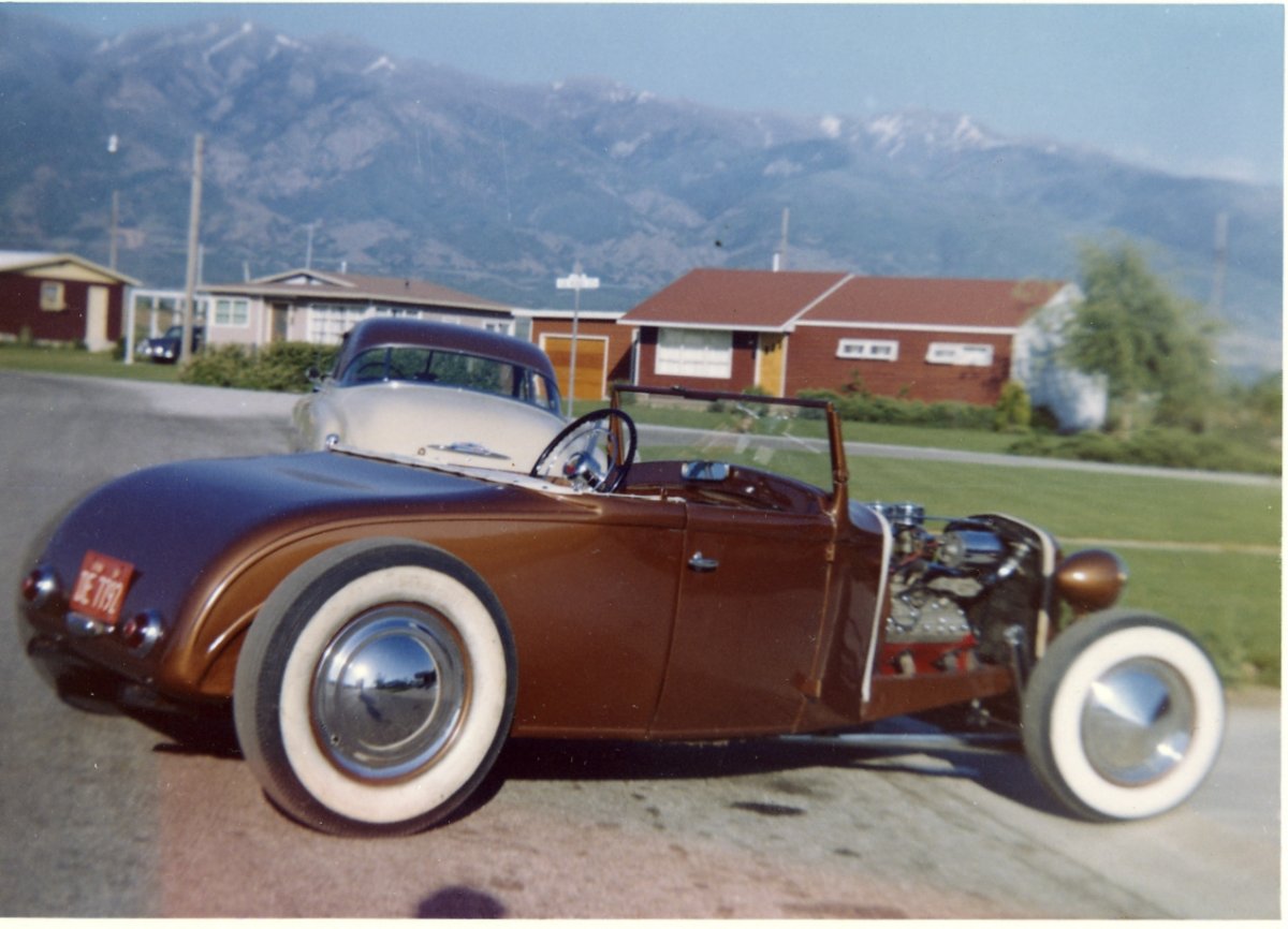

    SouthBeachArtDeco2.jpg I like channedled,but if not carefully fitted can be small. My own rod,built in 1959 is 28 A roadster body,bob tailed,dropped over frame about 6in. at the firewall but only 3in. at the bobtail. I cut off nearly 3in. of rusted out bottom edge an truned under 3/4in. before even mounting body to make a lip as finished body bottom. Floor is at top of frame ,seat is 2in off floor at front only and an zero at back with 3.5in. of foam. I do put in new foam each time I redo upholstery. I'm 6' an,was in highschool too an its always been good fit. As I'm now a ugly old coot,here's a photo with better stuff seated in my rod .
    Most complants I hear or read are about fit of driver,I understand it,but also know it's a matter of builders engineering skills,too make the fit right.
    Too often I have see things done wrong an then a statemint that"There is no way for a channedled an or chopped car to be EZ to drive"= is BS,its about planning an fit,plus not over doing ether.

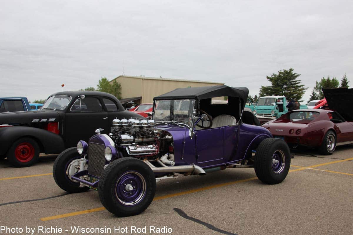

    IMG_1386.JPG This just showed up today. Love this car. True 70s build, and a heavy channel.

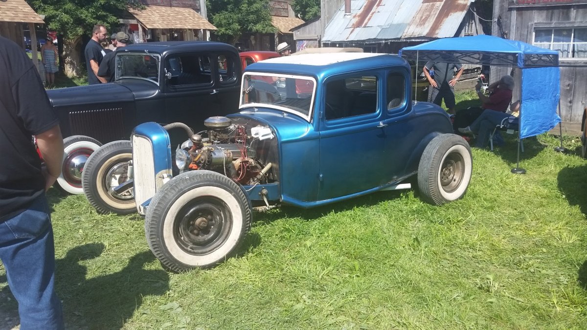

    Here ya go, from the Jalopy Jam Up in 2016, one beauty of a survivor as well. Don't know the front to back channel proportions but it sure looks like the body has a rake in relation to the frame..
