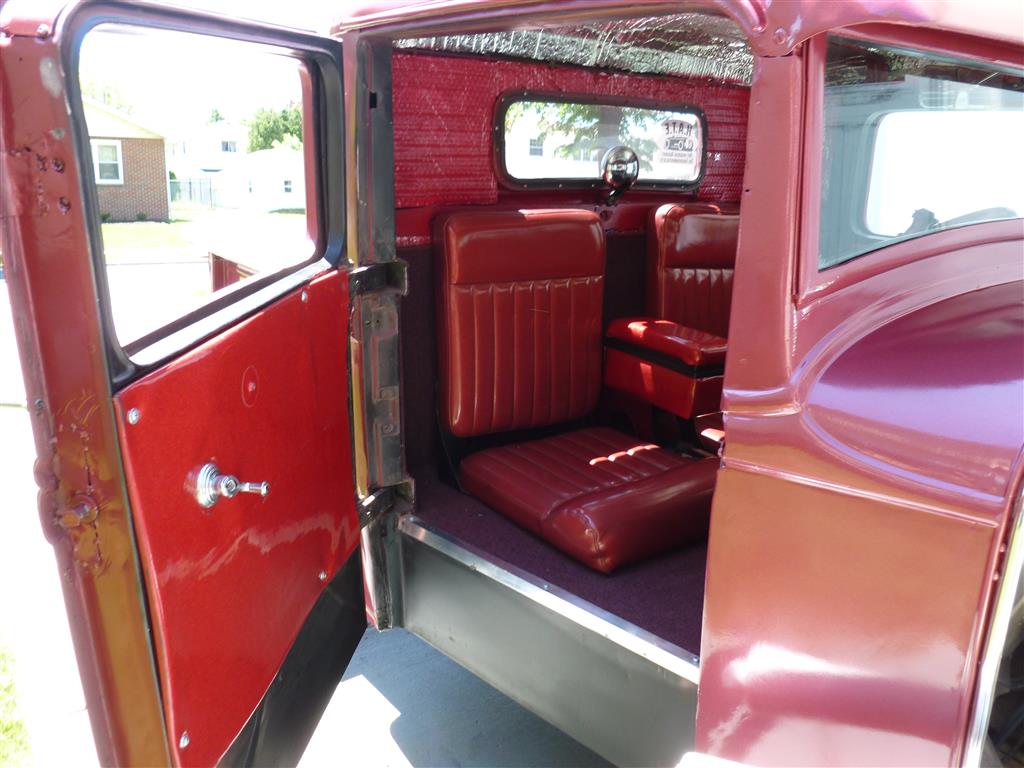

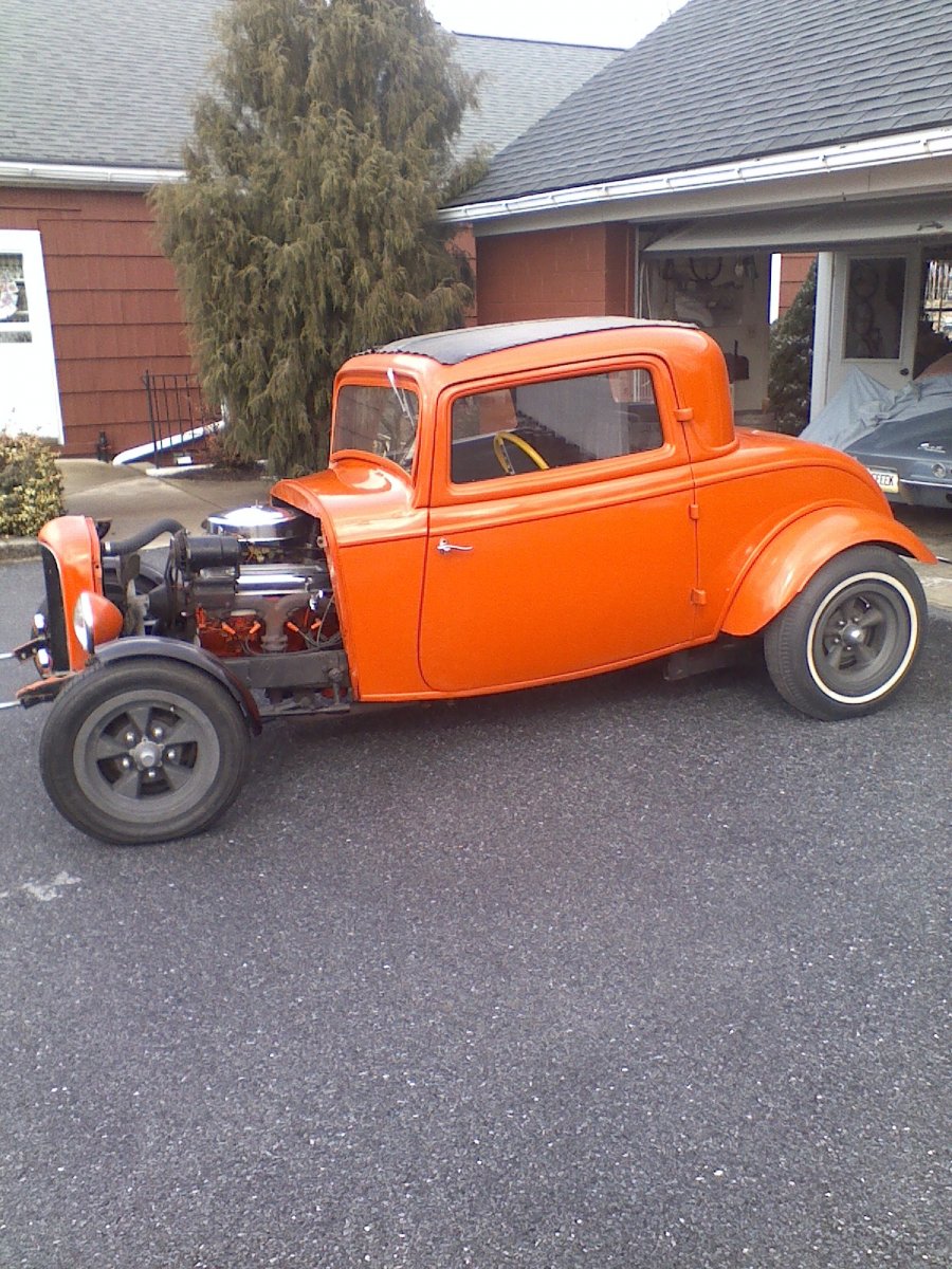

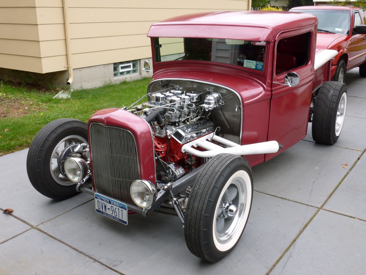

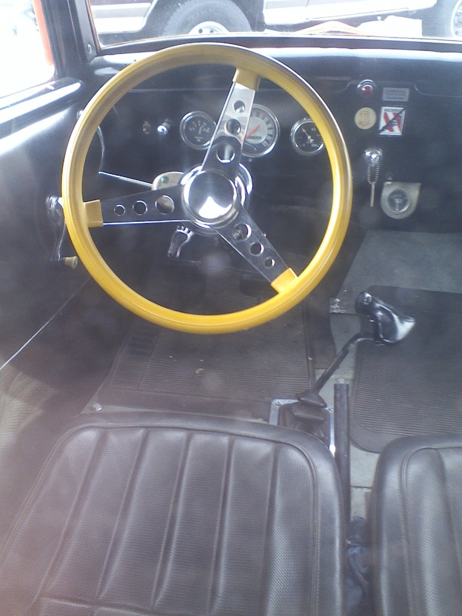

    At one point , someone mentioned there is no advantage gained by channeling... how about the lowered center of gravity? Comfort is a matter of using the right seats...Vette buckets work great! Long live channel rods!! 5AA0B843-A312-4BF6-96FD-0F21F344A04F.jpeg 9F6C8704-8FD6-46E9-9C9A-01751221C770.jpeg B1BE2736-CCC8-4766-89DD-6F47378C2CB8.jpeg 10498B9F-988E-4FD7-81BD-D1633B910ACC.jpeg 0B57335B-4F9B-4EEE-BB08-9524925BE7EF.jpeg

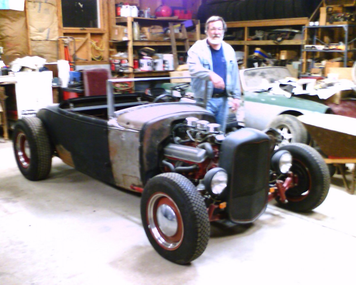

    When I bought my roadster project car it was channeled quite a bit and with me being 6 foot tall it was going to be a little tight. Channeled cars pose a few problems such as windshield height, pedal location, steering wheel etc.. I had a 312 with a tri power intake and went to mock it up and found the carbs blocked my vision out the windshield due to the channel. Still, I always liked the channeled hot rod look so if I can ever get my *** in gear after this covid thing my rod 19.jpg I can actually start digging out all the parts I've squirreled away and see it through.

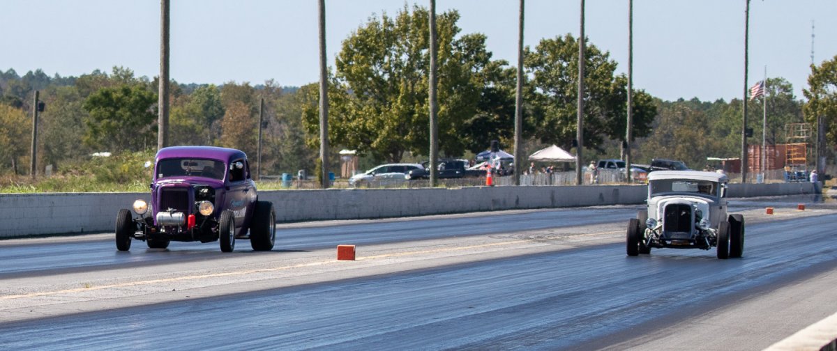

    4" chop, 4" channel and a 4" engine recess with the seats pushed all the way back. It's a tight fit for anyone over 5'9", but the CG is low, frontal area is reduced and weight distribution is near 50/50.
