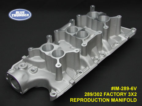

    How many of you have sent your letters to santa?
    I sent mine off the other day, and I asked for this,,
    and the carbs to match. Does he still listen if your over 40?:D
