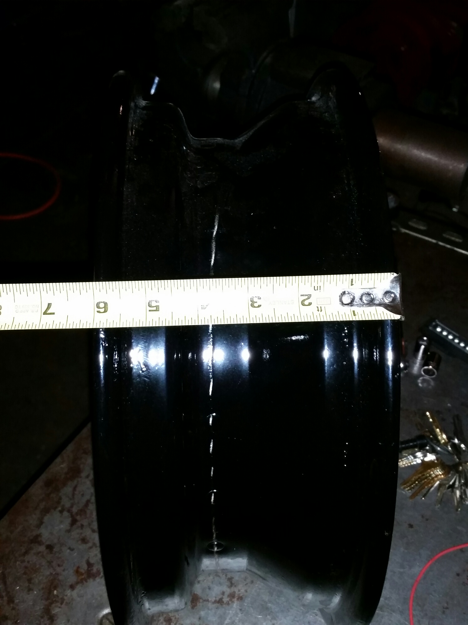

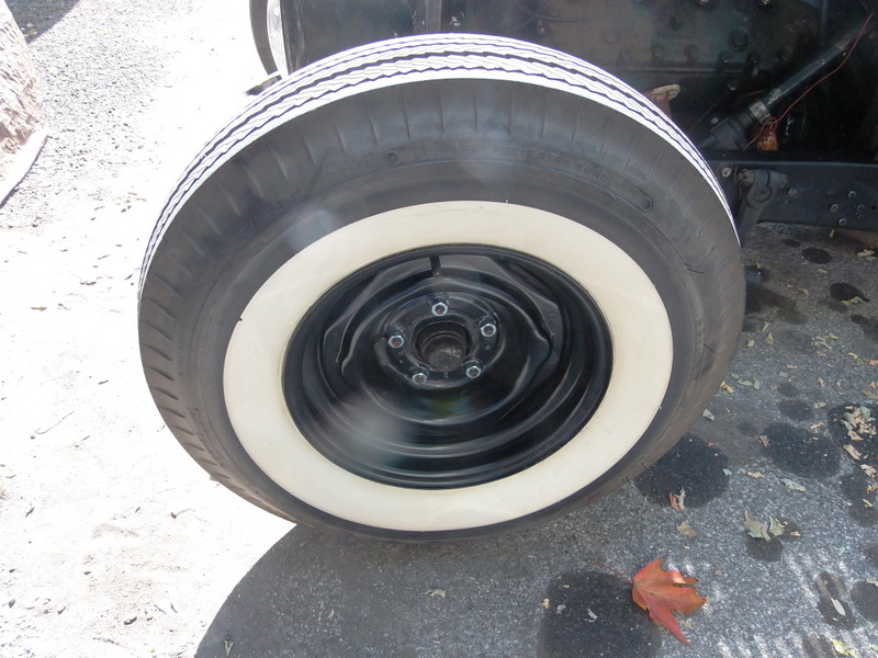

    Hey guys. I have a quick and maybe dumb question. I am putting Firestone bias ply wide whitewalls on my 1957 Chevy truck and I am measuring the wheels and I can't tell if these are 5 inch wide or 5 1/2 inch wide. The rears are def wider than the fronts. I think these are the original wheels that came on the truck. Does anyone know if they were staggered sizes like that and what the size really is? I know it sounds lame but I can't tell if these are 5 inch wide fronts and 5 1/2 rears or 5 1/2 fronts and 6 inch rears. Any thoughts? ANother Hamber is rock this setup...

    What would these tire sizes look like on my wheels? Any suggestions? I know it's hard to tell in the photos but the rears are def about 1/2 inch wider than the fronts. Thanks

    I can't be a lot of help with this question but you don't measure a rim from outside,the 2nd photo is the correct way. HRP

    Old chevy trucks came with the same wheels front and back. They get replaced as the years go by.
    as he said, you measure width inside the flange.

    Like HRP said. Inside inner to outside inner.

    The wheel you're measuring in the first post is 5" wide and the wheels on the truck originally would have all been the same width.
