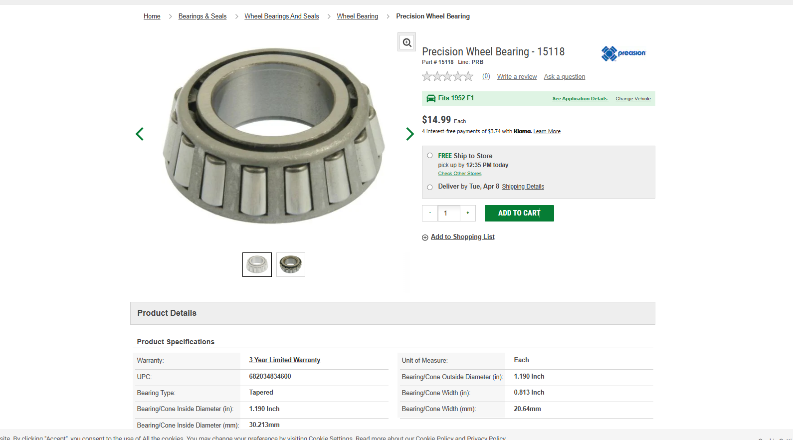

    Looking up the 52 F 1 wheel bearing for the Hubs I harvested off one I also checked the O'Reilly computability chart and That inner bearing fits Model A through 32 and then 46/48 and 48/52 F-1. They don't show a race though.
    The Ford trinket vendors don't give real part numbers and info is somewhat conflicting.
    The cup/race for a 51 F-1 inner wheel bearing is a National 15250X that is 2.5 od. I'm not finding anything on a number for a race Screenshot (812).png Screenshot (810).png for a 40 hub but no doubt someone has that in their file.

    That listing is wrong; F-1 uses a larger inner bearing and cup than early Ford due to the changes in the spindle. Check the list for '53-'56 F-100 for the correct numbers.

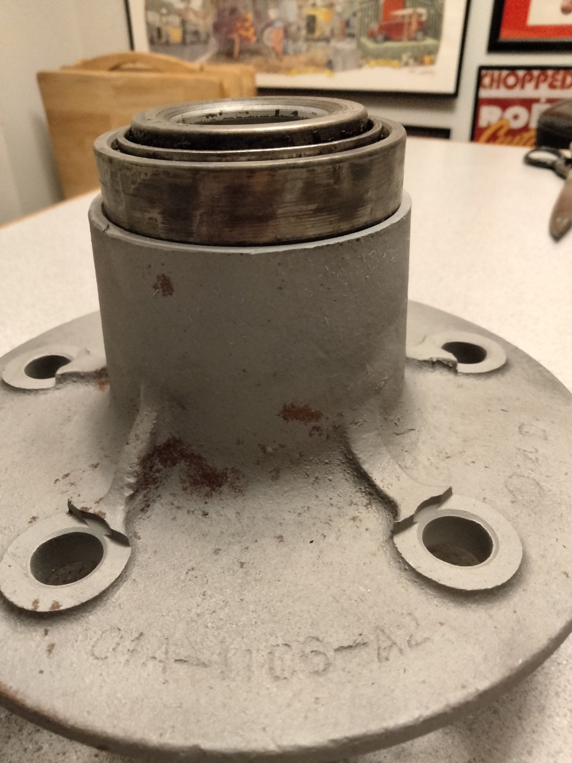

    F-1 uses a 14276 cup which is 2.717" OD & a 14130 cone which has a bore of 1.3125" (1-5/16").
    Early Ford uses a 15250X cup which is 2.50" OD & a 15118 cone which has a bore of 1.895" (1-3/16"). Cone in the picture has the Ford B-1201 p/n.
    If you match a F-1 cup to an early Ford hub it is quite evident that there is not enough metal there to bore it out for the larger cup.
    A while back I looked thru the bearing catalogs to see if I could find some way to make Early Ford hubs fit an F-1 spindle and could find a way to do so. In that case we used F-1 hubs with '40 drums and Lockheed brakes. Don't remember the specifics and I don't have a old Ford drum in my garage right now to figure it out again.
    F-1 stuff on the left and early Ford on the right.
    F-1 stuff perched on a '40 hub to show how large is in comparison to the hub. Maybe a scant 3/32-1/8" wall left if bored out to fit.
