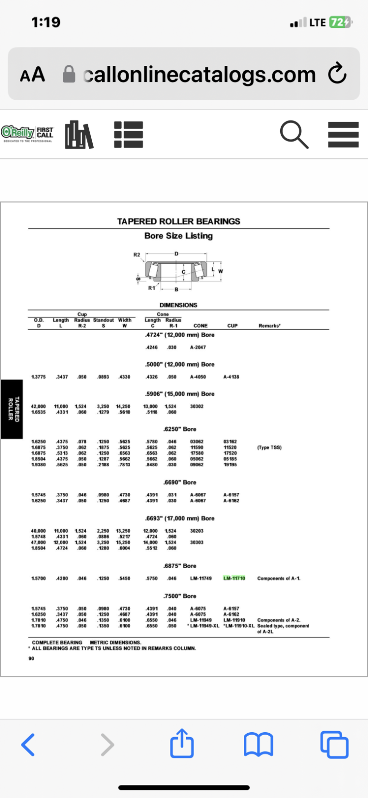

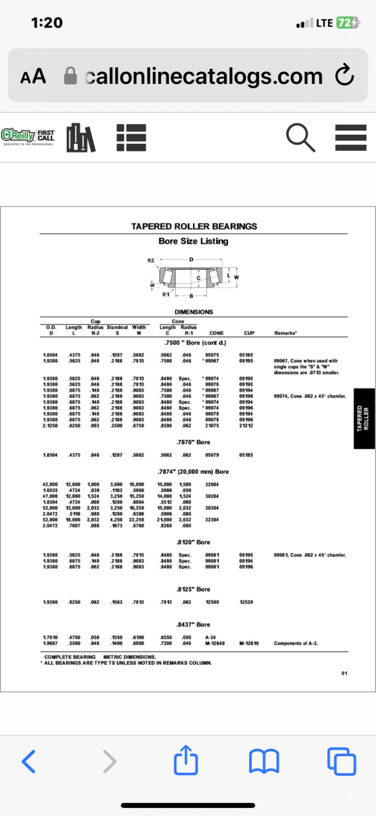

  5. Thanks John, that helped a lot.
    It’s was not easy switching pages from your link though. I’m not even sure I can remember how I did it.
    On page 40 I found the OD “D” of an A3 set. 1.9687 .
    On page 91 I found 3/4 bore with larger OD of 1.9380 and a jump to 2.215. WTF
    I need a 3/4 bore in an A3 hole.
