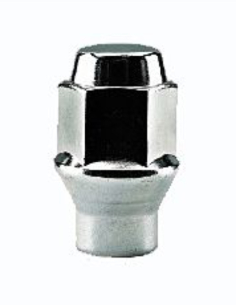

    I think those wheels need shanked nuts with a washer.
    This part is correct. With shanked wheel nuts (and tapered too) it is a real good idea to use hub-centric rings.

    I am sure that this is the type of wheel nut that twenty8 is talking about.

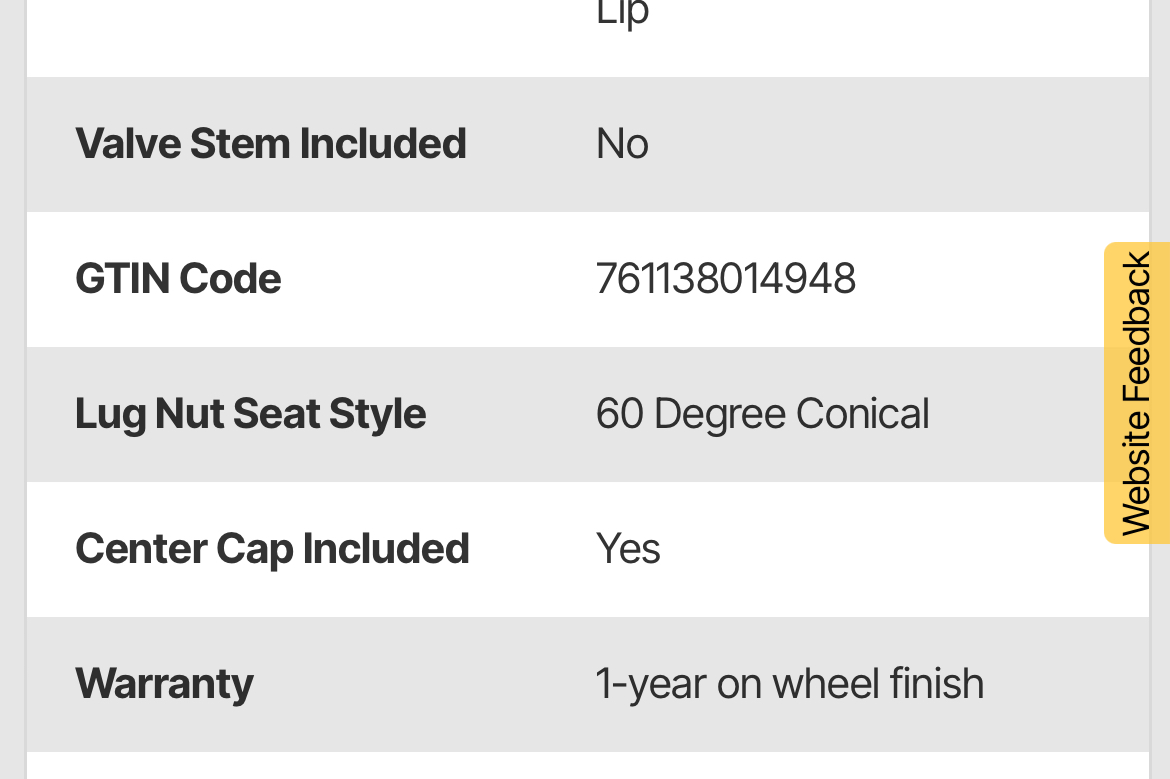

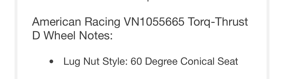

  9. Both Jegs and speedway list a 60* conical seat lug nut for TQD

  11. From jegs
    They’re either correct or a source for the confusion

    Info I am seeing says that 60 degree conical is correct for the currently produced and sold wheels, but not the older ones.

    As Zuffen pointed out there's a taper for the nuts and as Anthony showed, Speedway and Jegs say it's a 60° conical seat.
