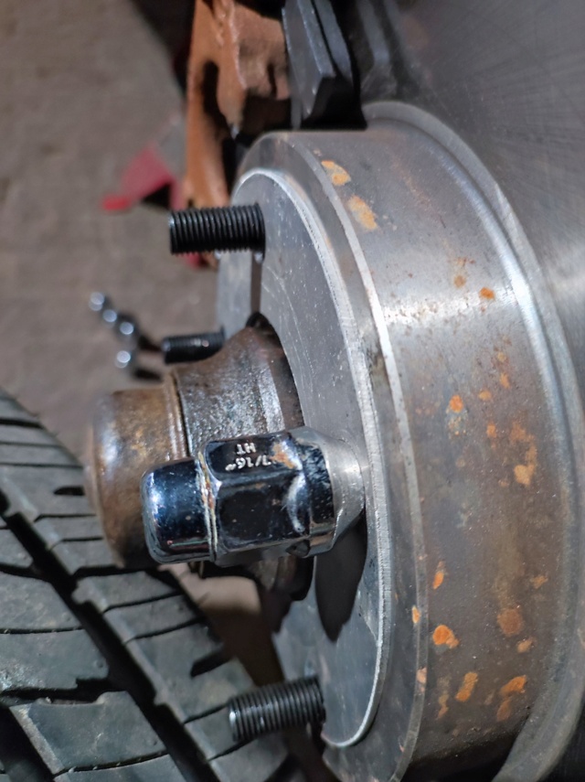

    That lug nut only works on a steel wheel or one with a steel insert pressed into it. 7 16 chrome lug nut.jpg

    Any aluminum wheel can have the appearance of tapered, If the tapered lugnuts are ran in enough times...
  3. Looking closely at your pics, it looks to me like the wheel bolt pattern on the rotor hub is slightly mis-drilled judging how the wheel studs aren't centered in the spacer holes. Easy enough to check, install the wheel with just two lug nuts (just hand tight) next to each other, then look at how the other three look in their respective holes. If they're not centered EXACTLY in their hole (offset by any visible amount), that's the problem.
    You've got all the right parts, the only variable is the rotor hub. You don't need the hubcentric spacers, just a new rotor drilled correctly..
    05snopro440 likes this.

    It could be the 2mm spacer plate that is not drilled accurately, which shouldn't matter.
    In retrospect, it could be the use of spacers that is causing the problem. There is a lot of opinion not to use them as they can cause wheels to come loose. Ok, let's consider a new box of frogs open. Not all will agree.
    I'm sticking with 60* conical nuts being wrong.........

    I just zoomed in up real close on the wheel nut in this pic. Is the tapered face fouled with alloy from the wheel???
    This could be a sign that tapered nuts have been wrongly used in shank style holes.

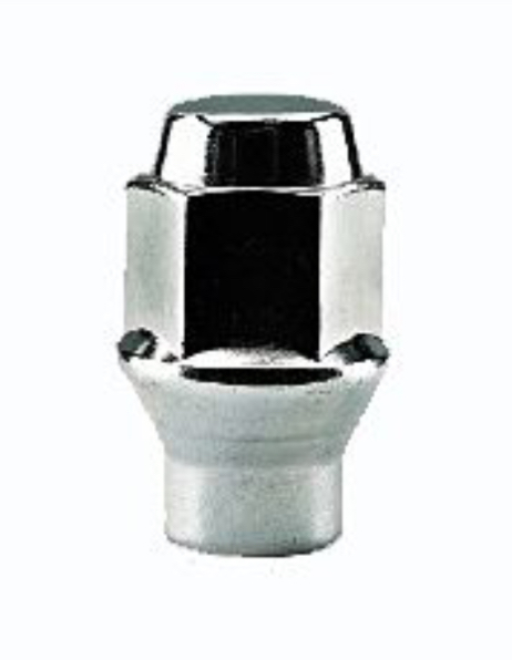

    These made by Gorilla. A must for the new style conical style thick aluminum wheels…..should be mandatory. I have them on my newer American Torque Thrusts….
    I like the older shank nut with 1/4” thick washers but wheels aren’t made for them today!

  10. Possible mis-drilled spacer, but again, easy to check. Trying it on the other side may tell the tale. I've used spacers a number of times with no issues. The OP is having trouble with only the one wheel, and the rotor is the only real variable. The only other thing that comes to mind is the wheel mounting surfaces aren't flat; one or the other may be slightly convex, although this should have shown up on the drum brakes if it's the wheel.
    GlassThamesDoug likes this.

    I don't see what the spacer has to do with anything. The wheel will sit against it just like it would on the hub. Providing you're using the right lug nuts and the studs/lugnuts aren't offshore ****.

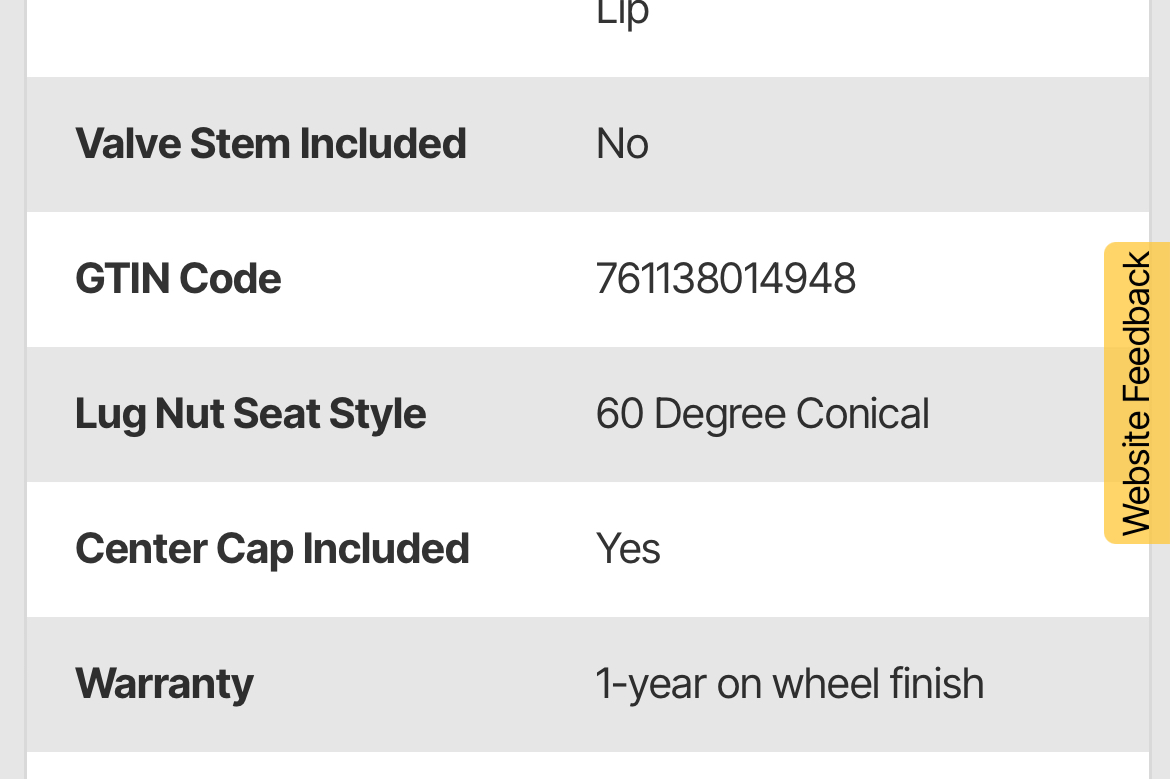

    The front disc kit is from Clark's Corvair, they are slip on, the flange on the disc is thicker than on the drums which is why I had to swap the studs for those wheels. I had to skim the outer edge of the hub on the lathe for the rotor to fit over as per Clark's instructions.
    The press in studs in 7/16-20 I used are the longest I could find, the hubs are originals, I had to redrill the hubs for that, I even bought the correct size drill bit for this and did it on the drill press. Not the first time I did this kind of mod.
    You guys are right the tapers on the wheels are really skinny, I thought it was strange, then again when you look at the infos provided by Jegs and Speedway they states 60° tapered lug nuts.
    I made the spacers using a legit spacer for this bolt circle as template because I couldn't find any so thin, at least in Europe. Anything commercially available was too thick and would have been a problem for the studs length and probably have the tires rubbing the fenders while turning.
    As recommended I will contact ARE with the wheel number to see what they have to say.
    It sure does look like galling on the nut in the picture.
    Last thing is when I look up 0.62" diameter shank lug nuts on Summit site, only 60° shank style come up, not a single one with washers.

    These lugs may solve your problem https://www.ebay.com/itm/311157459337
    I did not notice the price, there are cheaper ones out there. Trans Am /Camaro the built in washer centers the wheel.

    Look again at the very first picture posted, that wheel clearly takes a flanged nut, so stop confusing the guy and let him just go get the right nuts, Period

    A Shank Style lug nut is also called "Mag Seat" and generally uses a washer. It has an extended shank that fits into the hole on the wheel. The depth and diameter of the shank vary.

  25. Yeah, that is the question. And they were apparently fine when bolted to the drum brakes. FWIW, I have an older set of TTs like the OP and my stud holes are machined just like his... and has had those conical nuts fitted for 15 years with no issues. That's also pretty typical on OEM alloy wheels which use conical nuts, which is probably where the design came from. And seeing how the rotors are slip-on, that should rule out bolt pattern issues.
    So that leaves the changes made, rotor and studs. I'd really like to see a pic of both sides of the hubs, but what I'd look at is this...
    Wheel studs. Two things I'd look for here. One, does the knurl on the stud stick out beyond the hub mounting surface? That could prevent the rotor from fully seating, you would have to countersink the rotor holes. Two, are the studs fully seated in the hub? Hubs are usually spot-faced for the stud flange to fully seat, if the new stud has a larger flange it may not be seated all the way.
    Rotor. Check to make sure both inside/outside mounting faces on the rotor are flat. If either one is even slightly convex, that could do it. May not hurt to check the hub too. Every once in a while you can get a 'tolerance stack' that can cause issues.
    Recommended torque on these is 75-85 ft-lbs.
