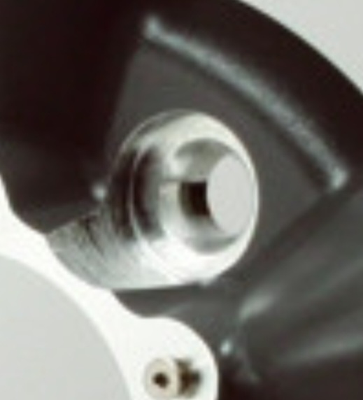

    After looking close, it appears you need the flanged washer type lug nuts! Someone at some time put the angke lug nuts on a making what appears to be a mating surface, but I think it is just because it’s soft aluminum!

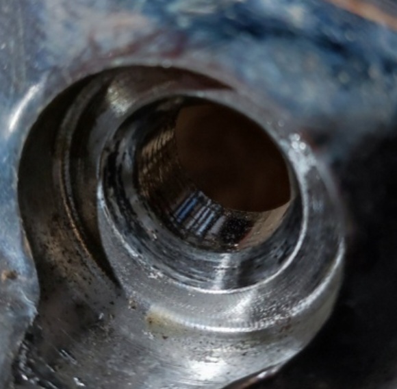

    By the look of the galling on the nut shown, they may have just been over-tightened until they stayed on.

    My set of Americans used the shanked ones shown here. Shop called them ET style lugs.
    anthony myrick likes this.

    That’s why they all changed to conical nuts. In the beginning the washers were all 1/4” thick. As more manufacturers made wheels the washers got thinner. I expect that unknowing individuals mixed wrong parts and wheels fell off/got loose causing lawsuits….

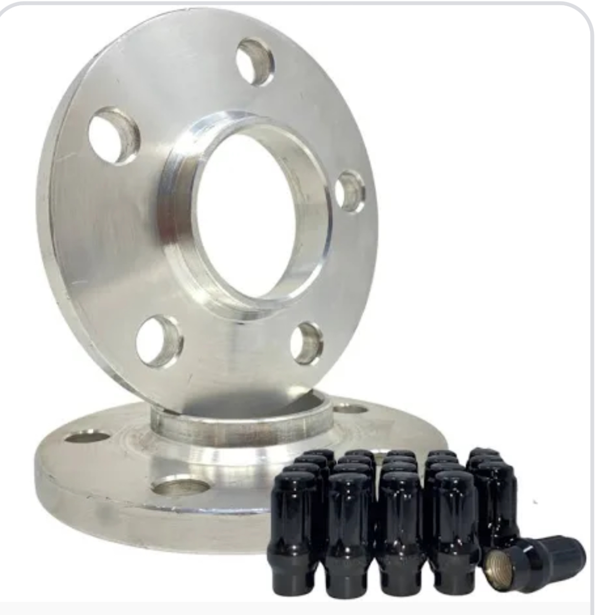

  25. Hub centric spacers
    BJR and twenty8 like this.

    Clydesdale
    You wont find Hub-centric spacers in less than 10mm thickness though, at least no where near the thickness of the current 'shim'.
    Now there's a thought, at what point does a shim become a spacer?

  28. twenty8
    Joined: Apr 8, 2021
    Posts: 4,224
    twenty8
    The ones below are 3mm thick and are hub-centric. I couldn't find any 2mm with a quick search.
  29. Clydesdale
    Joined: Jun 22, 2021
    Posts: 673
    Clydesdale
    wow I stand corrected, never seen then them that thin before.
    My comment on the spacer was that if the ID matched the spigot ring then it would be centrally located, with a 2mm spacer there should still be enough register on the spigot ring to fit the ID of the the wheel

    The hole configuration in your two photos above are identical. The taper on OP's wheel is obvious when you look at he smaller bore of the hole compared to the recess inner diameter.
    Agreed, the spacer makes no difference. I've been running a 1/4" spacer on the front of my S10 with aftermarket aluminum wheels for 24 years. They fronts came loose once, they had recently been reinstalled. Torqued them and they were fine again.
