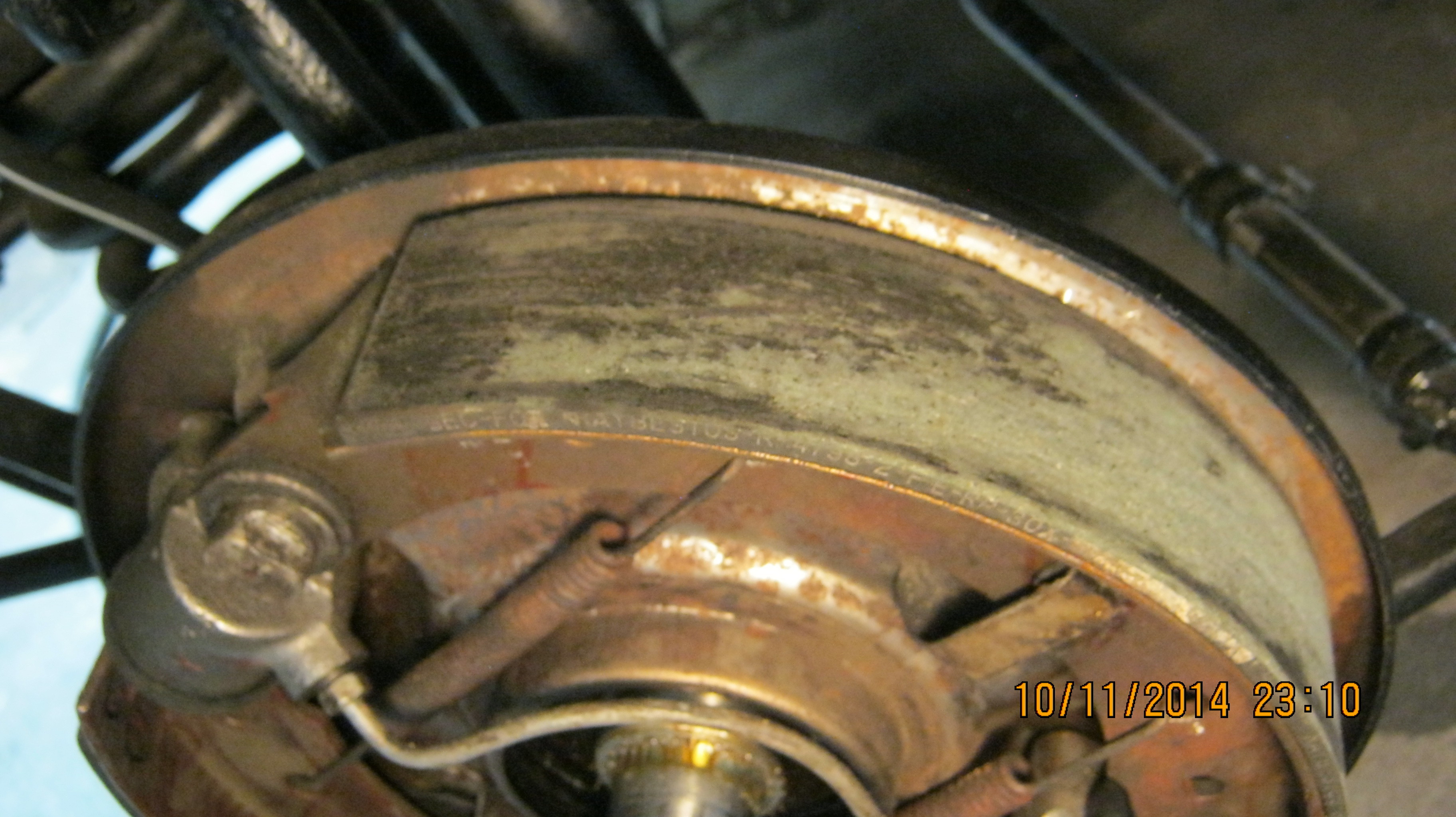

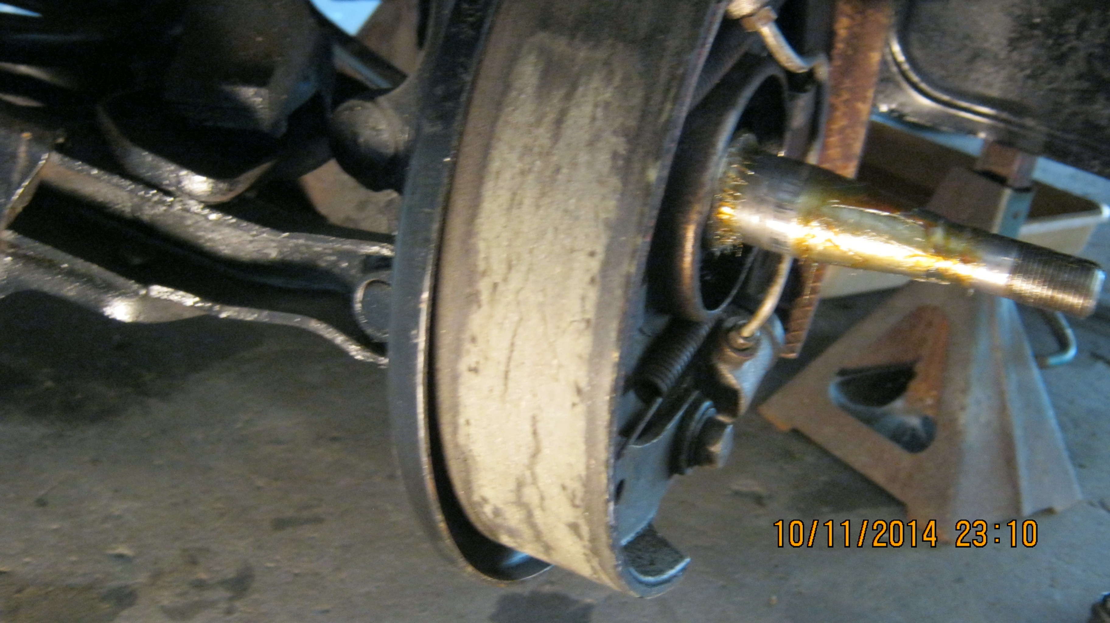

  26. dodge59
    Joined: Dec 21, 2006
    Posts: 183
    dodge59
    today I took the drums off one at a time and watched the awy the cyls are pushing out the shoes .
    some unusual movements .... like both shoes not moving outward at the same time or collasping .
    like they were stuck in the cyl bores . so we went to bleed that frt left cyl that was not shooting a nice stream of fluid yesterday and now TODAY it was fine. go figure.
    took all the cyl aparts and there was absolutely no debris in them clean as a whistle but................. with the rubber boots off and the springs behind the pistons manualy moving the piston in and out .................some them were hard to push and out like they were stuck in the bores. or a burr in them .... they should move with easy I thought. .
    any way .. so we bled the system again and the brake pedal feels real good ! doesn't go to the floor.. good height . not spongy . observed all the shoes they way they moved in and out and all seems to moving correctly now .. go figure
    I am ordering new front shoes and when they come and I will run my honer thru the cyl bores and cleand them up.. these must be jap parts. ..
    see pic >>>>>>>>>>>>>>>>>>>>>>>>>>>>>>>these are the shoes after driving it around the block yesterday .. all the oil came to the surfaces. again .
    where would you guys buy the shoes from ? Thanks !
