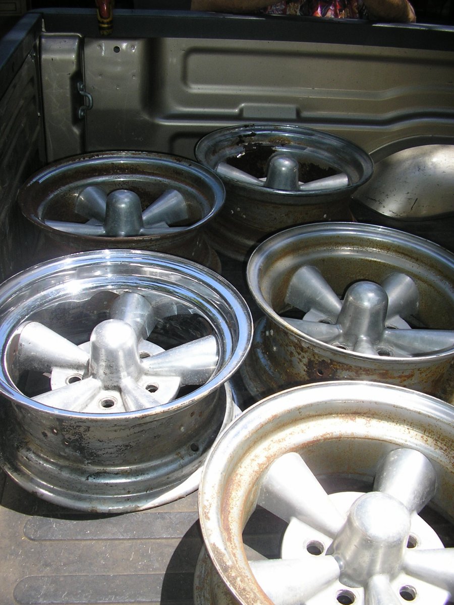

    5 spoke Morbec Master Mags which are dead on 12" diameter. I realise most after market hoops are 12 ⅝" i.d. but am hoping someone can tell me if there are any older 15"steel wheels I could use the rim/shell/hoop from. morbec master mags 003.jpg

    They're 14" rims. The few 15" wheels that were made used the same centers. Have just emailed Marsh so we'll see. Thanks for your help and input.

    The normal size for 14" centers is 12.260". You should be able to find a 15" rim with a 12.260" ID pretty easily. 12" ID was only used on a few aftermarket 14" wheels from the 1930s and then rarely and some 14" mopar wheels in the 60s. Are you sure your centers aren't 12 1/4"?
