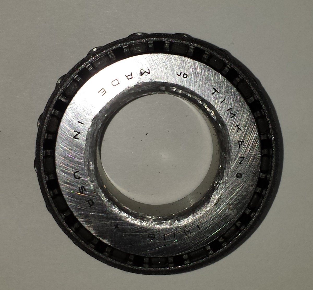

    A 14116 bearing will fit the F-1 bearing race and the '40 Ford style spindle. You should grind a radius on the inner edge of the bearing to seat properly on the spindle.

  9. LKPar1270
    Joined: Oct 31, 2008
    Posts: 89
    LKPar1270
    Thanks for the bearing info, gonna see if there's a pair of them in this town this morning
