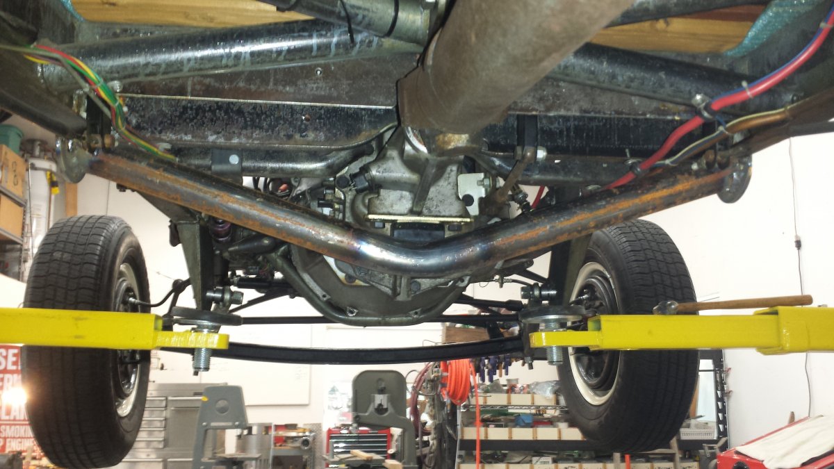

    Roadside, everything on your list has been replaced or checked in the last couple of weeks. Axel was changed out with a verified good one with new 40 Ford style spindles. Runout was checked on the brake drums and was within specs. New kingpins were installed with the axel and new spindles. Tie rod and steering arm joints are all tight. Here's a picture of the front end, after axel and spindle upgrade but before I put the shocks back on. 20191105_074609.jpeg

  25. can you put a couple pictures of the frame, front suspension, radius rods, close-ups, side, etc.
    I see you have really deep drop radius rod mounts. is there any possibility that they are flexing? i am not a fan of the really deep drop mounts
