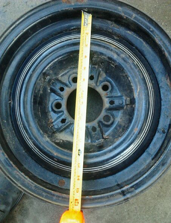

    this is the picture of a wheel. I have three of them.

  12. The pin striping tells me they're 49-50 chevy passenger car wheels. I don't think 51-up wheels had pinstriping from the factory but of course you could pinstripe any wheel. Will fit any drum-brake chevy from '49-up. Hubcaps will have to be older than '54 to fit these wheels tho.

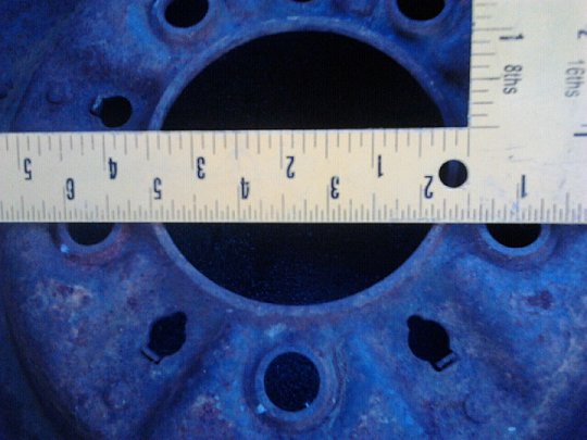

    Are you sure about the bolt pattern circle? The smaller holes between the lugs make me want to think that they are MOPAR which used lug bolts intead of nuts but they would be 4 1/2" bolt circle.

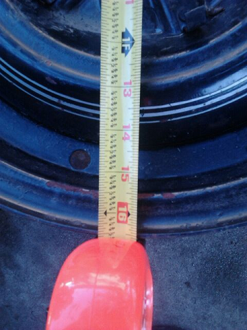

  16. You measure from bead seat to bead seat. They are most likely 15".
  17. Squablow
    Joined: Apr 26, 2005
    Posts: 18,260
    Squablow
    Measure from the center of one hole to the OUTSIDE of an opposing hole. Not center to center, that will give you an incorrect measurement.
  18. salazarich
    Joined: Feb 16, 2010
    Posts: 54
    salazarich
    I took some more measuremnets.

  19. F&J
    Joined: Apr 5, 2007
    Posts: 13,281
    F&J
    looks like a 5" bolt circle, Olds, Pontiac...must be more, like Packard...
    16" dia x 4-3/4" or maybe 5" width, from what I can see.

  22. Buick was 5x5 with 15" wheels using lug bolts through '58.
