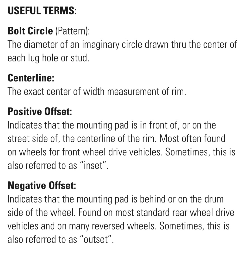

  3. Johnny Gee
    Joined: Dec 3, 2009
    Posts: 14,998
    Johnny Gee
    from Downey, Ca

  5. Moriarity
    Joined: Apr 11, 2001
    Posts: 41,121
    Moriarity
    SUPER MODERATOR
    hell maybe I have been wrong all these years.... I always thought pos offset was a reversed wheel....hmmmmm
    If you are shopping for Cragars for your 57, they made them 2 ways. standard and reversed. you will want standard offset on a 57
    427 sleeper, TRAVLR and Johnny Gee like this.

  8. Moriarity
    Posts: 41,121
    Moriarity
    SUPER MODERATOR
    thanks for straightening me out on this, I have been thinking backwards about pos and neg offsets for a long time....

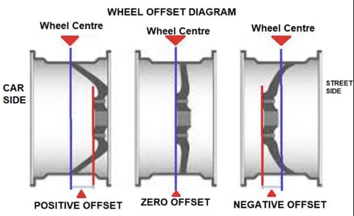

  9. evintho
    Joined: May 28, 2007
    Posts: 2,616
    evintho
    I think I got this off the TireRack website. Looks like you're right Johnny Gee!
  10. Bandit Billy
    Joined: Sep 16, 2014
    Posts: 17,207
    Bandit Billy
    Oh sorry @Moriarity, but that answer was incorrect.
    We were looking for "Reverse is a negative offset, negative offset".
    Congratulations to our reining champion @Johnny Gee.
    Thanks for playing and join us next time for another exciting round of
    HAMB trivia.

  12. Johnny Gee
    Joined: Dec 3, 2009
    Posts: 14,998
    Johnny Gee
    from Downey, Ca
    No contest here.
    This is Cragars over wording in my opinion vs the few words to say the same thing I opened this thread with. IMG_3141.jpeg
