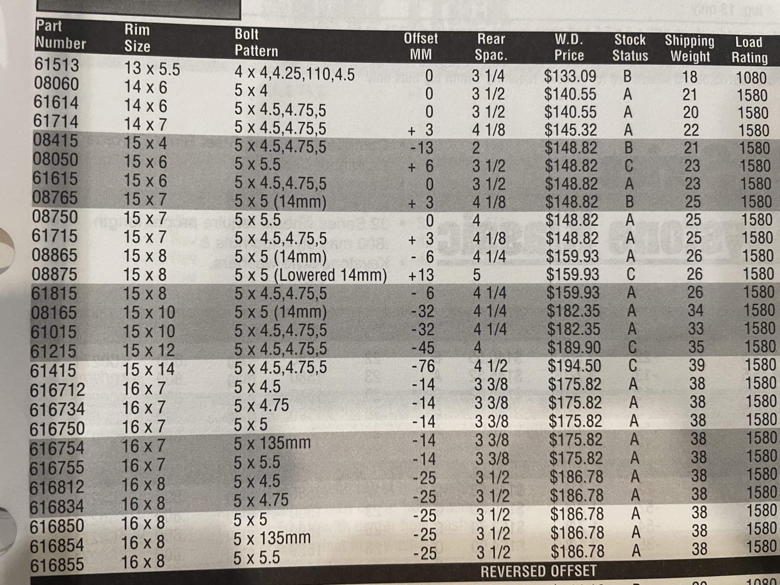

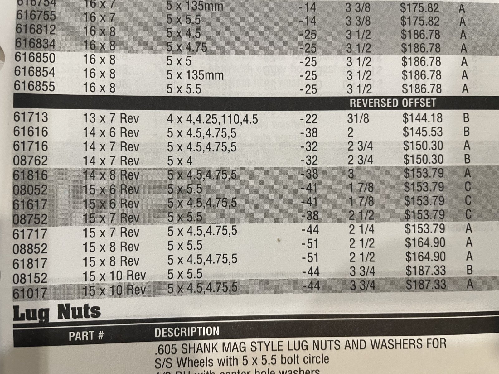

  28. Johnny Gee
    Joined: Dec 3, 2009
    Posts: 14,407
    Johnny Gee
    from Downey, Ca
    In today’s Cragar SS offerings. It’s as follows for 15 8’s.
    4” back space @ 13mm negative offset
    4 1/4” back space @ 6mm negative offset (match’s your catalog)
    4 3/4” back space @ 6mm positive offset
    All of which are non reverse wheels and a compilation of both direct fit and uni-lug.
