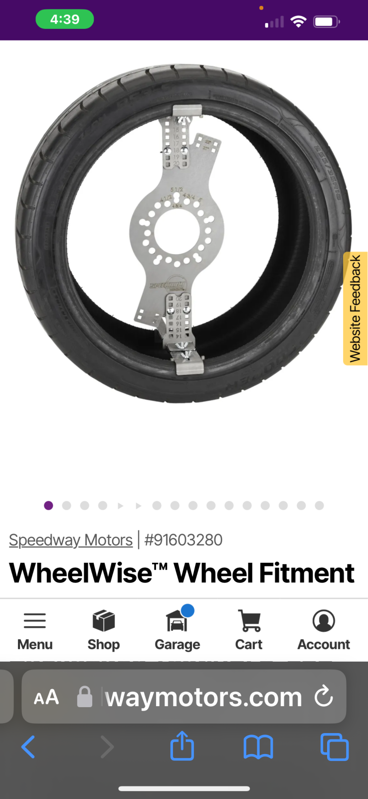

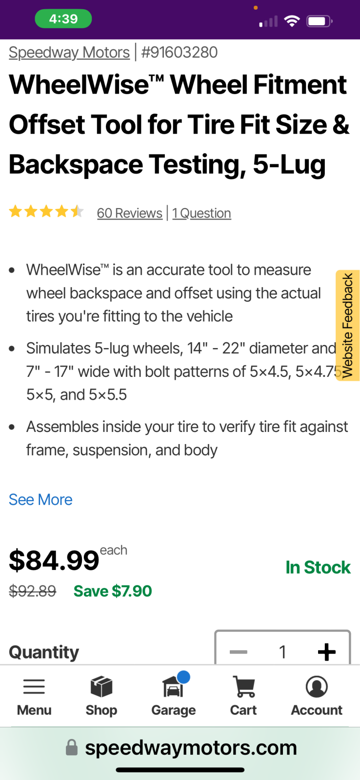

    Maybe this will help

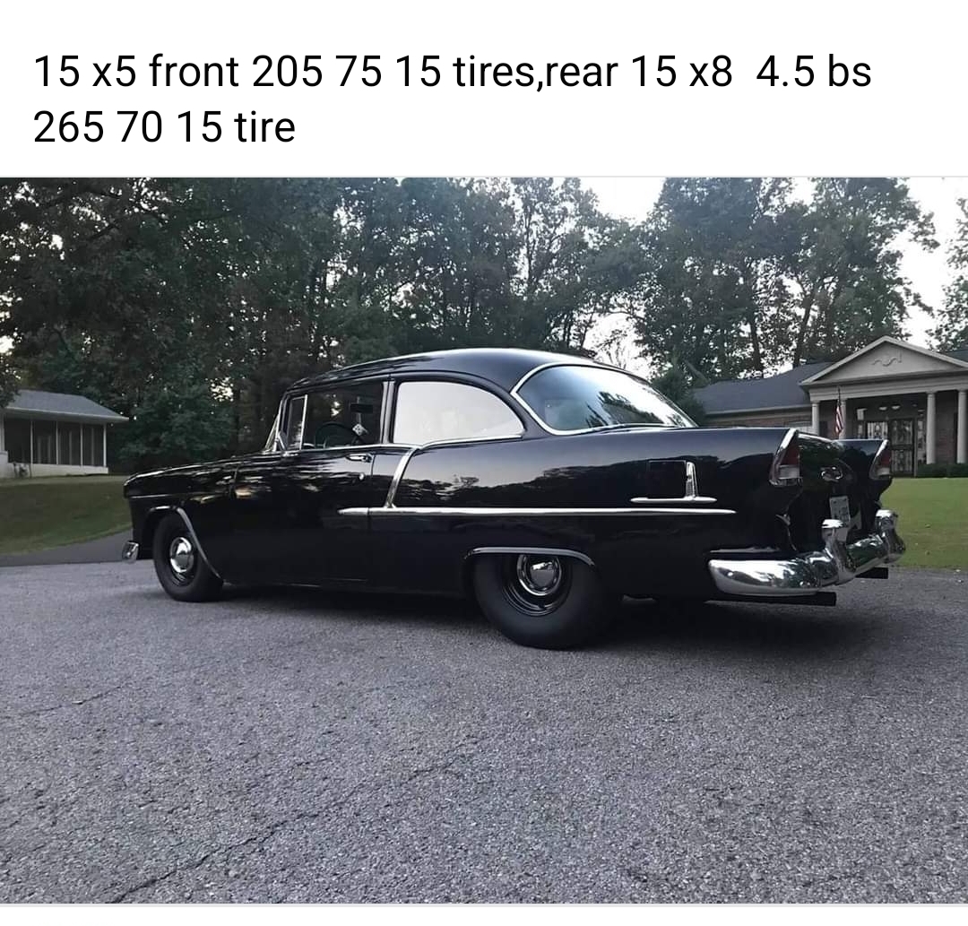

  13. DDDenny
    Posts: 22,480
    ^^^^^^^^^^THIS is all that matters!
    And this!
    Cripes, I love this thing!
    swade41, guthriesmith, TRAVLR and 2 others like this.
  14. 05snopro440
    Joined: Mar 15, 2011
    Posts: 3,020
    05snopro440
    Agreed, the stance and wheel/tire combo hit it out of the park on that car.
    lothiandon1940 and Johnny Gee like this.

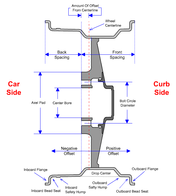

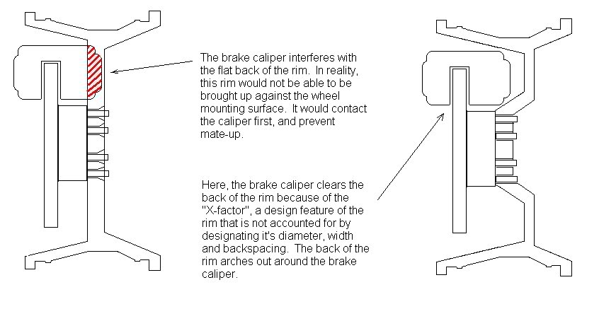

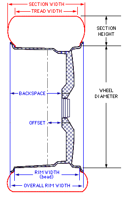

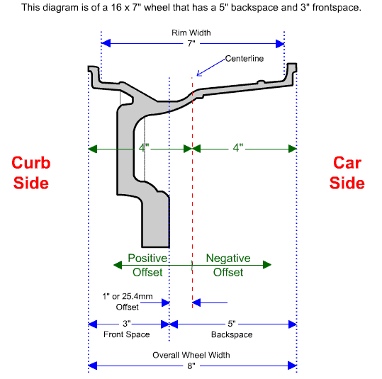

  25. Here's more for the pig plie from my secret digital stash.........
    wheel backspace.jpg backspace
    wheel positive offset.gif positive offset wheel
    wheel_diagram.gif negative offset wheel
    WheelsFAQ-diagram.gif positive offset
    Johnny Gee likes this.

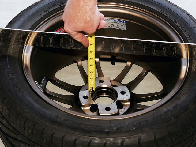

  27. Not the best photo.......
    But that is how it's done when the tire is mounted and the tire bulges. You have to measure the gross depth and subtract the fraction between the bulge top and the rim if you take a photo with a stick that's longer than the rim cir***ference.
    I should have posted a warning that the photo has math in it. Sorry.
