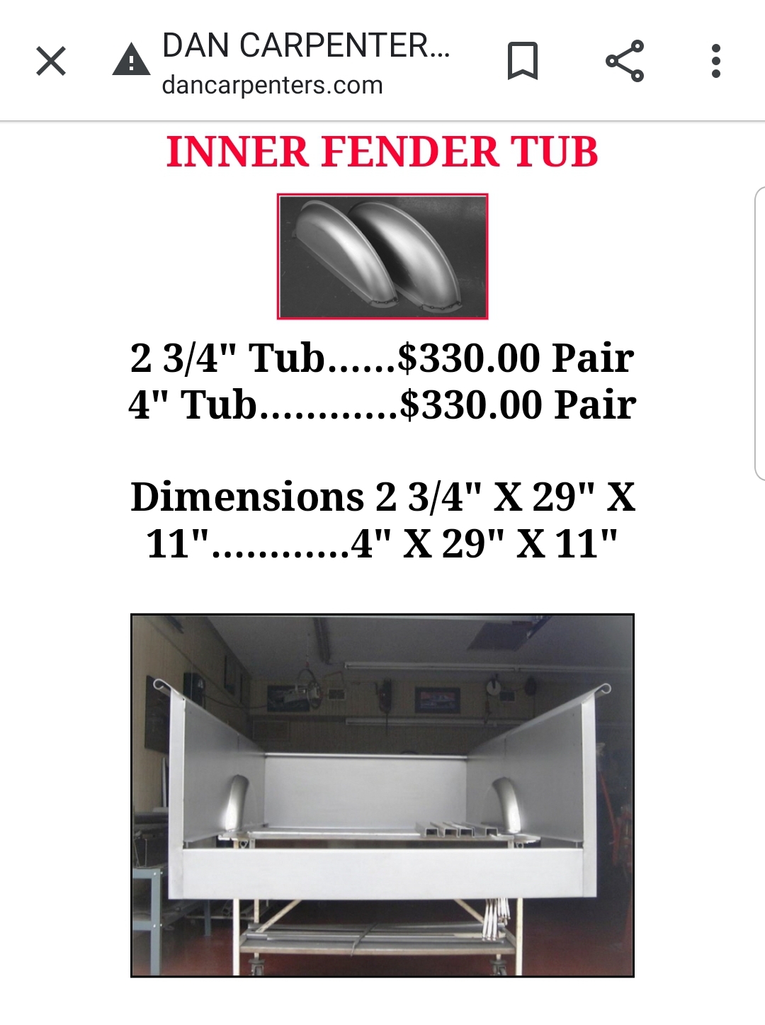

    I'd like a little more rubber and have bought Carpenter's tub so I might have to go to a custom offset.
