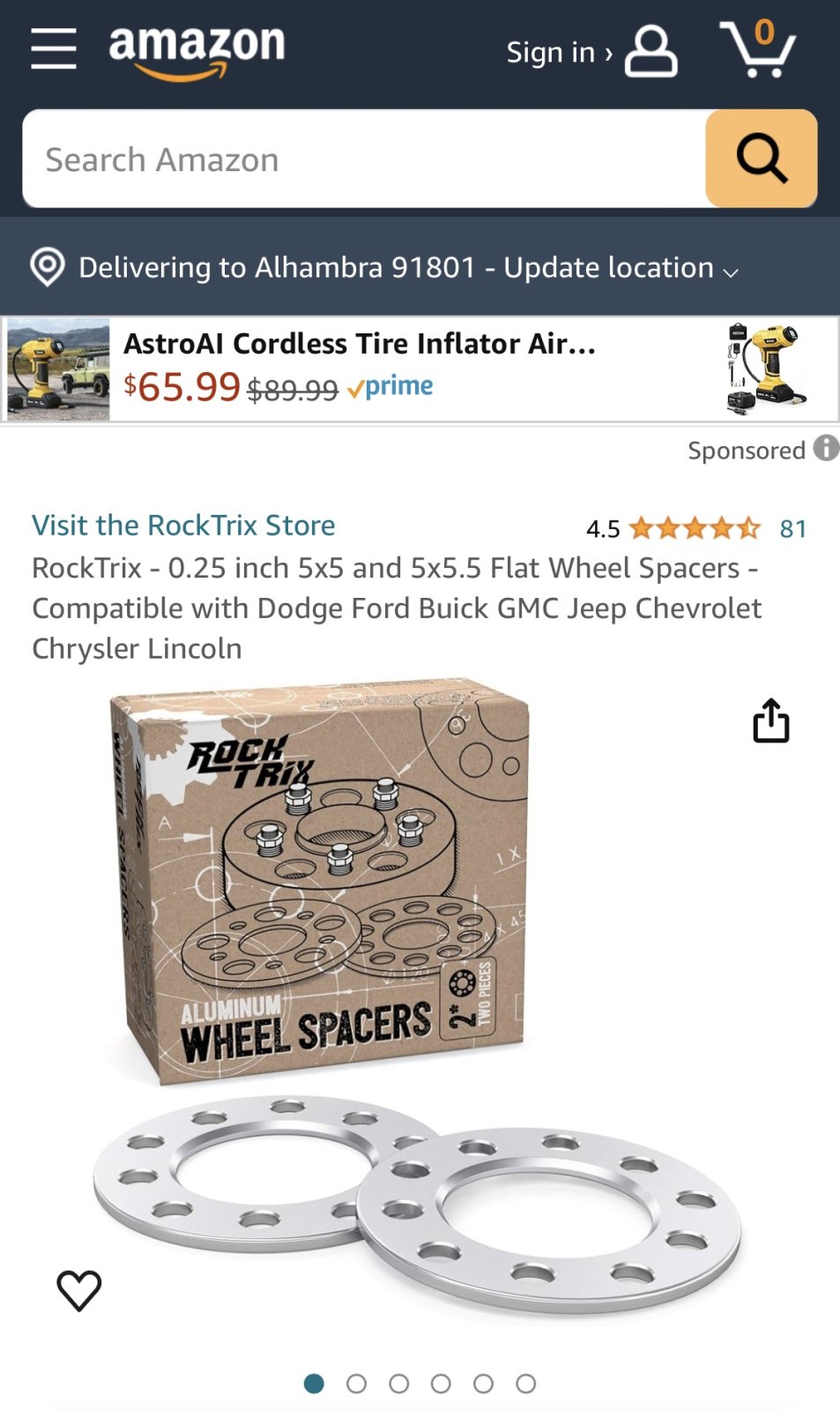

    does anyone make a wheel spacer for a 5 on 5.5 bolt circle? Or have some for sale?
    I've seen them for 4.5, 4.75, 5 but none for 5 on 5.5.
    Need something around 1/4' to 3/8"

    Rock Trix lists them on Amazon. 1/2” thick. I would look at 4 Wheeler suppliers as 5 on 5-1/2 is the standard for Jeeps.

    ^^^^^ Also showing 1/4” thick. But will the extra holes be an issue with wheels seating properly? IMG_2472.jpeg

    I had such a spacer. It had both 5 on 5 1/2" and 6 on 5 1/2" bolt patterns.
