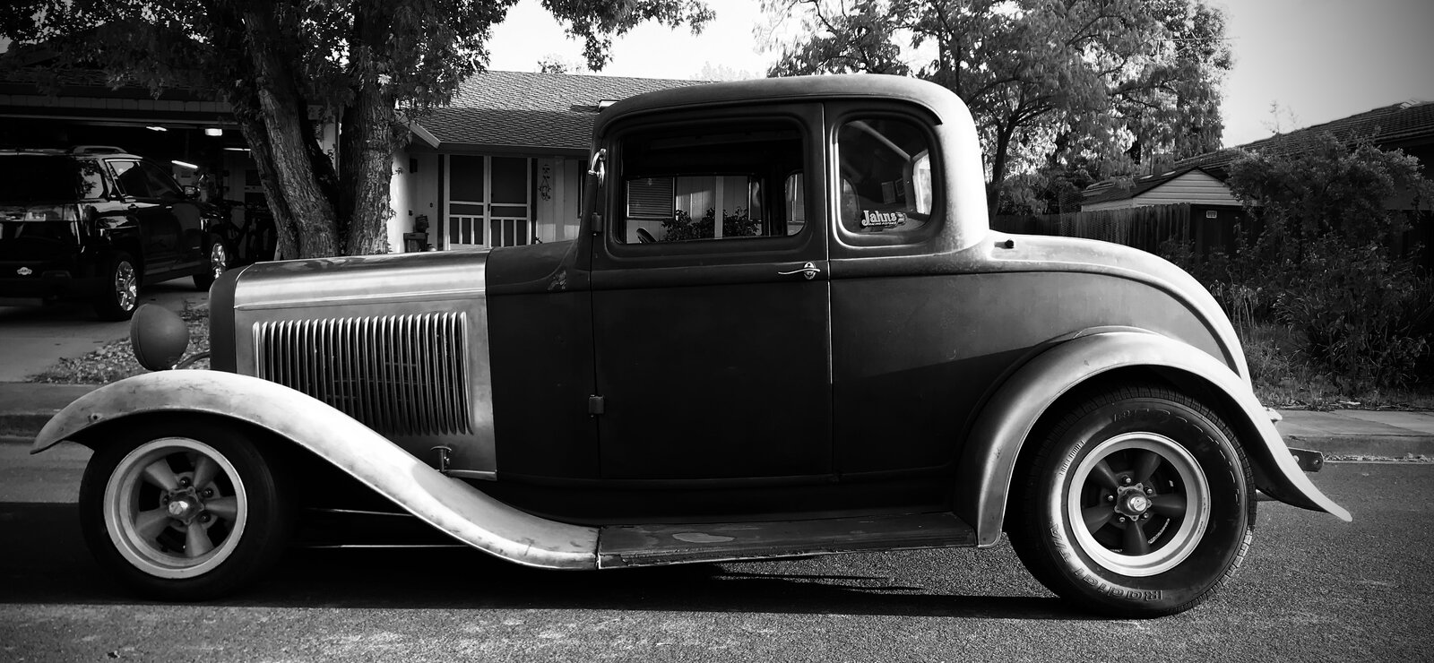

  2. hawkerdriver
    Joined: Feb 26, 2006
    Posts: 382
    hawkerdriver
    Here’s the current setup- American racing 5 spoke with radials
  3. Hnstray
    Joined: Aug 23, 2009
    Posts: 12,356
    Hnstray
    from Quincy, IL
    @hawkerdriver
    Nice looking car. One item I would suggest you consider is moving the rear wheel/tire inward to fit within the fender. That very possibly will require a narrower rear axle as the rear wheel does not appear to be deep offset.
    Beyond that, the Sombrero (Cadillac ? or ) wheel covers should be acquired before you select the wheels as the wheel contours (and diameter) are very important to the cover fitment. Tires are another issue entirely. Whether you are good with radials or must have bias ply will have a bearing on tire size/diameter/width.
    The exception to picking the wheel cover first would be if you decide tire size and construction have a higher priority than the wheel cover style/appearance.
    Some compromise may be in order to get the best combination for overall appearance.
    Ray

  5. hawkerdriver
    Posts: 382
    hawkerdriver
    Yeah changing the rear end is definitely on the list. Its an Olds rear end that was put in the car back in ‘60 and it does quite fit the car.
    Thinking of a Currie or even a quick change. Mostly I’m looking for tire/ wheel ideas. I’m somewhat retarded when it comes to that part of the car. I do like the setup with hubcaps and white walls. Not a huge fan of wire wheels. I’m open to suggestions and pics of other cars and what they’ve got

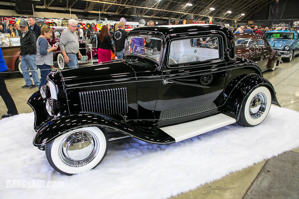

  16. Just Gary
    Joined: Oct 9, 2002
    Posts: 5,917
    Just Gary
    Somewhere there's a picture of a fuschia/lavander/orchid colored '32 Ford coupe with pinstriped Moon discs that you'd LOVE. Maybe someone else can find it.
    Meanwhile, here are some others with hubcaps:

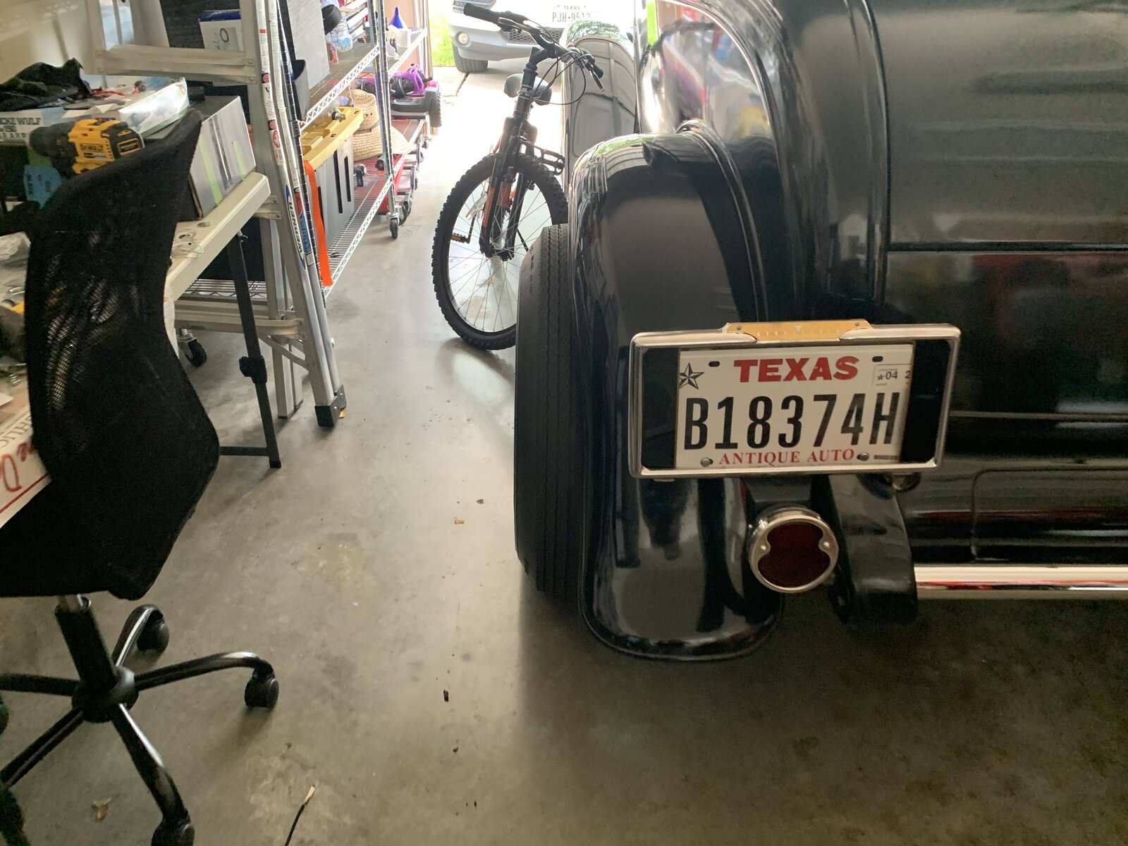

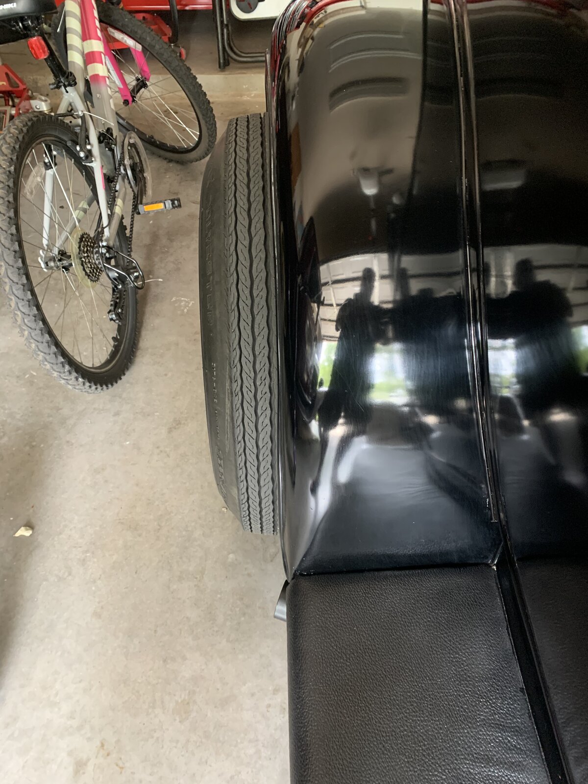

  26. hawkerdriver
    Posts: 382
    hawkerdriver
    This is what I’m dealing with rear end wise. Definitely too wide of a rear axel.
    I’ll be on the hunt for a 57 Chevy or a Currie rear end before tackling the wheel/ tire thing
    Hnstray likes this.
