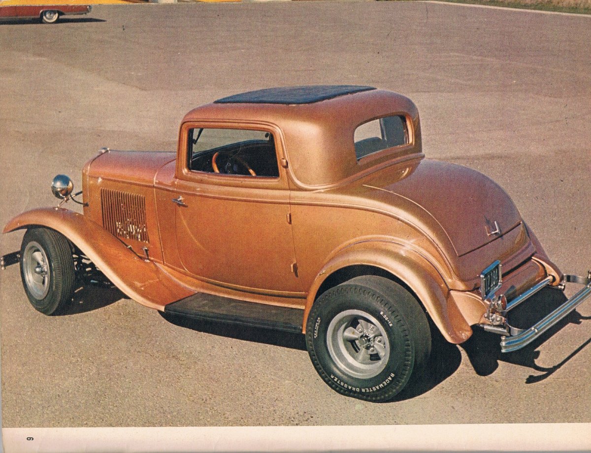

    It's your car to do with what you want, but i'm a ****er for slicks hangin' out the fenders. To me that car looks perfect and is just begging for some radir slicks.
