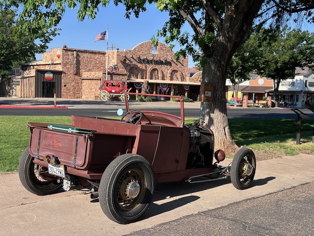

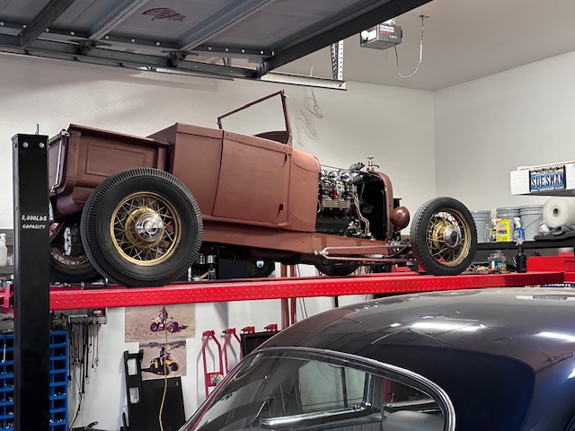

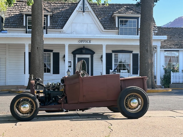

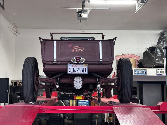

    you mean like this???? they're a ***** to mount, other than that they work fine....
    Just Gary likes this.

    what are you putting them on??? how much weight you wanna carry is a bigger issue
  12. ALLDONE
    Joined: May 16, 2023
    Posts: 4,041
    ALLDONE
    thats a pretty big tire for the front....but, don't know what car so that makes a big differance,,
    I just changed my fronts to this...
    450-17 Excelsior Blackwall Tire (universaltire.com) they're 26'' tall VS 29'' for the ones you are getting...

    Thanks-the pickup looks awesome.

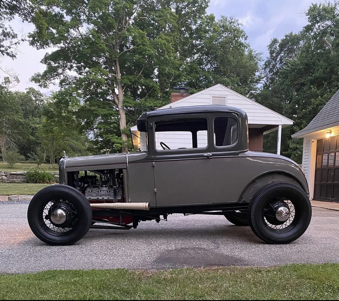

    Apparently im totally overthinking this but by the time those land in my part of the world they are like $1900- want to make sure I get it right the first time, appreciate you educating me on tires, in my field of work a 1/2” is a mile of error… or in my case a Kilometer.
    My plan is to more or less to replicate this car- I’ve been obsessed with the look of this thing.

    Those look like 18” to me, and I’d swear the rears are 7.00.
