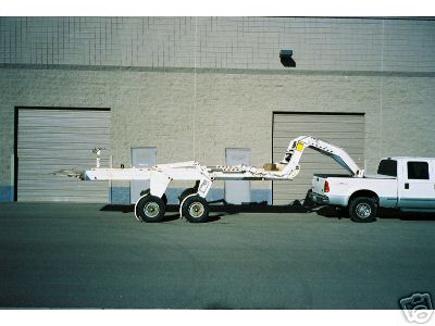

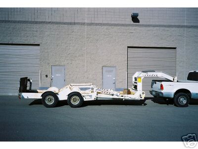

  17. I vote for front wheel drive, if you can't find a hot rod shop that can build it keep looking. If you don't need gobs of power there are tons of different choices for a drive train. I've always been intrigued by something like this trailer. (don't know much about it)
    The Stude pick-up might be too street roddy for some but it shows that front wheel drive is very do-able.

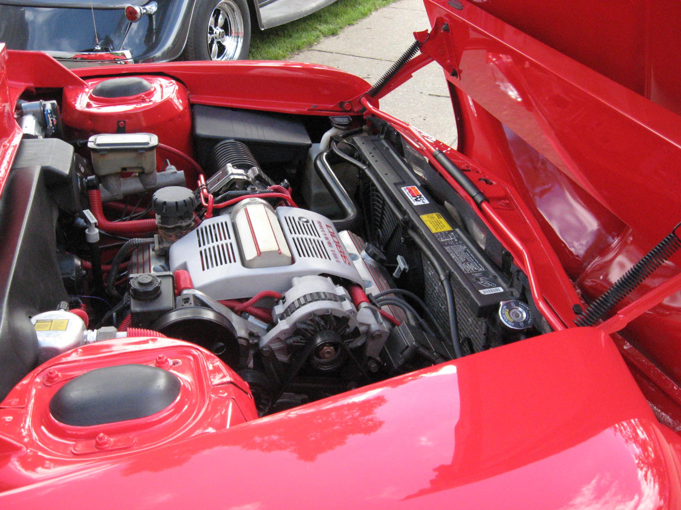

    from Nicasio Ca
    How about a Vette tranaxle and IRS? Gets the front trans out of the way and no driveshaft movement.
  22. wchamb
    Joined: Dec 13, 2013
    Posts: 28
    wchamb
    from Texas
    Sounds like it's on the ragged edge of possible to make a RWD work. Maybe.
  23. blowby
    Joined: Dec 27, 2012
    Posts: 8,663
    blowby
    from Nicasio Ca
